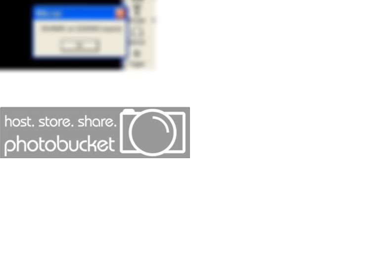

Here is a common error window I get when trying to exit FP using 294.
And another idea.
You have ipac, right?
And you had problems with nudging device producing too many nudges and tilting games.
I think that's connected - what happens here is that you press and hold exit key. That exit key is sent hundreds time per second.
On normal keyboard only key down event would produce one hotkey event.
With ipac every key press event somehow produces keydown event and you get many hot key events.
So script enters into exitscreen: section many many times over and over again.
And on beginning of exit screen section is loopval=0 command
and loopval is public so all of these exitscreens that are executing on every key press are changing the same variable
so this variable never gets to 10 which is a prerequisite to get exit321 screen
soon each of them starts creating blackscreen and pause screen in parallel, so that's why they produce the error above, and why exit321 screen doesn't work
how to solve this - same as with my fix for tiempo filtro - i will add public variable exit and set it to 1 as soon as i enter exit screen.
next exit screen will exit if exit is set to 1
i'll send you the code tomorow (only small part to insert it and test it)

That sounds promising. 294 has stabilized for me and seems better. I still get the taskbar on top and less frequently the Exit321 error on FP. Pause in FP still leaves me with a black screen and the blue Pause image. Thanks.

Here is the solution for exit321 screen. Add this:
ExitScreen:
[b]    if (Exiting = 1)
       return
   else
       Exiting = 1[/b]
   LoopVal = 0
and this:
        } else {
           [b]Exiting = 0[/b]
           if (LoopVal < 10 && useExitAsPause = "true") {
               if (systemName = "Visual Pinball")

Ok, I found where to add the code. It appears the task bar on top is fixed although I will need more test time. The exiting FP is still not working 100%. I ran into the same error message. Note that I am using nvidia drivers 260.99. I think everything works in FPLaunch with the newest nvidia drivers (266.99) but it I don't use it because that version leaves the FP backglass in the background on launch.

I hadn't added the gui destroy. I did and did not get the error message but I still had issues with exiting FP. It works occasionally then fails with different results. Perhaps more testing would reveal a pattern. At one point after a failed exit it came back to the table with a black screen and the blue Pause image but the table was active underneath. When I hit the pause button the standard FP Pause screen would come up with the FP High Scores and the table in the background with the table truly paused. Hitting Pause again would send me back to the black background with blue Pause image and an active table underneath. I am worried about you spending so much time on this as I really feel that the issue is how Nvidia's 260.99 drivers are handling the active screens. Out of 5 different driver versions 4 of them work with FP Launch but those 4 break Future Pinball because upon table load the Future Pinball backglass is in the background. Another sign that the nvida driver I am using is not quite right, the one that leaves FP backglass in front, is that when scaling my FP tables the scaling moves super slow. To stretch the table and backglass into position or move them around goes WAY slow. The scaling process is very fast and responsive on all of the other nvidia drivers. Also with the other drivers my tables out of scale meaning I have to rescale them all ... which is fine if we end up with that as I think they are the better drivers. My current driver also breaks settingsons printscreengen application but his app works with all of the other nvida drivers.
I do not know of any key delay setting for the IPAC. I have not loaded AHK Compiler on my cab and haven't been able to test the key response yet.
I have noticed an issue on my cab that could be effecting FPLaunch. It seems that if I hold in a button for say 6-10 seconds (i.e. holding the flipper to get the table status) my IPAC and Keyboard will all become unresponsive.
I have to hard boot to get my keyboard back. This was not an issue before I installed my new hardware. I am not sure what is causing it. If anyone has any ideas please chime in. It is a consistent problem. Happens every time I try and get the table status via the DMD. It never happens when using Exit321 though and Exit321 works perfect for VP on my cab.
Any thoughts I trying to add code to force FP backglass to be in the front? If that would be possible I could switch to the newer nvidia driver and FPLaunch will be working great.
Thanks for all your work on this!

   [/b][b]WinWaitActive, ahk_class FuturePinballOpenGLSecondary,,2
[/b][b]    WinActivate, ahk_class FuturePinballOpenGL
[/b]   Process, WaitClose, Future Pinball.exe
;**********************************VISUAL PINBALL***********************************
else if (systemName = "Visual Pinball" && (executable = "VPinball.exe"))
It waits for up to 10 seconds for second screen, if it appears it activates it. if not nothing.
it has to be time limited cause some tables might not have second screen.
if some table loads more then 10 seconds try to increase 10

this script catches only messages
Please...
Game Info...
Notice...
other messages are not covered, but can be added
you don't have cab pinmame?
Edited by blur
Please...
Game Info...
Notice...
Thats the error. Can you add support in the script to eliminate this box?
