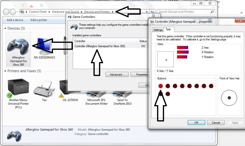

32assassin Posted March 11, 2019 Posted March 11, 2019 7 hours ago, AnimalUK said: I've setup the iPac with the 'standard' Mame buttons for each player (L-CTRL for one button, L-ALT etc). I can move up and down on the wheel but none of the buttons seem to work like they should when in different games/emulators.I if you set your Ipac to work as a keyboard, using L-CTRL or L-ALT, you will NOT!!!!! be able to use Joy2key or Xpadder both of those programs need joystick controllers in order for them to work. if you go to your device manager you will need to find this the hole point of Joy2key and Xpadder is to map keyboard keys to joystick buttons, What is the point of using Joy2key or Xpadder when your Ipac (keyboard encoder) is already mapped to keyboard keys
