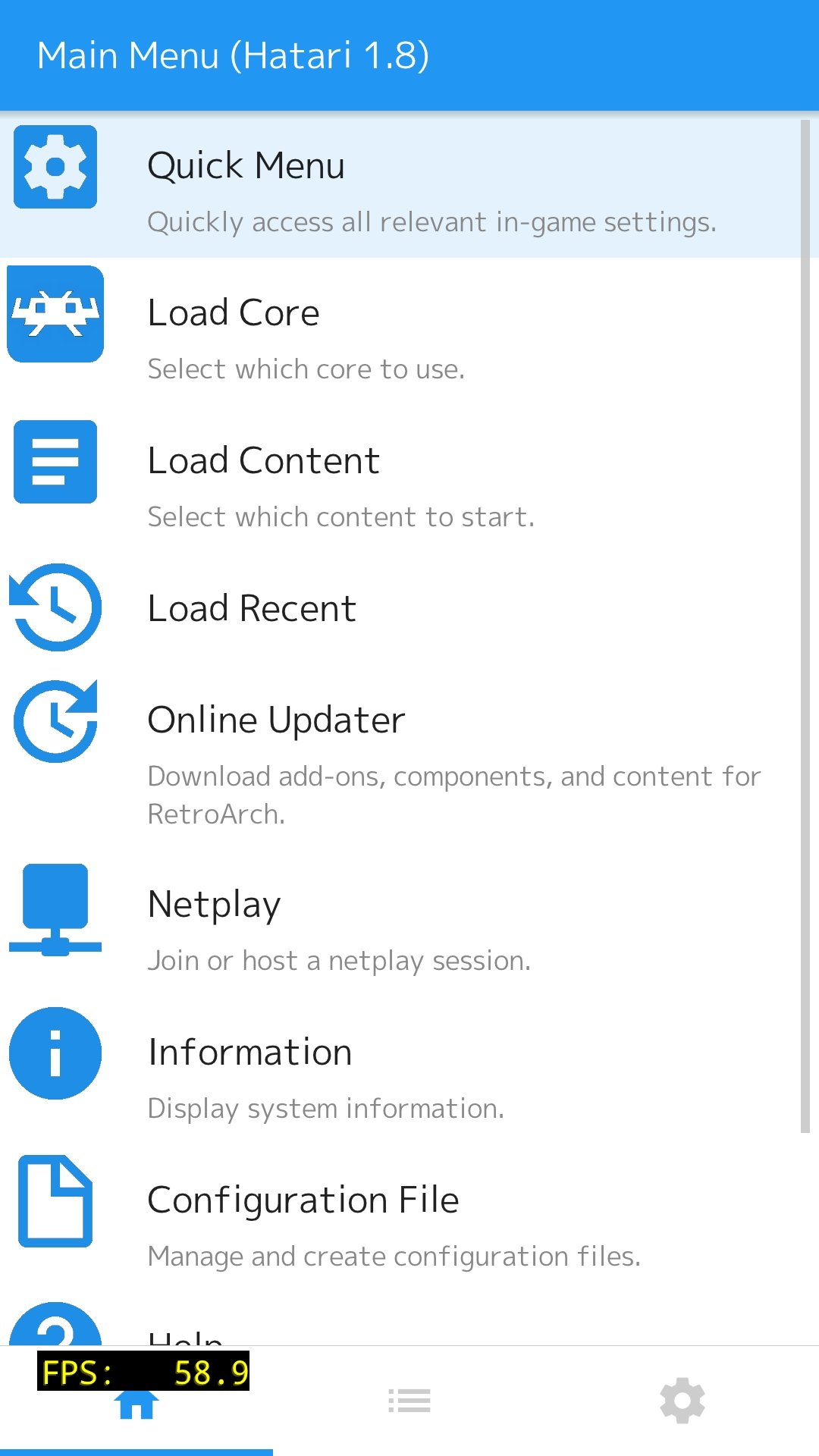

thatman84 Posted May 2, 2019 Author Posted May 2, 2019 I cant confirm it works yet but it looks like it may work(on my phone) Super tired right now. Wit *.so files not zip Grabbed a Hatari core from user Brent in RA forums some time ago and from the online updater tonight. Used the Install or Restore option on brents core and went to load core. It showed hatari_libretro_android.so I deleted this core in Information-Core Information, remove from disk option. Downloaded Hatari core from online updater and proceeded to swap between the 2 by deleting and re installing each time Online updater core with build number Custom installed core You can see both show the correct "friendly" core name. I expect this is left over from installing the core from the buildbot. Hyperspin 2.0 Latest Download Hyperspin 2.0 Documentation -------Pre Hyperspin 2.0 Below---------- HS Android Overview & Install HS Android Base Pack Download My Tutorials
Honosuseri Posted May 2, 2019 Posted May 2, 2019 OK, I'll now rephrase it. This doesn't work on the Google play version of Retroarch. There is no install core option, only a download core option under load core. I uninstalled the play store version of RA64, as I don't really use it. Downloaded the apk instead from their website. NOW I have the install core option. The hatari core has apparently installed but when loaded it says no core. Possibly because it's meant for the 32bit version? If someone can supply the Daphne beta core, I'll have the incentive to tinker with my 32bit version of RA and confirm if it works. "There is so much more and beckons me. To look through to these, infinite possibilities..."
