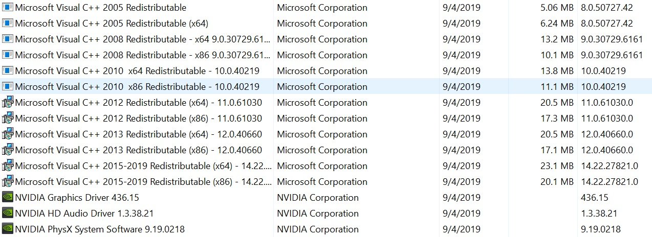

Aorin Posted September 4, 2019 Posted September 4, 2019 6 hours ago, Honosuseri said: Why do you think I have AMD? Rig is Intel i7 2600K a GTX 960. No special settings unless there's something in the HyperTheme folder config file. Simple wheel creator I did tinker in the compatibility tab though. OK, it was the other guy with the AMD CPU, I`ll update the 1903 frameworks so we can check which ones you have and maybe find the culprit. Thanks again. Aorin

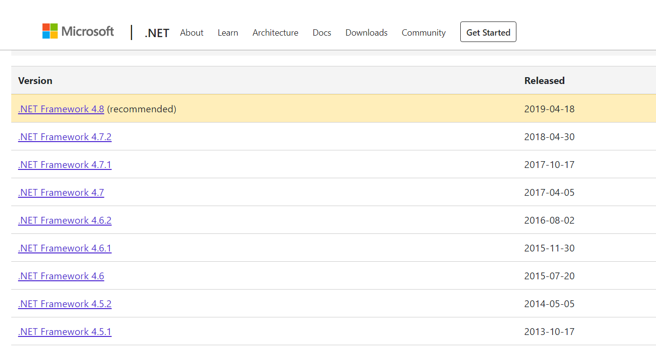

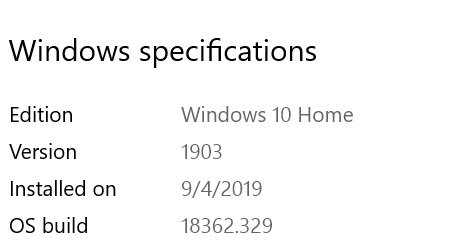

Aorin Posted September 4, 2019 Posted September 4, 2019 13 hours ago, Honosuseri said: ***EDIT*** Maybe the .NET frameworks and visual C++ have something to do with it. I might have stuff installed you guys don't Still no luck here, I checked and downloaded all NetFramework and VC Redists I could find, even x86 versions. I believe this very same Windows 10 Home build was mentioned earlier as working for Hypertheme. Aorin
Honosuseri Posted September 4, 2019 Posted September 4, 2019 We're build .295 yours is showing .329 "There is so much more and beckons me. To look through to these, infinite possibilities..."
