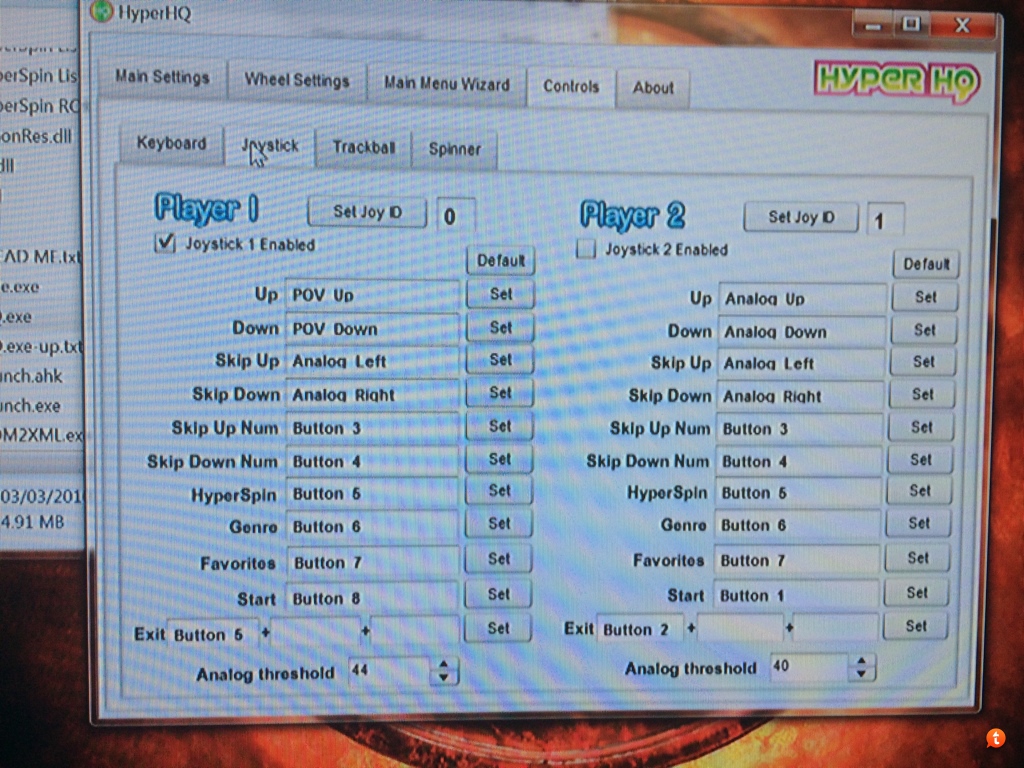

monkeychunkuk Posted June 13, 2014 Posted June 13, 2014 Hi just picked up a wired controller to To act as ipac, I can set it up fine in mame Etc but I can't seen to get it to map to select up and down on the main menu and select or exit The HQ setup lets me select set the button but nothing turns up when I press any button On the pad ? Any thoughts I'm using the older style HS btw Sent from the smut hut

monkeychunkuk Posted June 13, 2014 Author Posted June 13, 2014 Nope those amazing guys put a joystick mode in! Thank HS everyday you impress me more Sent from the smut hut
manicshere Posted June 13, 2014 Posted June 13, 2014 There is a well known bug with running joysticks in Hyperspin through the way you enabled it. You'll notice it behaving differently than expected. Spinning up when you press down or not spinning at all. Just a heads up
32assassin Posted June 13, 2014 Posted June 13, 2014 yep, well well known bug that has been discussed in multiple threads. Unless their are new versions I'm not aware of an ipac is a keyboard encoder not a joystick device; it needs to run a program in the background in order to work. http://www.ultimarc.com/winipac_ipd.html their are other similar devices that act as joysticks (similar to your wired 360 controller) http://groovygamegear.com/webstore/index.php?main_page=product_info&products_id=234 that don't need software to run, but NEED Xpadder to properly work in the Hyperspin main Menu. but as you mentioned you are using older style Hyperspin, if you have version 1.0, I think you should be able to use it, I'm not 100% on that since I never tried it.

demechman Posted June 14, 2014 Posted June 14, 2014 Xpadder auto profile is the way I fixed my system up. Builtin function is non functional for 360 pad Sent from my iPhone using Tapatalk
