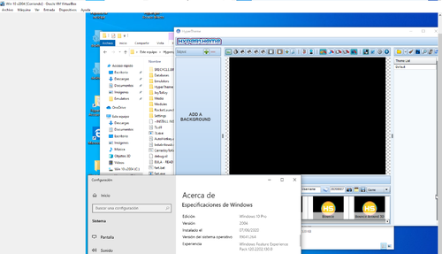

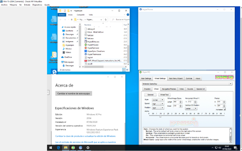

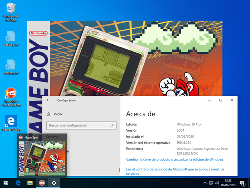

Crantus Posted June 7, 2020 Posted June 7, 2020 2 hours ago, dark13 said: Try to put these dlls inside HS folder I've been doing more tests. I have got it to work on W10 v2004 x64. This attached system file (sxs.dll) needs to be put into the root Hyperspin folder (it is not necessary to put the ntdll.dll file). It is a file from v1909 located in Windows\SysWOW64\. I have run it on a 64 bit w10 v2004 final virtual machine (clean install). I don't know if it will work on w10 v2004 x32bit. I am attaching the analog dll file from the Windows\system32\ folder of v1909, in case someone wants to try it by following the same steps to see if it works. I put a test capture. Thank you very much for everything. ------------------------- He estado haciendo más pruebas. He conseguido que funcione en W10 v2004 x64 final. Hay que meter en la carpeta raíz de Hyperspin este archivo de sistema (sxs.dll) adjunto (no es necesario meter el archivo ntdll.dll). Es un archivo de la v1909 situado en Windows\SysWOW64\. Lo he ejecutado en una máquina virtual del w10 v2004 de 64 bits (instalación limpia). No se si funcionará en w10 v2004 de 32 bits. Adjunto el archivo dll análogo de la carpeta system32 de la v1909, por si alguien lo quiere probar siguiendo los mismos pasos para ver si funciona. Pongo una captura de prueba. Gracias por todo. sxs x32bits.zip sxs x64bits.zip

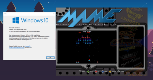

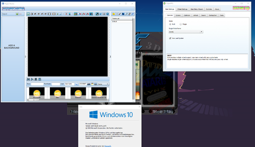

Aetron Posted June 7, 2020 Author Posted June 7, 2020 @fr0stbyt3 @Crantus Can confirm Hyperspin starts with this DLL in HS root and its able to trigger Rocketlauncher to boot games. But HyperHQ still not starting. Task is openeing for a second and then closes. Windows 10 2004 Build 19041.264
Crantus Posted June 7, 2020 Posted June 7, 2020 8 minutes ago, Aetron said: @fr0stbyt3 @Crantus Can confirm Hyperspin starts with this DLL in HS root and its able to trigger Rocketlauncher to boot games. But HyperHQ still not starting. Task is ofeneing for a second and then closes. Windows 10 2004 Build 19041.264 In my test HyperHQ works, but HyperTheme doesn´t work. May need other dlls.
Aetron Posted June 7, 2020 Author Posted June 7, 2020 I downloaded a fresh copy of HS. Put in sxs.dll in root bevore first launch. HS, HSHQ and HyperTheme launching without any configuration or compatibility. Just out of the Box. I copied HQ exe from Download to my installation and after this. HQ also works there.
Crantus Posted June 7, 2020 Posted June 7, 2020 25 minutes ago, Aetron said: I downloaded a fresh copy of HS. Put in sxs.dll in root bevore first launch. HS, HSHQ and HyperTheme launching without any configuration or compatibility. Just out of the Box. I copied HQ exe from Download to my installation and after this. HQ also works there. Yes. I put again a full install of hyperspin with sxs.dll and now my HyperTheme is working too. We have opened the way for a new version of the Hyperspin.
