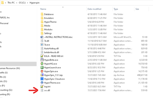

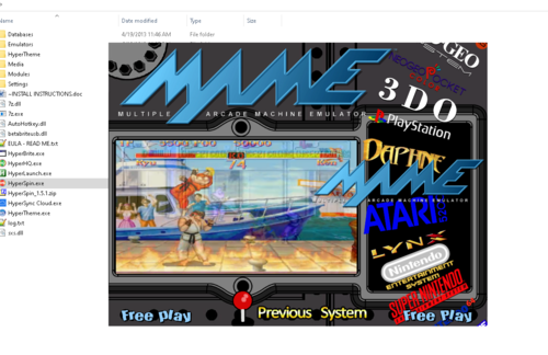

jesfknkrys Posted July 27, 2023 Posted July 27, 2023 Update: 8/2/23 I installed Hyperspin 1.51 on a Surface Pro with Windows 11 with latest updates up to 8/2/2023 and worked as well. I just downloaded and installed a fresh copy of Hyperspin 1.5.1 on Windows 10 Pro 22H2 and worked without any issues. See picture below. Things to try: 1. Right click on "Hyperspin.exe" and select "Run as Administrator". 2. DIsable your antivirus temporarily. 3. Download a fresh copy of Hyperspin ad install it on a separate drive to test. That way we rule out Hyperspin as the issue. Don't forget to copy the sxs.dll file inside the Hyperspin folder. Let us know if you need additional assistance.
