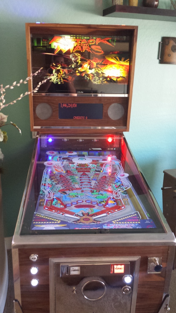

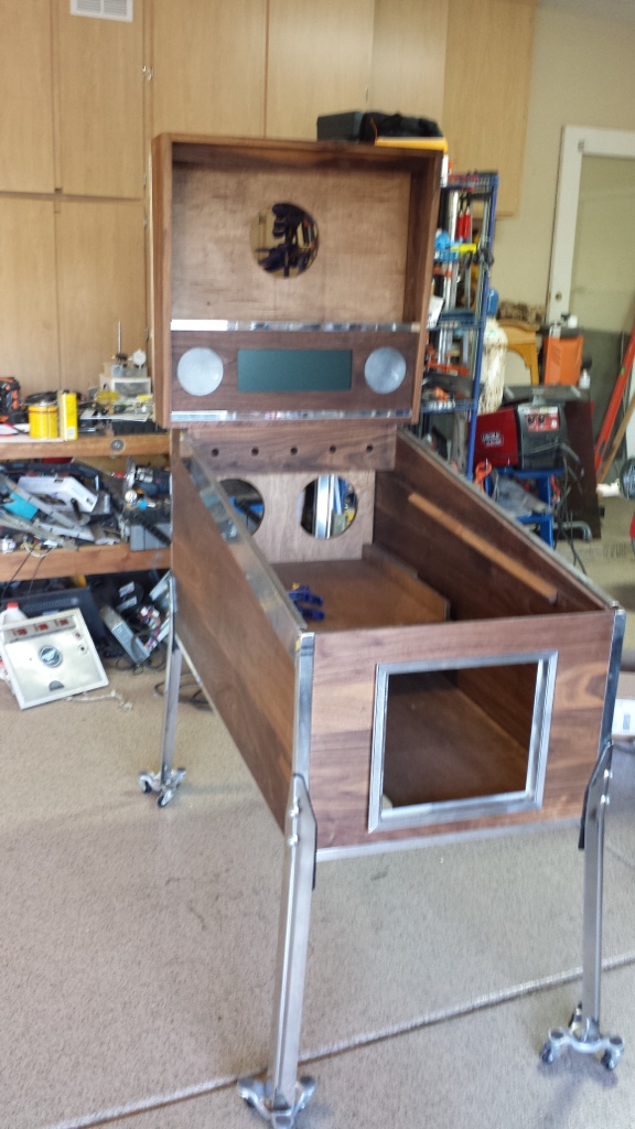

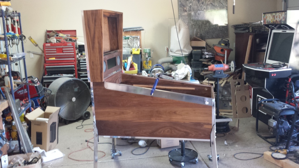

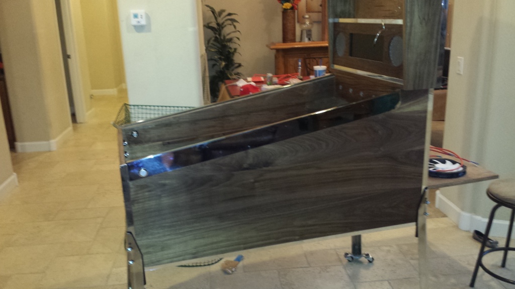

I decide to make a matching pin cab to go along my arcade machine and I'm glad I did
Arcade machine build
http://www.hyperspin-fe.com/forum/showthread.php?31043-Out-with-the-old-in-with-the-new

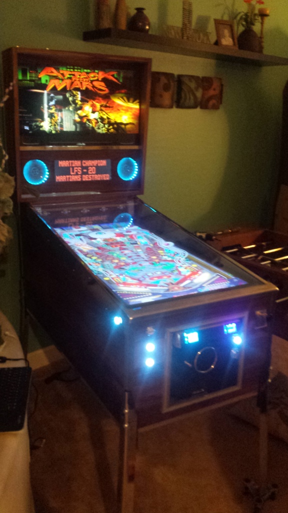

3 screen cab
46"x30"x17"

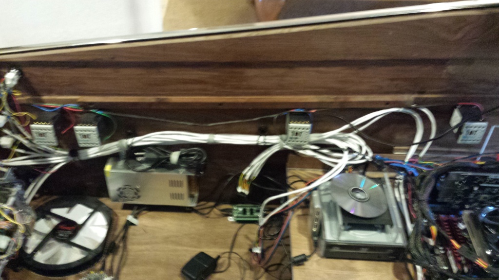

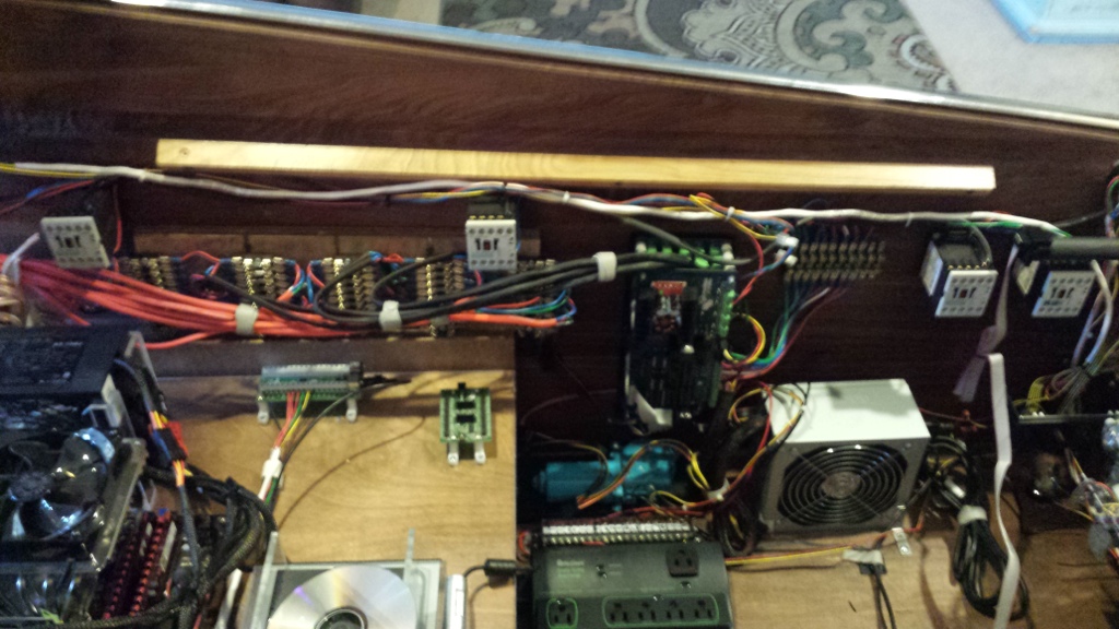

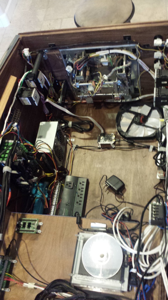

8 contactors
10 rgb LEDs flashers 5 on top 5 above screen
4 strobe 2 on top 2 above screen
Zebs booster board with spinner and motor
Vp plunger v2
7 ulitmarc rgb buttons
Knocker
And much more just forgot what eels I put into it

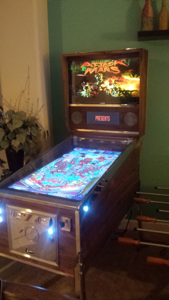

Soild black walnut with polished aluminum on sides and polished stainless stell coin door and side railings I haven't got to get lockdown bar polished yet
All metal is flush to wood

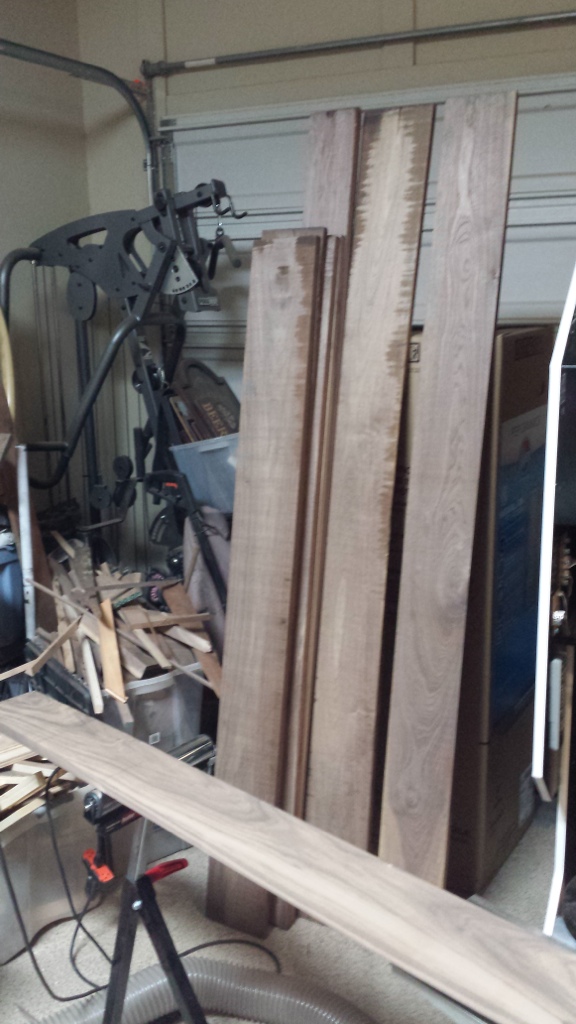

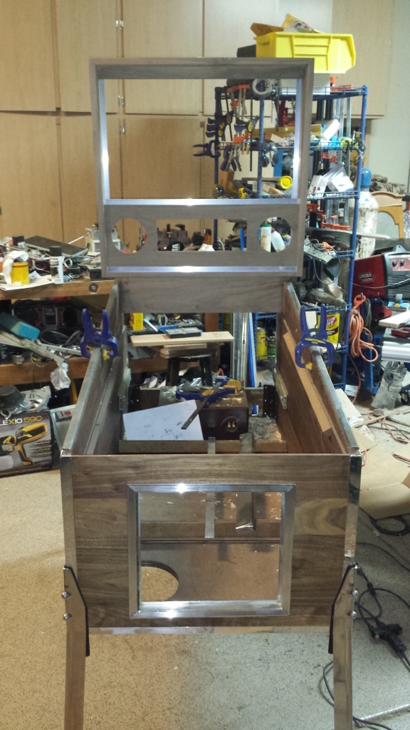

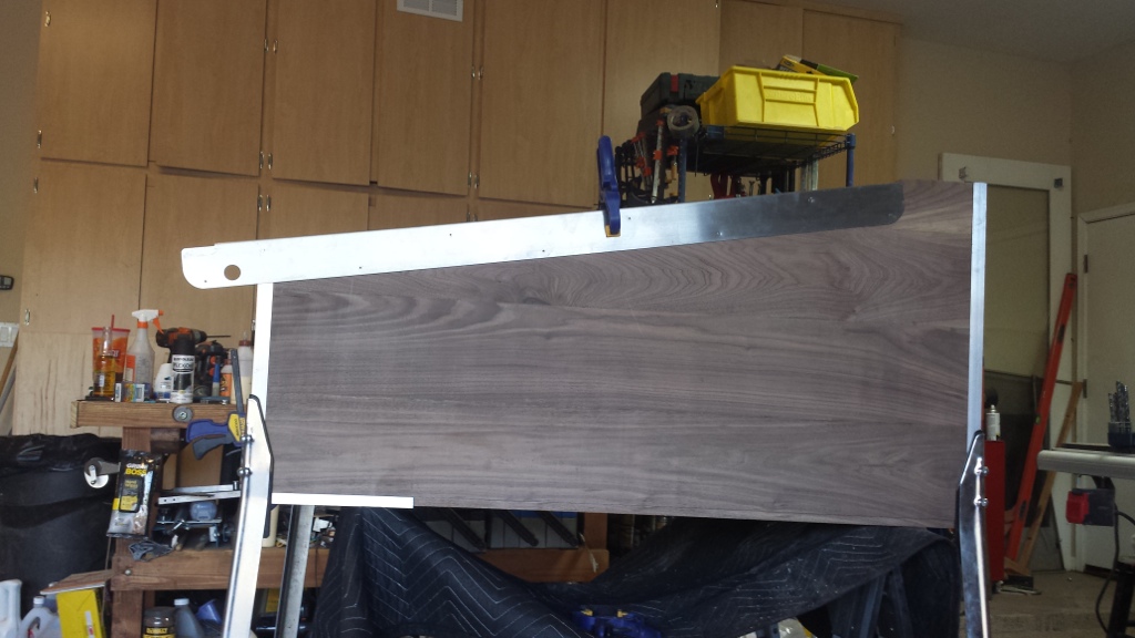

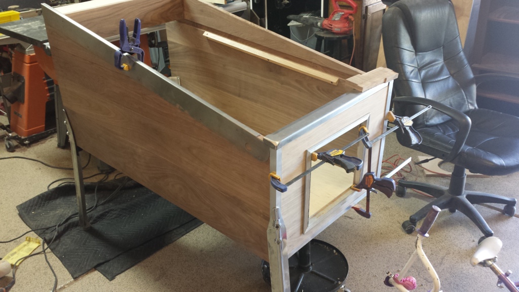

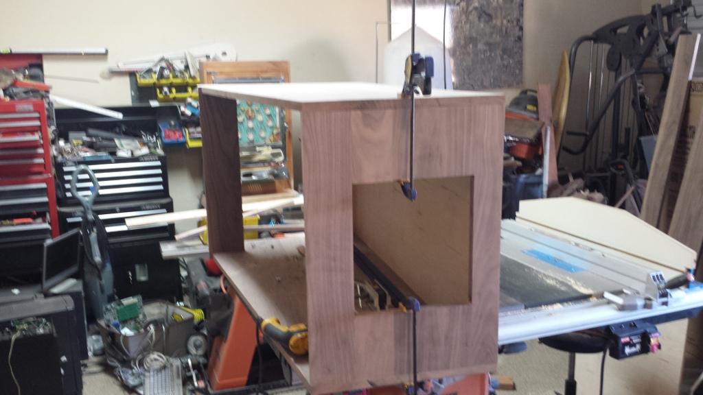

Just the wood stacked up waiting to be turned into a pinball machine
Taking shape
Man that was some nice walnut....
Great build, very classy!

It's a work of art! Some great craftsmanship there.

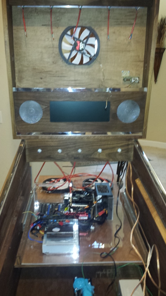

For tvs I don't know model numbers
But back glass is a cheap sceptre tv and play field is a Westinghouse I didn't decase them
And for TV slope if I remember correctly I think 1/2"
But from top of glass to tv
in back it's 4 1/2" and front it 1/2"
