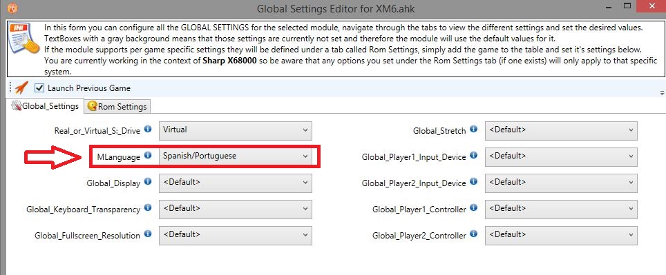

Melu Posted November 17, 2014 Posted November 17, 2014 Is it possible to adapt this module to a Spanish Windows? I know that in the module Gamecom that possibility exists. MEmu = GameCom MEmuV = v29/12/1998 MURL = MAuthor = djvj MVersion = 2.0.1 MCRC = BE94305 iCRC = CCF77D79 MID = 635038268895496903 MSystem = "Tiger Game.com" ;---------------------------------------------------------------------------- ; Notes: ; Make sure you have ALL the roms on the emulator dir and also the following files: BITMAP2.BIN, MAIN.HEX, MAIN0.HEX, & MAIN0S.HEX ; Roms must be unzipped ; If you do not have an English windows, set the language you use for the MLanguage setting in HLHQ. Currently only Spanish/Portuguese is supported. ; ; Keys: ; A,S,Z,X - A,B,C,D (like the console layout) ; F2 - Reset ; F3 - Mute ; F4 - Pause (this seems to reboot the console also) ; Arrows - Digital pad ; Aiming in Resident Evil 2 goes with Z. Then A is shooting ;---------------------------------------------------------------------------- StartModule() settingsFile := modulePath . "\" . moduleName . ".ini" Fullscreen := IniReadCheck(settingsFile, "Settings", "Fullscreen","true",,1) ShowIntro := IniReadCheck(settingsFile, "Settings", "ShowIntro","false",,1) ; Show the Tiger Logo before the main menu, cannot autostart games if true AutoStartGame := IniReadCheck(settingsFile, "Settings", "AutoStartGame","true",,1) ; Will only work if ShowIntro is false BlockInput := IniReadCheck(settingsFile, "Settings", "BlockInput","false",,1) ; Set to true if the module works for you and you don't want foreign key presses disturbing the launch process errorFix := IniReadCheck(settingsFile, "Settings", "errorFix","false",,1) ; Set to true if you get a windows no disk error after the emu starts. It has been reported to happen on 32-bit OSes. This adds 2 seconds to launch if you don't get the error, so set to false for a quicker launch if you never see the error. MLanguage := IniReadCheck(settingsFile, "Settings", "MLanguage","English",,1) ; If English, dialog boxes look for the word "Open" and if Spanish/Portuguese, looks for "Abrir" mLang := Object("English","Open","Spanish/Portuguese","Abrir") winLang := mLang[MLanguage] ; search object for the MLanguage associated to the user's language If !winLang ScriptError("Your chosen language is: """ . MLanguage . """. It is not one of the known supported languages for this module: " . moduleName) hideEmuObj := Object("Game.Com Emulator ahk_class #32770",1,"Windows - No Disk ahk_class #32770",0,"Disassemble Window ahk_class #32770",0,winLang . " ahk_class #32770",0,"Input ahk_class #32770",0) ;Hide_Emu will hide these windows. 0 = will never unhide, 1 = will unhide later If fadeIn = true { FadeInStart() Gui 5: +LastFound WinGet GUI_ID5, ID Gui 5: -AlwaysOnTop -Caption +ToolWindow StringTrimLeft,fadeColor,fadeLyr1Color,2 Gui 5: Color, %fadeColor% Gui 5: Show, x0 y0 h%A_ScreenHeight% w%A_ScreenWidth% } 7z(romPath, romName, romExtension, 7zExtractPath) errorLvl := Run(executable, emuPath, "UseErrorLevel") HideEmuStart() ; This fully ensures windows are completely hidden even faster than winwait If errorLvl != 0 { MsgBox, 48, Exe Error, Error launching emulator`, closing script., 5 ExitModule() } If BlockInput = true BlockInput, On If errorFix = true { DetectHiddenWindows, on WinWait("Windows - No Disk ahk_class #32770",,,2) ControlClick, Button3, Windows - No Disk ahk_class #32770 } WinWait("Game.Com Emulator ahk_class #32770") Loop { ; What window is active at launch determines how the script will react IfWinActive, Game.Com Emulator ahk_class #32770 Break IfWinActive Disassemble Window ahk_class #32770 Goto DisWindow } ; If disassembly window didn't open, lets open it IfWinNotExist, Disassemble Window ahk_class #32770 WinMenuSelectItem, Game.Com Emulator ahk_class #32770,, Window, Open Disasm Window DisWindow: WinWait("Disassemble Window ahk_class #32770") ; waiting for disassemble window to open WinWaitActive("Disassemble Window ahk_class #32770") WinMenuSelectItem, Disassemble Window ahk_class #32770,, File, Load BIN File WinWait(winLang . " ahk_class #32770") ; Waiting for window to open to select the rom WinWaitActive(winLang . " ahk_class #32770") Loop { ; looping this so we don't need a sleep timer, usually 2nd loop text gets pasted in correctly ControlGetText, edit1Text, Edit1, %winLang% ahk_class #32770 If ( edit1Text = romPath . "\" . romName . romExtension ) Break Sleep, 100 ControlSetText, Edit1, %romPath%\%romName%%romExtension%, %winLang% ahk_class #32770 } Send {Enter} WinWait("Input ahk_class #32770") ; waiting for input box to appear WinWaitActive("Input ahk_class #32770") Send {Enter} WinWait("Disassemble Window ahk_class #32770") ; waiting for disassemble window to come back into focus WinWaitActive("Disassemble Window ahk_class #32770") If ShowIntro = true WinMenuSelectItem, Disassemble Window ahk_class #32770,, File, Load Kernel., Full Kernel Else WinMenuSelectItem, Disassemble Window ahk_class #32770,, File, Load Kernel., Test Kernel Control, Check,, Button4, Disassemble Window ahk_class #32770 WinHide, Disassemble Window ahk_class #32770 ; hide the disassemble window so we don't see it in the background ; Remove window elements If Fullscreen = true { WinSet, Style, -0xC00000, Game.Com Emulator ahk_class #32770 ; Removes the TitleBar DllCall("SetMenu", uint, WinActive( "A" ), uint, 0) ; Removes the MenuBar WinSet, Style, -0x40000, Game.Com Emulator ahk_class #32770 ; Removes the border of the game window Sleep, 600 ; Need this otherwise the game window snaps back to size, increase if this occurs } If AutoStartGame = true { SetKeyDelay 200 ; increase if keys are not being sent to the main menu Sleep, 500 ; increase if keys are being sent to early Send {Right Down}{Right Up}{a Down}{a Up} } If Fullscreen = true MaximizeWindow("Game.Com Emulator ahk_class #32770") HideEmuEnd() FadeInExit() BlockInput, Off Process("WaitClose", executable) 7zCleanUp() FadeOutExit() ExitModule() MaximizeWindow(class) { WinGetPos, appX, appY, appWidth, appHeight, %class% widthMaxPercenty := ( A_ScreenWidth / appWidth ) heightMaxPercenty := ( A_ScreenHeight / appHeight ) If ( widthMaxPercenty < heightMaxPercenty ) percentToEnlarge := widthMaxPercenty Else percentToEnlarge := heightMaxPercenty appWidthNew := appWidth * percentToEnlarge appHeightNew := appHeight * percentToEnlarge Transform, appX, Round, %appX% Transform, appY, Round, %appY% Transform, appWidthNew, Round, %appWidthNew%, 2 Transform, appHeightNew, Round, %appHeightNew%, 2 appXPos := ( A_ScreenWidth / 2 ) - ( appWidthNew / 2 ) appYPos := ( A_ScreenHeight / 2 ) - ( appHeightNew / 2 ) WinMove, %class%,, appXPos, appYPos, appWidthNew, appHeightNew } CloseProcess: FadeOutStart() WinClose("Game.Com Emulator ahk_class #32770") Return I adapt the .isd file, but I had no luck with the module:
craiganderson Posted November 17, 2014 Author Posted November 17, 2014 yeah. it is possible for sure and i will do it but i need to know two things is the correct word for "open" = "Abrir" on your computer? ______________________________________ and then the only other thing is a command that is sent to the command prompt window! i needs to send subst s: "%VDDromPath%" at one point and subst s: /d at another point. would this command be the same in spanish?? i dont know the answer. here is a page that talks about the process http://www.askvg.com/create-a-virtual-drive-for-your-desired-folder-in-my-computer-using-subst-command/ http://craigandersonthemes.weebly.com/

Melu Posted November 18, 2014 Posted November 18, 2014 is the correct word for "open" = "Abrir" on your computer? Yes, it is possible . I know in Game.com & Philips VG5000 modules used the parameter mLang := Object("English","Open","Spanish/Portuguese","Abrir") I'm not sure if it is Windows or emulator problem but I do not understand programming modules. What I have to do with this? subst s: "%VDDromPath%" at one point and subst s: /d at another point. Thank you for your attention
craiganderson Posted November 18, 2014 Author Posted November 18, 2014 I will make a module for you. Here try this one. Spanish module May have to alter it more Please let me know if it works See below XM6.zipFetching info... http://craigandersonthemes.weebly.com/

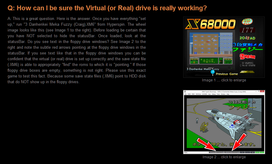

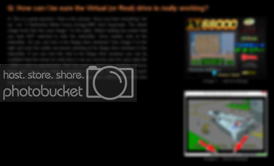

craiganderson Posted November 18, 2014 Author Posted November 18, 2014 Awesome Make sure u check its truly working via the method in the pic. Because the save state files will load a game and look good to go even if they can't find Roms (ie no text in floppy drives). But if the text is in the floppy drives you are truly good to go. See red arrows in pic. Thanks for trying it out. http://craigandersonthemes.weebly.com/
Climber Posted November 18, 2014 Posted November 18, 2014 Yes Craiganderson loaded that game up and both disks show on bottom just like picture thanks again for this great system

Melu Posted November 18, 2014 Posted November 18, 2014 Workedd!!!!!!!! My fault was that i had to run games with extension XM6.
