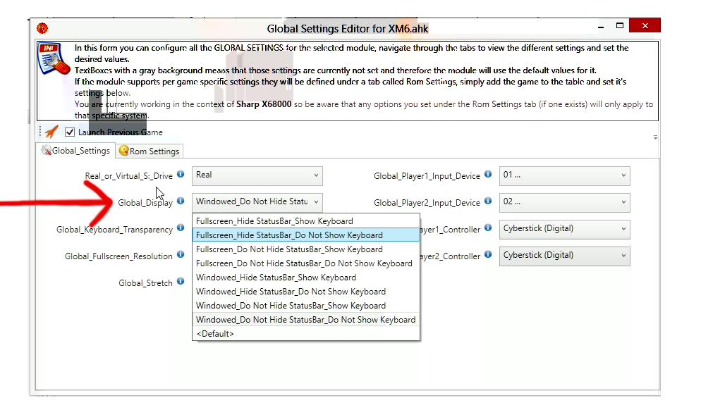

Konamito Posted December 10, 2014 Posted December 10, 2014 First of all, thanks for your hard work on this system. It works fine for me in a Spanish Windows But, just one thing: the emulator opens in windowed mode instead of fullscreen. I've done ALT+ENTER to switch to fullscreen but once I close the emulator and I open it again it goes back to windowed mode... Do I missing something here? Also, I would like to hide the status bar on the bottom of the screen, is it possible? Thanks in advance MSXBlog Tenerife Go Retro
craiganderson Posted December 10, 2014 Author Posted December 10, 2014 Konamito said: First of all, thanks for your hard work on this system. It works fine for me in a Spanish Windows But, just one thing: the emulator opens in windowed mode instead of fullscreen. I've done ALT+ENTER to switch to fullscreen but once I close the emulator and I open it again it goes back to windowed mode... Do I missing something here? Also, I would like to hide the status bar on the bottom of the screen, is it possible? Thanks in advance Thanks for trying the setup. All of the options you mention should be available in the HLHQ settings area under the GLOBAL DISPLAY option. See pic below. http://craigandersonthemes.weebly.com/
Konamito Posted December 10, 2014 Posted December 10, 2014 Thanks a lot! Works fine. I'm just a newbie in HS so didn't know where to go to change settings. MSXBlog Tenerife Go Retro
