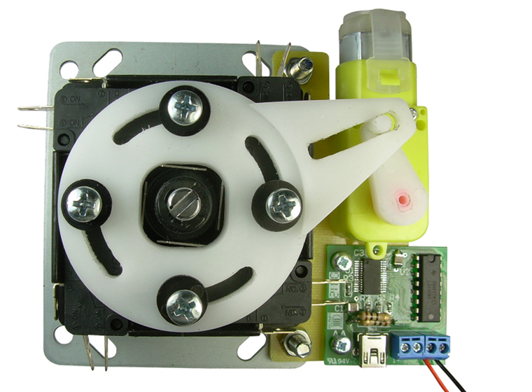

RetroBorg Posted August 6, 2012 Posted August 6, 2012 Any chance that HyperSpin can support the new Ultimarc ServoStik? Joystick with motor-driven restrictor. USB controlled with full software support using GUI, hotkeys, command line or API. Full details can be found on http://www.ultimarc.com/servostik.html

dustind900 Posted August 6, 2012 Posted August 6, 2012 API Support (for programmers) The Ultimarc PacDrive DLL incorporates support for the Servostik. It provides two API calls: bool PacSetServoStik4Way(); bool PacSetServoStik8Way(); The DLL is part of the PacDrive SDK Copy/Pasted from source page Seems like it could be incorporated this way as well. Edit: Somehow I skipped right over your post BBB, otherwise I probably wouldn't have bothered posting the above API.
Kodiak Posted August 6, 2012 Posted August 6, 2012 Simple script to parse Mame for 4-way Joystick action...currently amounts to under 500 games...this assumes all other games are 8-way. It also lists number of players...so that might be useful for doing more than one joystick... AutoIt Source #Include <Array.au3> #Include <Constants.au3> #Include <File.au3> #Include <String.au3> Dim $Info_Games ; Select Mame Executable If NOT FileExists( @ScriptDir & '\MameList.xml' ) Then While 1 $Mame = FileOpenDialog( 'Select Mame Executable.' , '' , 'Executables (*.exe)' , 1 + 4 ) If @Error Then MsgBox( 4096 , 'Error:' , 'No Executable Chosen.' ) Exit Else ; Write Out Mame List XML RunWait ( @ComSpec & ' /c "' & $Mame & '" -listxml > MameList.xml' , @ScriptDir , @SW_HIDE ) ExitLoop EndIf WEnd EndIf ; Read Mame List XMl $Mame = FileOpen( @ScriptDir & '\MameList.xml' , 0 ) If $Mame = -1 Then MsgBox(0, "Error", "Unable to open MameList.xml") Exit EndIf ; Read Mame List XML $Info_Games = FileRead( $Mame ) FileClose( $Mame ) ; Perform Basic RegEx $Mame__Version = StringRegExp( $Info_Games , '(?s)(?i)\s*?<mame build="(.+?) \(.+?\)" debug=".+?" mameconfig=".+?">' , 3 ) $Games_Total = StringRegExp( $Info_Games , '(?s)(?i)\s*?(<game .+?</game>)' , 3 ) ; Free Memory (Distroy Array) $Info_Games = '' ; Find All JoyStick Games $JoyStick4 = _ArrayFindAll( $Games_Total , '<control type="joy" ways="4"' , 1 , 0 , 0 , 1 ) Dim $ReturnString $ReturnString &= '[JoyStick Last]' & @CRLF $ReturnString &= 'Position = ' & @CRLF & @CRLF For $i = 0 To UBound( $JoyStick4 ) - 1 $RegExFind_01 = StringRegExp( $Games_Total[$JoyStick4[$i - 1]] , '(?s)(?i)<game name="(.+?)"' , 1 ) $RegExFind_02 = StringRegExp( $Games_Total[$JoyStick4[$i - 1]] , '(?s)(?i)(?:.+?<input players="(.+?)")?' , 1 ) $ReturnString &= '[' & $RegExFind_01[0] & ']' & @CRLF $ReturnString &= 'Players = ' & $RegExFind_02[0] & @CRLF & @CRLF Next $INIFile = FileOpen( @ScriptDir & '\ServoStik.ini' , 2 ) FileWrite( $INIFile , $ReturnString ) FileClose( $INIFile ) Never be afraid to try something new. Remember, amateurs built the ark. Professionals built the Titanic.

Kodiak Posted August 7, 2012 Posted August 7, 2012 Well I "guess" something like the following would be added to the top and bottom of the Mame module...AHK is not my lang. IniRead , CurrentGame , %a_scriptdir%\Controls.ini , %romName% , Players ; Test if We should Go 4-way IfNotEqual ( CurrentGame = "ERROR" ) { IniRead , Position , %a_scriptdir%\Controls.ini , "JoyStick Last" , Position IfNotEqual ( Position = "4-way" ) { IniWrite , "4-way" , %a_scriptdir%\Controls.ini , "JoyStick Last" , Position Run %comspec% /c "usccmd --sub 0`,4" ; (For 4-Way Mode) Run %comspec% /c "JoyTray -servo joy4way" ; (For 4-Way Mode) - ServoStik } } Else { IniRead , Position , %a_scriptdir%\Controls.ini , "JoyStick Last" , Position IfNotEqual ( Position = "8-way" ) { IniWrite , "8-way" , %a_scriptdir%\Controls.ini , "JoyStick Last" , Position Run %comspec% /c "usccmd --sub 0`,8" ; (For 8-Way Mode) Run %comspec% /c "JoyTray -servo joy8way" ; (For 8-Way Mode) - ServoStik } } << Add Code >> ; Test if We should Go Back to 8-way IfNotEqual ( CurrentGame = "ERROR" ) { IniWrite , "8-way" , %a_scriptdir%\Controls.ini , "JoyStick Last" , Position Run %comspec% /c "usccmd --sub 0`,8" ; (For 8-Way Mode) Run %comspec% /c "JoyTray -servo joy8way" ; (For 8-Way Mode) - ServoStik } Again this assumes that only 4-way games are listed in the Controls.ini...or whatever you wish to call your INI file...this also assumes that the sections are named after the roms short name...and that you have a key called Players set to some value...don't care what...just a value. There will also need to be a section called "JoyStick Last" with a key called Position that is set to 8-way or 4-way...with 8-way being the default. Note this is for the homemade servo outfit you made...and it's based in part on Chillin's script. Never be afraid to try something new. Remember, amateurs built the ark. Professionals built the Titanic.

bleasby Posted March 18, 2014 Posted March 18, 2014 I don't know what has being done for that, but if you want to have a automatic selection, without the need to filling a ini file with the control type info, you could use the info contained on the listxml file about the control type to make the selection automatically for you. As djvj said before, I really do not have the interesting of making the support for that as I do not have a servo-stick myself, but if you take a look at the mame module, every time that is runs, we call a function named ListXMLInfo that creates and reads the info inside the MAME created info file for the running game. Inside this info there is a field that have the type of controls for the current game. For example: <input players="2" buttons="5" coins="4" service="yes" tilt="yes"> <control type="joy" ways="8"/> If you know a little bit of programming, you can see how things are done in the ListXMLInfo function and extend it to get also the info from the "ways" field to add a automatic change for your servo-stick without the need for any ini edit. When asking for help for RocketLauncher, POST ON THE RLAUNCHER.NET FORUMS! Also, please post your RocketLauncher.log with logging level set to troubleshooting in pastebin (set the log level in RocketLauncherUI, global system > General Settings -> RocketLauncher). Ass. Bleasby - RocketLauncher Development Team.

123jimbo Posted August 7, 2014 Posted August 7, 2014 Made some changes to the MAME.ahk as suggested in earlier post to try and get Ultimarc's ServoStick auto-switching. Hopefully it'll keep working as I continue with the rest of the software component of my cab. Never looked at any AHK code before, so maybe there are better ways, but it'll do for me now. I've attached my file here,.. just rename it,... see how you go. Cheers, Jim..... Servo-MAME.ahk.txt
