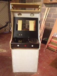

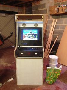

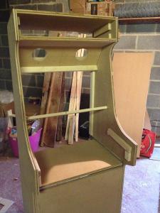

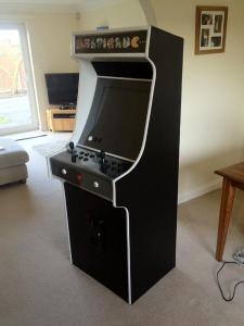

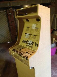

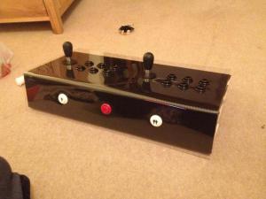

barrica Posted March 16, 2015 Posted March 16, 2015 Hello guys, Just wanted to post a few pics of my finished cab. Its been a very challenging and rewarding experience, but totally worth it. I've learnt lots, and thank you to all the contributions and invaluable advice on here. I'd estimate that all in all its taken around 3 months to complete, and cost about £600 total. Currently being enjoyed in the lounge, but according to the wife that is not an "appropriate permanent home"!! Can't wait to get started on the next project! Thanks
Dubbloseven Posted March 16, 2015 Posted March 16, 2015 nice build mate. My YouTube Channel https://www.youtube.com/channel/UCx0yXVItMU6uz4z5hUavGgA
Johannes1100 Posted March 16, 2015 Posted March 16, 2015 Thats a really nice and clean style - just the type I like!

iNTiGOD Posted March 18, 2015 Posted March 18, 2015 Great job!!! MAME High Score Tutorial For HyperSpin

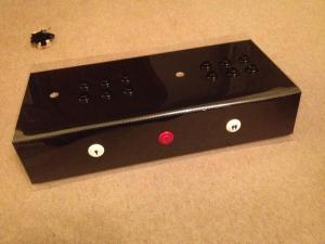

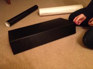

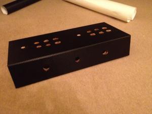

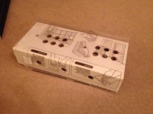

Bigodassa Posted March 18, 2015 Posted March 18, 2015 What type of sticker did you use on your cpo? Is it vinil? How did you manage to get it so shiny?
barrica Posted March 18, 2015 Author Posted March 18, 2015 What type of sticker did you use on your cpo? Is it vinil? How did you manage to get it so shiny? Thanks Guys, Regarding the CP, yes its carbon fibre vinyl, but with a clear perspex panel over the top with holes cut for the buttons and joystick. The vinyl is sticky back ,so sticks directly to the MDF underneath, the buttons then hold the perspex in place.
Bigodassa Posted March 18, 2015 Posted March 18, 2015 @barrica thnx for the quick reply. I can see the persplex now, I was using tapatalk on my cellphone and I could only see the reflex effect of the material. Great job, it looks awesome!

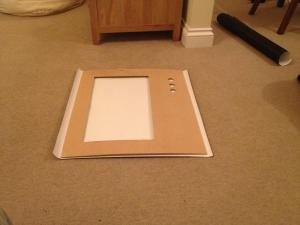

griffin518 Posted April 14, 2015 Posted April 14, 2015 What did you use on the top and bottom of the plexi covering your display? I'm planning a build and looking at options for covering that gap as well. Download my RocketLauncher bezels: http://hyperspin-fe.com/files/file/14367-griffin518s-bezel-depot/ Best of MAME HyperSpin XML: http://www.hyperspin-fe.com/files/file/11710-griffin518s-best-of-mame-xml-database/ Best of MAME bezel pack: http://www.hyperspin-fe.com/files/file/11711-griffin518s-best-of-mame-bezel-pack/ Custom MAME ini files w/HLSL settings: http://www.hyperspin-fe.com/files/file/11712-griffin518s-best-of-mame-mameuifx-ini-files/
