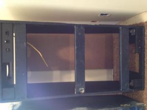

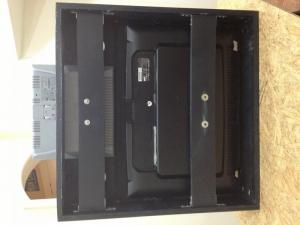

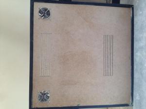

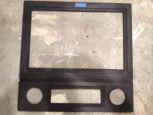

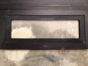

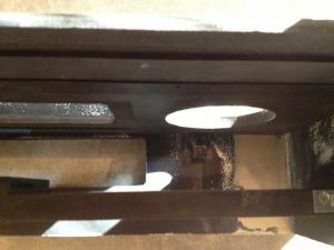

tchiacch Posted September 9, 2013 Author Posted September 9, 2013 Getting back to build after our real work slowed our project down. Finishing backbox now. Wanted to show you how we routed channels for plexi to fit flush. Pictures show grooves that plexi drops in with silicone to secure. Monitors mounted with ease of future replacement in mind if we buy pinDMD in future or need another backglass monitor (board mount gives us flexibility to change out).

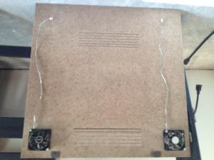

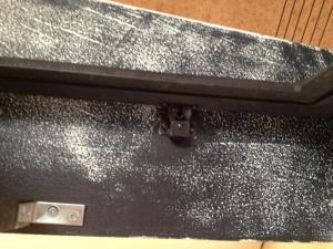

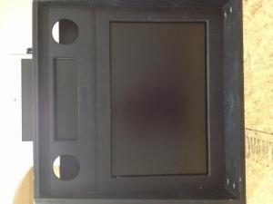

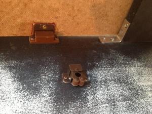

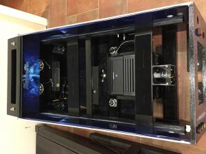

tchiacch Posted September 10, 2013 Author Posted September 10, 2013 Here are some more backbox shots. The front bezel has push latch release to pull out bezel. Used magnets for securing back panel in place.
tchiacch Posted September 10, 2013 Author Posted September 10, 2013 Back panel of backbox latched in place with magnets.

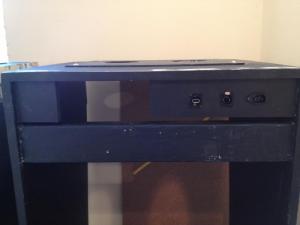

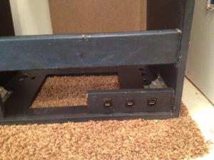

tchiacch Posted September 10, 2013 Author Posted September 10, 2013 Bottom of main cabinet has power, ethernet, usb in back. 3 usb connectors up front on bottom.
DeeGor Posted September 10, 2013 Posted September 10, 2013 Looks great. I like the USB ports on there.

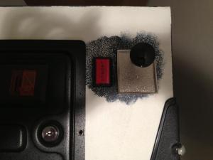

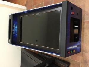

tchiacch Posted September 11, 2013 Author Posted September 11, 2013 Opted for lighted launch button next to plunger.

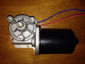

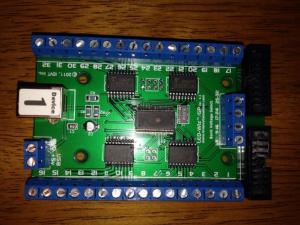

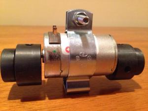

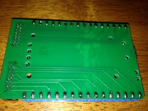

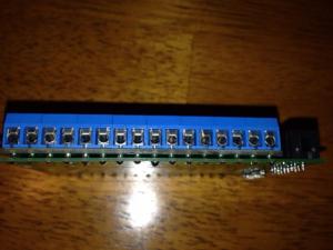

tchiacch Posted September 21, 2013 Author Posted September 21, 2013 Darkfall shaker assembled Gear motor wires soldered on Got zebs Ledwiz connector board and soldered onto ledwiz. Connections to booster now a ribbon cable. Thanks Zeb!
kizam33 Posted September 22, 2013 Posted September 22, 2013 Great build so far, What are the USB 's for?
tchiacch Posted September 22, 2013 Author Posted September 22, 2013 I wanted the ability to hook up external service devices like hard drives (backup), flash drives, mouse and keyboard if needed without opening cabinet. Just an ease of use thing for me.
zebulon Posted September 22, 2013 Posted September 22, 2013 Nice job with soldering the adapter! The next iteration of the adapter will have larger holes so the boards sit tighter together. Build looks great so far, some nice ideas being worked into the cab design. I know so much about so little that I could teach you everything there is to know about nothing....

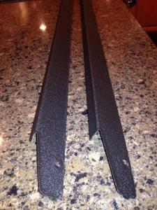

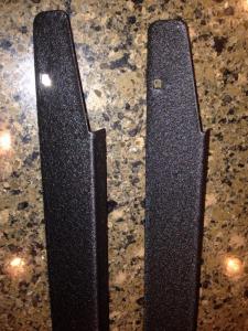

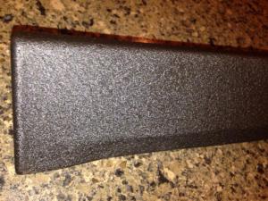

tchiacch Posted October 4, 2013 Author Posted October 4, 2013 Just got my lockdown bar and side rails powder coated black by a local company (both sets). Matches our powder coat legs. Very pleased with finish.
