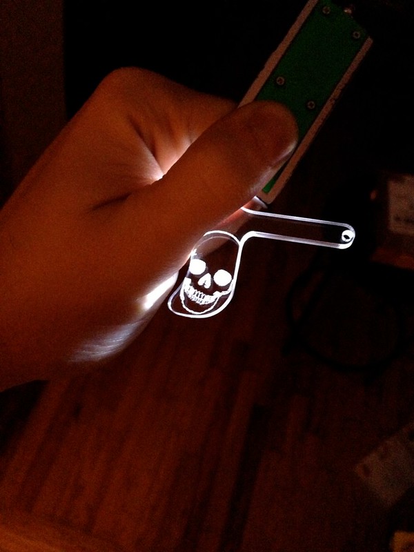

Aurich Posted December 7, 2012 Author Posted December 7, 2012 Got my laster cut pieces today. As much as I love the launcher gun, I was thinking that it was a pity there was no way to light it up with the LEDWiz for the launch ball function. I didn't really want to drill a hole in the metal, a bit thick, and it would look lame to just have a bare LED sticking out of it. So I thought what if I replaced the trigger with an acrylic one, stuck an LED inside the gun, and side lit it? I scanned the original metal trigger and traced it into a vector I could have laser cut. I had a bunch cut as long as I was paying for the square inches of the sheet, so I experimented with various levels of etching and design and left plenty of blanks to play with. I'll take some of the extras and mess with sanding them to frost them a bit etc, see what works best for being lit up. Initial tests seem to indicate it's going to work, but we'll see how it is when I can set it up with a proper lighting system.
Aurich Posted December 8, 2012 Author Posted December 8, 2012 Quick test of lighting up the acrylic from the side:

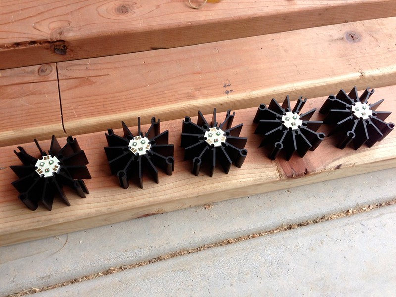

Aurich Posted December 17, 2012 Author Posted December 17, 2012 Waiting on zebulon's new boards before I get too serious about wiring, but thermal adhesived my Crees to the heatsinks today while I'm waiting. Progress is slow in general because of waiting on this dang lockdown bar.
