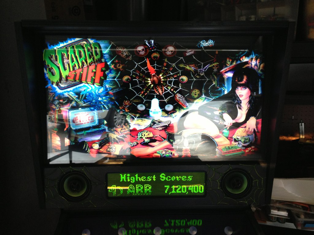

Aurich Posted February 22, 2013 Author Posted February 22, 2013 If you're a fan of Scared Stiff (one of my fav tables) I'm working on a treat with Herweh for everyone:
Aurich Posted February 22, 2013 Author Posted February 22, 2013 Rosve did an awesome B2S backglass, being able to have the interactive spider on the backglass was great. But it wasn't as high rez as I would have liked, the artwork was a little too dark (great for showing the lights but not so great for seeing things) and the spider wasn't so hot. Low rez, haloed, and the white plastic disc it was mounted out that's supposed to be behind the hole was visible. So without taking anything away from his hard work I wished I could redo the art. Herweh's new B2S editor isn't quite up to the task of doing something this interactive by itself, but luckily he was game to handle the extra coding himself, so we're working together on a new one. I sourced several different backglasses and frankensteined them together into the best complete image I could (with chriz99's as the foundation). Not as perfect as having access to a machine to photograph but I think about as good as it's going to get otherwise. High def resolution, and if you've seen SS in person you know part of the art is on a separate plexiglass layer, kept that alive unlike the prev version which felt like one flat piece. Couldn't find an acceptable spider photo, so I just made my own: I've got a beta of it and the new server code needed to run it, works great (what that photo is of). I dunno exactly when it will be all ready to release, but soon I would guess, really up to Herweh. I could nitpick a couple details here and there, but if he wanted to release as is I'd be happy. IMHO definitely an improvement over the prev B2S (thanks Rosve!), and works with the new server system, so easy to add to any version of the table you like (including the exisiting B2S modded one). If you have a 2 screen setup I put a Bally grill in too.

Aurich Posted February 26, 2013 Author Posted February 26, 2013 Scared Stiff B2S backglass is uploaded: http://www.vpforums.org/index.php?showtopic=23363&hl= Note that you'll need the latest version of the server to run it, we added new features to it that the old one doesn't support.

Aurich Posted February 26, 2013 Author Posted February 26, 2013 Someone in another forum was asking me questions about my DMD, so I shot some video for him. I think the gridlines are actually a little more pronounced in the video than in person, but if you want a rough idea what one of these segmented X-Pin DMDs look like this isn't a bad way to check it out.
Aurich Posted February 26, 2013 Author Posted February 26, 2013 That spider looks amazing! Nice job. And the cab isn't half bad either Thanks. I couldn't find a decent shot of the real thing, though I did find in my research that there were a lot of variations on the production one, so I felt like I was on pretty solid ground interpreting it. Started with this stock shot of a plastic spider and Photoshopped it into something closer to the real thing:
