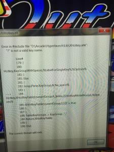

cookiejai Posted April 26, 2015 Posted April 26, 2015 Hi im new to hyperspin and im runing in to a problem. When ever i try loading a roms it gives me an error message, on hyperspin or hyperlaunch.
cookiejai Posted April 27, 2015 Author Posted April 27, 2015 i have the newest hyper spin and 6.01.1 hyper launch. the funny thing is it works on my windows 8 laptop but i get this error on my desktop. thanks in advance.
AxelTerizaki Posted April 28, 2015 Posted April 28, 2015 There is no such thing as Hyperlaunch 6. Not yet, at least. Where did you download your hyperlaunch? Is it Rocketlauncher? In hyperlaunch's directory you should find a hyperlaunch.log after you try to launch a rom, copy and paste it here.

cookiejai Posted April 30, 2015 Author Posted April 30, 2015 thanks every one for replying. Well i brought the drive with hyper spin on it. It has 3.01.1c hyperspin, it gives me an error each time i start a game but the weird thing is i installed on my window 8 laptop and it works. please help ..

nimpa Posted April 30, 2015 Posted April 30, 2015 Set xhotkey to off? Skickat från min iPhone med Tapatalk
cookiejai Posted May 1, 2015 Author Posted May 1, 2015 I really wish i have the time to do it my self. I mean it works but just not on my destop i really dont know why. The seller did try to help me out over teamviewer but no luck. Thats why i was hoping to get an answer here.
cookiejai Posted May 1, 2015 Author Posted May 1, 2015 hey nimpa sorry im new here how you turn off xhotkey ? Set xhotkey to off?Skickat från min iPhone med Tapatalk
Metalzoic Posted May 1, 2015 Posted May 1, 2015 thanks every one for replying. Well i brought the drive with hyper spin on it. It has 3.01.1c hyperspin, it gives me an error each time i start a game but the weird thing is i installed on my window 8 laptop and it works. please help .. 3.01.1? that sounds like you're looking at the Hyperlaunch version number, not Hyperspin. Problem is no one will know where your files are, what paths/names, what versions of emus you're running etc... to even really be able to help much. I know I can't really be any help. Sorry.
