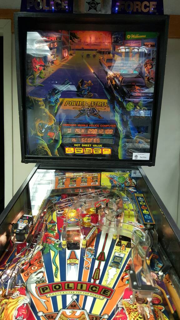

dougan78 Posted August 22, 2015 Author Posted August 22, 2015 Got some 4 player action in at the office. Interesting to note and maybe all pins are this way if someone locks up multi ball and doesn't get it the next player can activate it. That is cool. I am not sure the lane diverter is working on the right ramp. Will need to run a diag. But still plays good and is easy to do stuff so I am happy with the machine even though when I bought it I had no idea what it was. Really turned out well. Will post more pics once I get it all finalized.

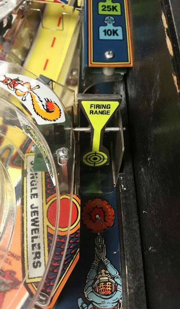

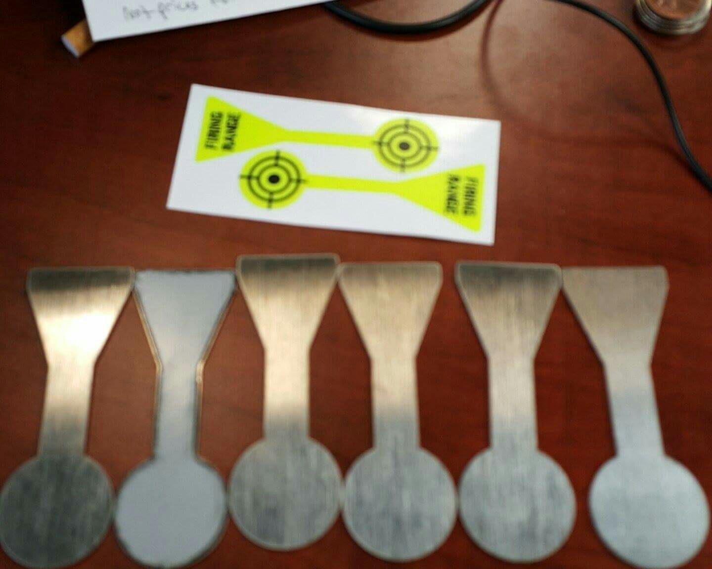

dougan78 Posted August 29, 2015 Author Posted August 29, 2015 Diverter is in fact working so that is good. New playfield glass will be in next week. The metal spinners I had made are in. Need to figure out putting that together. 16 mil is the high score so far and competition is heating up at the office as we figure out tricks to get that score up there. Thinking I need to sandwich 3 of them to get them on the spinner bar and use something to hold them together. They are made of solid stainless. Any ideas on this let me know.
Metalzoic Posted August 29, 2015 Posted August 29, 2015 You had those spinners made? That's awesome, they look really cool. Not sure what the best thing to glue stainless together is though. Rivet?
ninja2bceen Posted August 29, 2015 Posted August 29, 2015 I have no idea what I'm talking about first but if you can get a small hole on both sides of that bar and fit a pin through them. Then they wouldn't go anywhere it looks like Tapatalk signature Advance the cause to 100%. http://hyperbase.hyperspin-fe.com/ Planet Geekdom, Subscribe for Tutorials! https://www.youtube.com/channel/UCdcby-s2GwriaOHGmVC2vGA?sub_confirmation=1&app=desktop

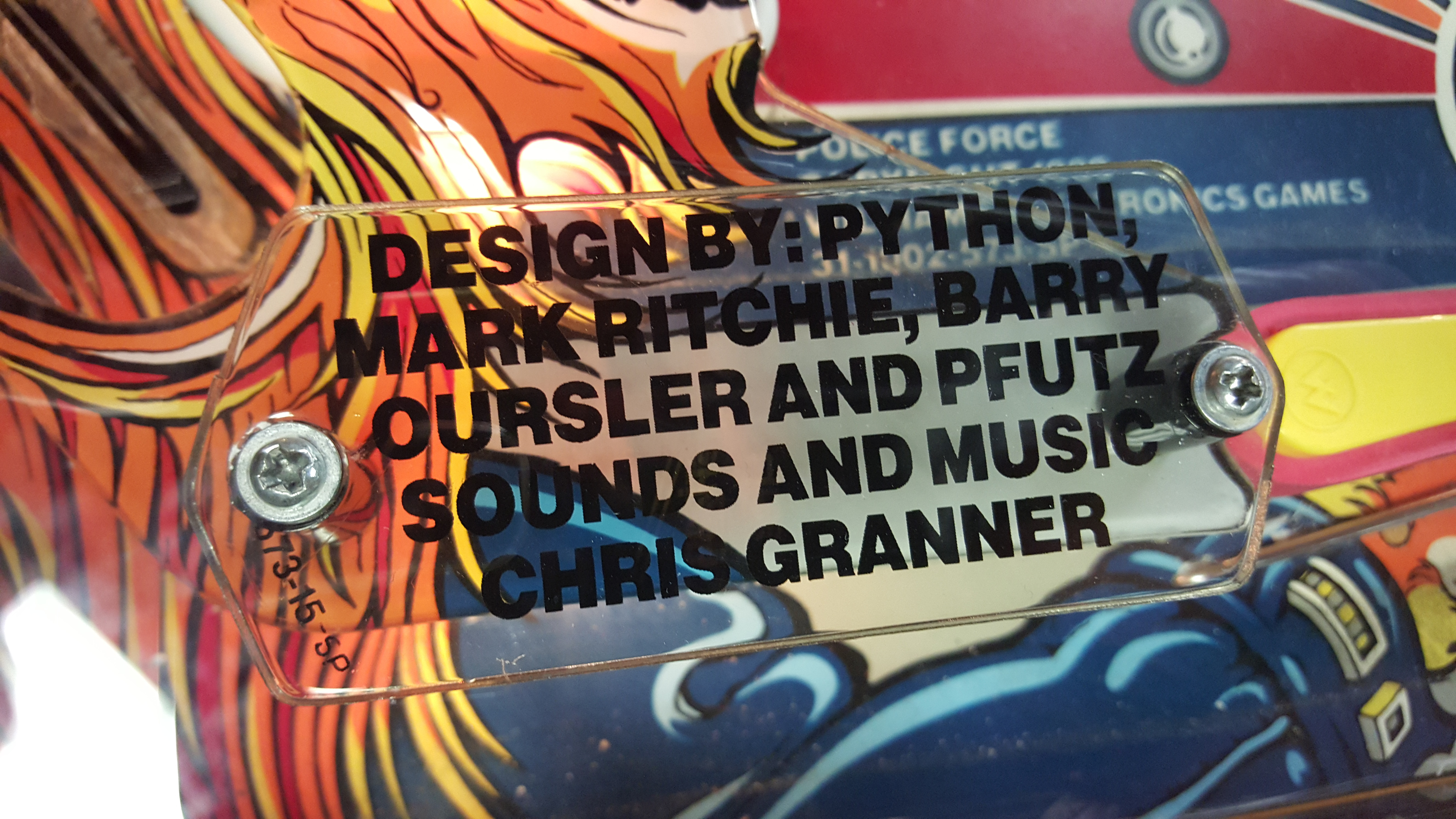

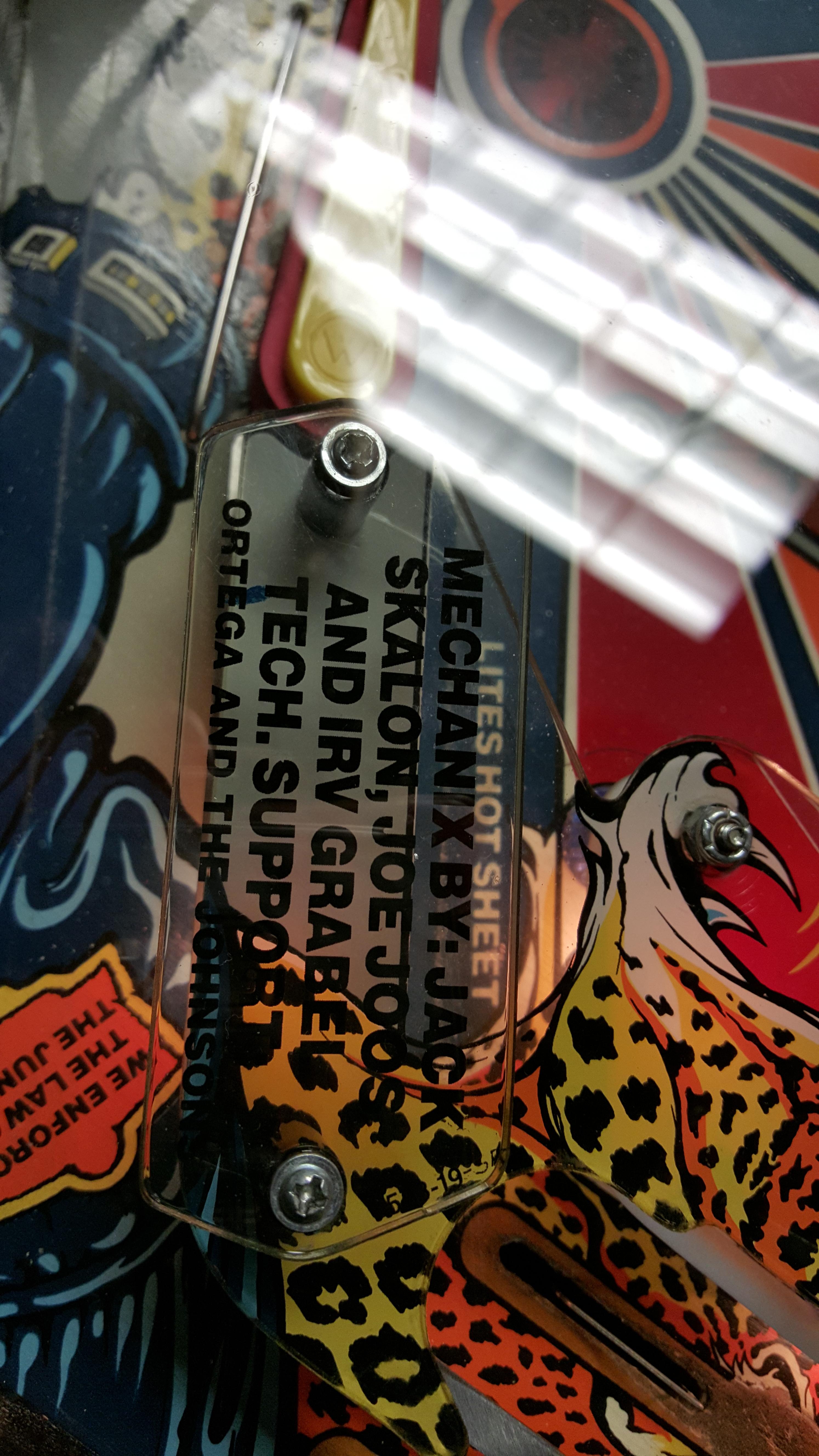

32assassin Posted January 11, 2016 Posted January 11, 2016 very nice, for us virtual users, I have been working on a VP X version of this table, all the pink stuff is missing 3d models I need to make. (given that I still need to learn how to do them it will be a long time before i finish) any chance you can take a close up epicure of the lower drain plastics, the clear ones, I need to know what they say so that I can finish mine.
dougan78 Posted January 11, 2016 Author Posted January 11, 2016 Funny I can do that for sure. Give me a day or 2.
dougan78 Posted January 12, 2016 Author Posted January 12, 2016 very nice, for us virtual users, I have been working on a VP X version of this table, all the pink stuff is missing 3d models I need to make. (given that I still need to learn how to do them it will be a long time before i finish) any chance you can take a close up epicure of the lower drain plastics, the clear ones, I need to know what they say so that I can finish mine.

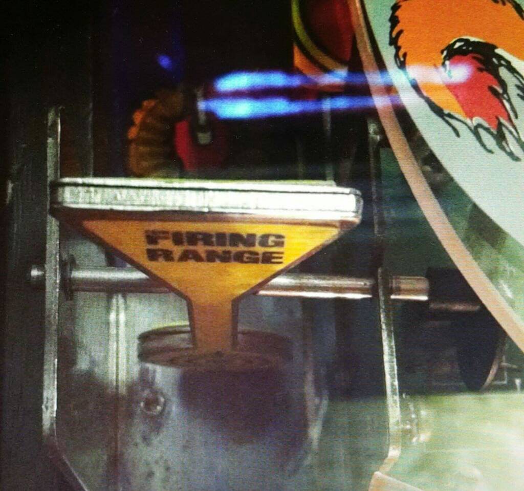

kactussjack Posted May 10, 2016 Posted May 10, 2016 Hi Dougan. Just came across this thread. I am currently working on a Police Force restoration and I see that you made your own spinner. Do you have a spare one you would like to sell? I can't find one anywhere. If not do you have a dwg or the dimensions of the spinner you could send me. I only have the round half. How did you attach the shaft? What is the diameter of the shaft? Also would it be possible to get a scan or close photo of the cat at the rt outlane & the spaceman in the shooter lane? Any help you could provide would be appreciated. Thanks. Dennis
dougan78 Posted May 11, 2016 Author Posted May 11, 2016 Hi Dougan. Just came across this thread. I am currently working on a Police Force restoration and I see that you made your own spinner. Do you have a spare one you would like to sell? I can't find one anywhere. If not do you have a dwg or the dimensions of the spinner you could send me. I only have the round half. How did you attach the shaft? What is the diameter of the shaft? Also would it be possible to get a scan or close photo of the cat at the rt outlane & the spaceman in the shooter lane? Any help you could provide would be appreciated. Thanks. Dennis it is funny you mention this. We have been playing with out the spinner. I have no idea what the original spinner was made of. Mine came with the post to attach the metal spinner to. So i bought the stickers and had new stainless steel spinners made. Based on photos I have seen of the entire spinner box (which is the spinner post with photosensor wheel, spinner, and the box that sits in the shooting lane) it looked like 2 hunks of metal sandwiched on the spinner post. The spinner post has a flat spot to accommodate that. So this evening my stainless steel templates were a bit too large so I had to grind them down and then put them on the wire wheel. I plan on using JB weld to sandwich them around the spinner post. Not sure if it will be too heavy or not. we shall see. If it works well i have extra templates that I did not grind down and will possibly be willing to part with those. however figured I would get feed back on my initial plan for that as I am now about ready to implement. Thanks for sharing! One of the chips on my motherboard is bad so there is no voice which my pinball repair guy said is ok cuz they are anoying. Cheers!
