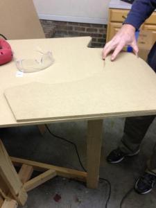

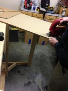

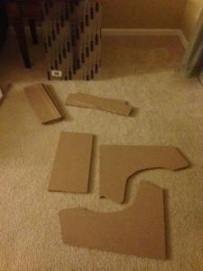

Frosty Posted January 17, 2013 Posted January 17, 2013 After much research and help from the boards I've started my first bartop build. Finished the main cuts last night, and will begin sanding soon. Plan to hopefully complete my cp layout and drill this week...
mikekim Posted January 17, 2013 Posted January 17, 2013 Nice start Frosty. Any idea on a theme yet? Sent from my Samsung Galaxy Note II.
richie_jones Posted January 17, 2013 Posted January 17, 2013 Iike the curve on the botton nice touch..are both sides the same?
Frosty Posted January 18, 2013 Author Posted January 18, 2013 Nice start Frosty.Any idea on a theme yet? Sent from my Samsung Galaxy Note II. Haven't decided yet. Any suggestions? Maybe a frosty theme? ha. Y'all's space invaders theme turned out great btw. Iike the curve on the botton nice touch..are both sides the same? Yeah I have the sides rotated different ways in that pic but they'll generally resemble the design plans that were posted on mike's thread. I will sand them down to match perfect this weekend.

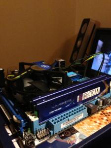

Frosty Posted January 31, 2013 Author Posted January 31, 2013 An update: Gathered my PC components and built the system last night. Loaded Win 7 64 b, but got win 8 pro upgrade from that special Microsoft is running (which ends today btw). May load win 8 later on... Started putting together the cab pieces this past weekend. Need to drill speaker holes, then ill start painting. Finalizing the theme designs to be printed for the sides,etc. Hopefully wont hit too many snags further on! Sent from my iPhone using Forum Runner
monkeychunkuk Posted January 31, 2013 Posted January 31, 2013 An update: Gathered my PC components and built the system last night. Loaded Win 7 64 b, but got win 8 pro upgrade from that special Microsoft is running (which ends today btw). May load win 8 later on... Started putting together the cab pieces this past weekend. Need to drill speaker holes, then ill start painting. Finalizing the theme designs to be printed for the sides,etc. Hopefully wont hit too many snags further on! Sent from my iPhone using Forum Runner all looking good the fun has only just begun!
mikekim Posted February 1, 2013 Posted February 1, 2013 nice motherboard what processor are you running? are you using onboard GFX or a card?
Frosty Posted February 1, 2013 Author Posted February 1, 2013 nice motherboard what processor are you running? are you using onboard GFX or a card? Haha yup, I liked your itx idea. It'll save a good amount of room. Running a 3570k intel. I'm using the onboard hd 4000 gfx for now, but of course after the fact I read people were having odd problems with it running the emu movies on hyperspin ...so Ill see how it goes, may have to add a gfx card later on. Sent from my iPhone using Forum Runner

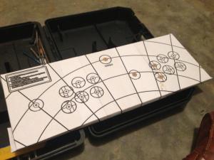

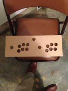

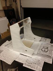

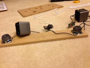

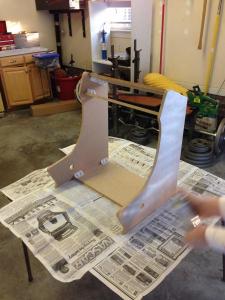

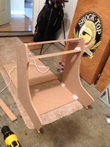

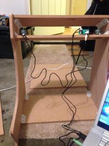

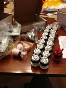

Frosty Posted March 4, 2013 Author Posted March 4, 2013 Finally an update: Thanks again to all the hs members that I've asked questions to, this is a very helpful forum. Drilled the control panel using the vewlix button layout. For sound I decided to go the usb powered route, and got some arctic sound usb speakers from amazon. They are 2 inch speakers but they look and sound surprisingly great in my opinion. I stripped the cases away, drilled, and test mounted them in my speaker bar. They luckily still worked. Assembled the rest of the cabinet for painting. I used plastic joints from ebay (they don't sell them or fixing blocks in US hardware stores i.e. lowes, home depot). As an after thought these could've been substituted for metal L brackets I suppose. The ones I used are too big in some spots so I had to wear them down with a dremel. Yesterday I applied the first and second coats of primer to the cab. I am just mainly focusing on the edges, since the rest will be covered in graphics. Next up will be 2-3 black top coats with sanding in between, then I'll be applying the graphics (that I received from lucian last week !)!

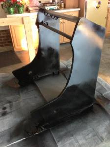

Frosty Posted March 9, 2013 Author Posted March 9, 2013 Yesterday I put the final top coat of black on the cab. Next up: cut the lexan for my marque and monitor screen; apply side art; spray the bezel; Sent from my iPhone using Forum Runner
richie_jones Posted March 9, 2013 Posted March 9, 2013 Frosty..get some glass cut its miles better than lexan...I know its a bit dearer but you put all this effort in go for glass. You wont see lexan in any arcade machine its just not hard wearing enough.
mikekim Posted March 9, 2013 Posted March 9, 2013 +1 as Richie says.. Lexan scratches far too easily.
monkeychunkuk Posted March 9, 2013 Posted March 9, 2013 Yup these guys are right im gonna bight the bullet and get glass for my cabs it just adds that bit of class AND no mater how good you at cutting the perspex its never going to have a perfect finish likw glass.ring round gets some quotes for glass
