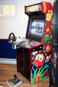

gazsnk Posted January 24, 2013 Posted January 24, 2013 Hi everyone has any one got any ideas to add a steering wheel to play driving games to upright cabinet with joystick and buttons as standard panel, perhaps there is a removable steering mount you can attach easy ,to play your driving games and be easy to remove when not Just looking for ideas dont fancy the wii steering wheel, want a proper wheel with force feedback, may make a stand or something to hold steering wheel Just after ideas or if anyone got a working solution to share. I got no room to make a dedicated driving cabinet Cheers Sent from my iPhone 5 using Tapatalk

gazsnk Posted January 24, 2013 Author Posted January 24, 2013 Yeah that looks smart like the gear shifter would be great for Daytona USA Just need a solution to mount it or put on some sort of stand Sent from my iPhone 5 using Tapatalk

Secret80'sMan Posted January 26, 2013 Posted January 26, 2013 What about the temporary mounting? The missing piece of the puzzle.
Fursphere Posted January 26, 2013 Posted January 26, 2013 That'll be the trick. The G27 is big and bulky, and kind of a pain to mount honestly. Hence the reason I'm building a dedicated driving cabinet for mine...
charlie1212 Posted January 26, 2013 Posted January 26, 2013 I'm using a X360 wheel on my cab. Easy to install and remove.
RidicRick Posted January 26, 2013 Posted January 26, 2013 The good thing about the G27 is the modding. There are so many mods for it and the quality is so good that you can take it apart and make your own mounting solutions for the shifter, wheel and pedals. Plus the force feedback blows away all the cheaper models of wheels, believe me, I have owned, tested, and sent back many of them. Here are some links.. http://chilicoke.com/mods.htm http://forums.atomicmpc.com.au/index.php?showtopic=50423 http://www.ricmotech.com/store/free_logitech_g25_g27_shifter_mod_modification
