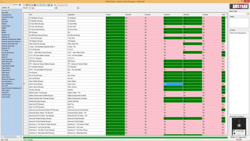

potts43 Posted February 13, 2014 Posted February 13, 2014 All it does at the moment is name them Bezel - Bezel.png
horseyhorsey Posted February 13, 2014 Author Posted February 13, 2014 Yea, if you just pushed OK without changing the text it will do. Then if you do the same again it will be named Bezel - Bezel2.png & so on. Weed Me! HS App: HLM-Check Beta: PinXCheckTunes: http://soundcloud.com/vade/mistys-mind-horse-mix HyperSpin Multiplayer - Take Your Cab online
potts43 Posted February 13, 2014 Posted February 13, 2014 Yea, if you just pushed OK without changing the text it will do. Then if you do the same again it will be named Bezel - Bezel2.png & so on. Ok, but it would be nice to be able to configure it to a personal naming convention. Would it be difficult to implement this? If not that's fine too.
horseyhorsey Posted February 13, 2014 Author Posted February 13, 2014 Name it whatever you like but it will be prefixed to "Bezel - "whatever the text box says" That's a fail safe way by having the "Bezel - " prefix. It's also quick allowing you to just push OK or just enter a name without having to type anything. Like I said , I'll probably change the way game bezels are prefixed but for the _default it will stay. Weed Me! HS App: HLM-Check Beta: PinXCheckTunes: http://soundcloud.com/vade/mistys-mind-horse-mix HyperSpin Multiplayer - Take Your Cab online

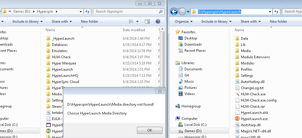

violentsingalong Posted September 4, 2014 Posted September 4, 2014 Hi, horsey.. I'm trying to run this application (pulled off of the FTP today) and am getting an error stating my Hyperlaunch Media folder isn't found. Any idea what this error is about? Thanks in advance!
richakev Posted September 4, 2014 Posted September 4, 2014 Hi, horsey.. I'm trying to run this application (pulled off of the FTP today) and am getting an error stating my Hyperlaunch Media folder isn't found. Any idea what this error is about?[ATTACH=CONFIG]44411[/ATTACH]Thanks in advance! Did you choose the hyperlaunch media folder or just the hyperlaunch folder? I believe it should work if you select the media folder. Sent from my iPhone using Tapatalk

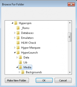

violentsingalong Posted September 4, 2014 Posted September 4, 2014 Did you choose the hyperlaunch media folder or just the hyperlaunch folder? I believe it should work if you select the media folder.Sent from my iPhone using Tapatalk I am choosing the "Hyperlaunch\Media" folder: Any chance that the program requires the folder to be on the C: drive or something? I'm running Win7 64 bit and have tried compatibility mode with XP, still no luck. Based on everyone's replies, it would seem I'm the only one experiencing this issue.. Are there any prerequisites that I need installed besides the obvious HS and HL? Edit: Also, of note: when I press "OK" on the error it takes me back to the folder selection window. FWIW I'm using RDP to dial into the machine remotely. I'll try it sitting in front of the PC when I get home and update with my results.
horseyhorsey Posted September 4, 2014 Author Posted September 4, 2014 I think you're missing some folders from that directory, artwork isn't there for one. Weed Me! HS App: HLM-Check Beta: PinXCheckTunes: http://soundcloud.com/vade/mistys-mind-horse-mix HyperSpin Multiplayer - Take Your Cab online
violentsingalong Posted September 4, 2014 Posted September 4, 2014 I think you're missing some folders from that directory, artwork isn't there for one. Thanks. I'll re-download the media pack and try again.
violentsingalong Posted September 4, 2014 Posted September 4, 2014 I think you're missing some folders from that directory, artwork isn't there for one. That worked. Sorry for getting everyone all excited. My previously downloaded HLMedia file was corrupt and didn't extract everything. Thank you so much for the quick replies!
