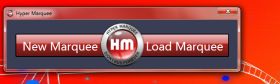

post-23160-0-18713800-1442268479_thumb.pngI have set it up exactly as you have pointed..The program works fantastic. I have missed something because when i start hyperspin i have the HYperMarquee load. Attached is a picture of my screen i have to then hit load marquee the setting file comes up i click on it and everything runs perfect.So my vague question probaly is what have i missed for hypermarquee to load my setting automatically..
attachicon.gifCapture.PNGI have set it up exactly as you have pointed..The program works fantastic. I have missed something because when i start hyperspin i have the HYperMarquee load. Attached is a picture of my screen i have to then hit load marquee the setting file comes up i click on it and everything runs perfect.So my vague question probaly is what have i missed for hypermarquee to load my setting automatically..
Do you have hyperspin open up eds or hypermarquee? From the picture alone tells me directly to hypermarquee which is not correct
Sent from my SM-N900V using Tapatalk
Hi,
HyperMarquee shows this form when the config filename hasn't been initially provided within the CLI parameters or it doesn't exists. In this case, it hasn't been configured within EDS as expected. Please send a snapshot of your EDS or your EDS config file and we will be happy to help.
Cheers,
HyperMarquee & Event Dispatch System
Hi,
Cheers,
