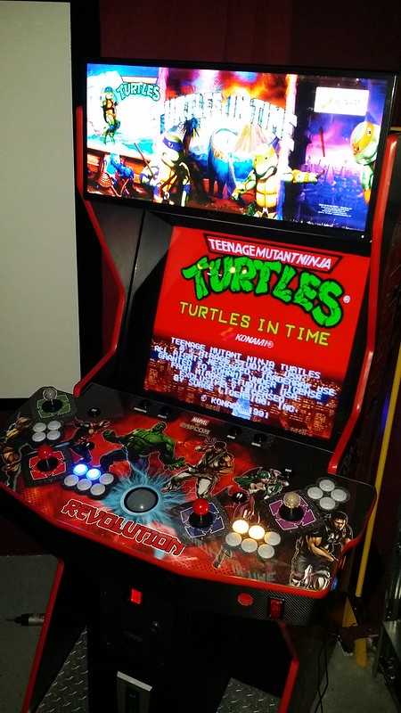

Griffindodd Posted September 2, 2014 Posted September 2, 2014 Looking forward to testing this tonight on my new video marquee build. I do use LEDBlinky to manage all of my button lighting and colors, hoping this will play nicely alongside. MvC Revolution | Identity Crisis 51/32/29 | Little Ms. Pac-Man | Paperboy: Exclusive Edition
Griffindodd Posted September 3, 2014 Posted September 3, 2014 Looking good so far... Originally I set up HyperLauncher to run HyperMarquee via the MAME AHK and then I finally got the EDS server up and running. Now I have EDS do I still need the modified MAME AHK in HyperLauncher or can I take that out again?? MvC Revolution | Identity Crisis 51/32/29 | Little Ms. Pac-Man | Paperboy: Exclusive Edition
Antos Posted September 3, 2014 Author Posted September 3, 2014 Looking good so far... Originally I set up HyperLauncher to run HyperMarquee via the MAME AHK and then I finally got the EDS server up and running. Now I have EDS do I still need the modified MAME AHK in HyperLauncher or can I take that out again?? Thanks for the video, plus your cab is an awesome piece of art! HyperMarquee using EDS doesn't requier any other piece of software to run. So you do not need any ahk scripts to manage your marquee. Understanding that HyperLaunch is an excellent app to manage everything on the emulation side. Thanks for testing HyperMarquee & EDS. Do not hesitate to submit bugs or simply improvments ideas. HyperMarquee & Event Dispatch System
