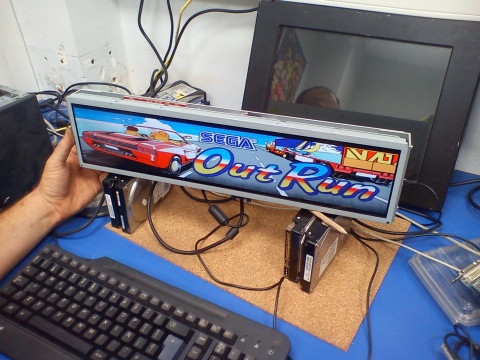

ninja2bceen Posted November 9, 2014 Posted November 9, 2014 Wow What size monitor is the marquee? Can u buy monitors at that shape? Never seen anything like this Advance the cause to 100%. http://hyperbase.hyperspin-fe.com/ Planet Geekdom, Subscribe for Tutorials! https://www.youtube.com/channel/UCdcby-s2GwriaOHGmVC2vGA?sub_confirmation=1&app=desktop
Antos Posted November 9, 2014 Author Posted November 9, 2014 WowWhat size monitor is the marquee? Can u buy monitors at that shape? Never seen anything like this http://forum.arcadecontrols.com/index.php?topic=115898.0 HyperMarquee & Event Dispatch System
klizine Posted November 9, 2014 Posted November 9, 2014 http://forum.arcadecontrols.com/index.php?topic=115898.0[ATTACH=CONFIG]46614[/ATTACH] Antos I didn't see a link on that thread of where to buy...but that looks exactly like what I want!!
Antos Posted November 10, 2014 Author Posted November 10, 2014 Just sharing an early alpha testing of the HM Version 0.4.0 that sevenseal graciously accept to made. We are testing and debugging together currently. Looks good so far. We will be happy to keep you posted we some more soon! https://www.youtube.com/watch?feature=player_detailpage&v=t16KCBv8OU0 HyperMarquee & Event Dispatch System
ninja2bceen Posted November 10, 2014 Posted November 10, 2014 So these aren't for sale yet, the 22 inch marquee LCD? If so where? I think these are like 1 k. U can get them refurbished though for 300-500 bucks. Lg m2900 stretch monitor is all I can find http://www.legendmicro.com/store/9693_LG-Flatron-M2900S-BN-29in-LCD-Monitor---176---Stretch-Screen---1366-x-480---DVI---VGA--M2900S-BNAUS.lmsp?RID=23&gclid=CNCQ1o727sECFQooaQodmpgA2A Advance the cause to 100%. http://hyperbase.hyperspin-fe.com/ Planet Geekdom, Subscribe for Tutorials! https://www.youtube.com/channel/UCdcby-s2GwriaOHGmVC2vGA?sub_confirmation=1&app=desktop
