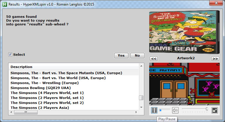

potts43 Posted March 24, 2015 Posted March 24, 2015 Would it be possible to have the game vids play when you select an item from the initial search results like in the old hypersearch ?
r0man0 Posted March 24, 2015 Author Posted March 24, 2015 Would it be possible to have the game vids play when you select an item from the initial search results like in the old hypersearch ? Not exactly , but i'm going to integrate video and artwork preview , into popup result. r0m@n0
r0man0 Posted March 27, 2015 Author Posted March 27, 2015 No, for the function listview, this option is not possible with autohotkey language.r0m@n0 Hi , i've found an issue to add to the listview a video preview for just one item selected. I think it's a good idea to add this feature , so i'm working to new version in order to enable it. I will also add preview artworks , and add new columns to listview for artworks and videos. The video preview will need activex plugin from vlc (vlc 2.0 or higher version must be installed to works) This next version will arrive soon : R0m@n0
potts43 Posted March 27, 2015 Posted March 27, 2015 Hi , i've found an issue to add to the listview a video preview for just one item selected.I think it's a good idea to add this feature , so i'm working to new version in order to enable it. I will also add preview artworks , and add new columns to listview for artworks and videos. The video preview will need activex plugin from vlc (vlc 2.0 or higher version must be installed to works) This next version will arrive soon : [ATTACH=CONFIG]52444[/ATTACH] R0m@n0 Awesome!
r0man0 Posted March 29, 2015 Author Posted March 29, 2015 Hi , a new version have been added on main post : +02/25/2015 - Fixed --> HyperXMLspin ini file will now be named "HyperXMLspin.ini" instead of "HyperSearch.ini". +02/25/2015 - Fixed --> Optional (3) "Parental Filter" works well. +03/05/2015 - Fixed --> Caracters not allowed on save name +28/03/2015 - Fixed --> New windows centered. +28/03/2015 - Added --> Game name for 1 result. +28/03/2015 - Added --> Columns : Theme,Video,Artwork1,Artwork2,Artwork3,Artwork4 et Wheel. +28/03/2015 - Added --> Video preview Option (need VLC 2.0 or higher) and artwork preview. r0m@n0
