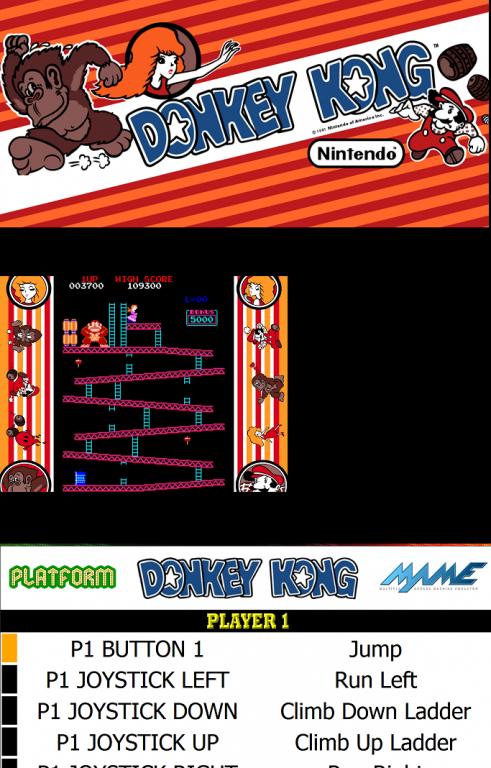

Ok so I thought for sure it was going to be because my Marquee was monitor 3. I was like yeah that will fix it for sure. I had some DVI vs VGA issues with DVI taking control and naming itself monitor 1. So I had to switch every thing over to VGA so I could get the monitors to have the correct numbers in the windows resolution settings.
I have always had my HS resolution set to 800x600 with full screen off. Like I said I have read threw all 50 pages of this post twice. I have tried every thing. Can you think of any other places other then the HS settings and emulator settings that may need to be changed to 800x600? So this is what I did this morning after reading your last post.
I went and changed the #'s in the HSH settings D=1 M=2 C=3. Shut the computer down and unplugged all the monitors except for the main display 800x600. Started it up to be sure it works with the one screen. Every thing was good to go. So I shut it down and plugged the marquee monitor in and restarted it. Checked the resolution settings 1360x768 and screen placement with windows. Every thing was good. Tested with HSH and the game and marquee all works just fine. Looks great. I love this program. Thanks again! Then I shut it all down and plugged in the 3rd monitor and restarted it. Controls monitor is set at 1366x768 and placed below the main screen. At that point the desktops all look good. I start HSH and then the marquee image shows up but its shoved up past the top frame of the monitor. You can see about 2" of blank screen at the bottom of the marquee monitor. The middle screen or Display screen works great. Every thing fills the screen and the game loads just fine. But then the 3rd screen for the controls has a area at the top of the screen about 2 to 3 inches that you can see the desktop image. The controls image loads but its way too big for the monitor. The image is lined up on the left edge of the screen but it goes way off threw the right side and the bottom edge of the monitor. You can mess with the windows settings placement of the windows and it just moves the gaps of missing area around.
I thought maybe it was the resolution settings on the controls monitor? So I tried every setting and I got the same results with slight variances of the empty gaps. I have tried every thing I can think of to try to get this to line up correctly. If you have any ideas please let me know. If you want I can put a quick video together to show you what its doing. I can also post what ever logs you may need. Just let me know what you might want to see.
I hope I was able to explain every thing ok. Please let me know if you have any other questions. I did have the marquee and display working great for a couple of weeks before I got the 3rd monitor. So I can only think it might be the monitor. I changed that out with another one and still the same results.
Thanks again for taking the time to create this cool must have program for arcade systems. Also a big thanks for taking the time to help us out with crazy questions and stuff. Thanks man...

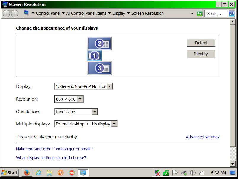

There aren't any settings for the resolutions. The program reads it from windows. Can we get a screenshot of your display settings from windows?
Info on HyperspinHelper Software: http://hyperspinhelper.wordpress.com. Allows you to enable two additional displays as a Marquee and a controls help screen as well as map UltraStik 360 controls. Works exclusively with Hyperspin.
Sorry on the hyperlaunch log I think that's normal. It is showing it as an offset to the main window. Still a screenshot may help.

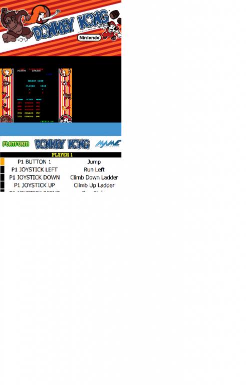

Can you see the bottom of the control screen is cut off? It also has about a 2" section at the top of the Control screen that shows the desktop image.
I changed the Desktop background to blue and redid the screenshot so you can see the desktop showing.
It works great with just 2 monitors. The Display and the Marquee. But as soon as I try to add the 3rd screen it get all weird.
Do you think I need to try to reinstall all of HyperSpin again? I just updated every thing last month so I don't that that should do any thing but you never know? Any ideas?
Thank you very much for your time.
Weird. Settings all look right. I don't think a re-install will help at all. In windows Try making the marquee image the bottom screen and the controls the top and see what it does. Then keep it that way and try changing the numbers for each in the settings and sees what that does. It will just make the mouse a little hard to use.
