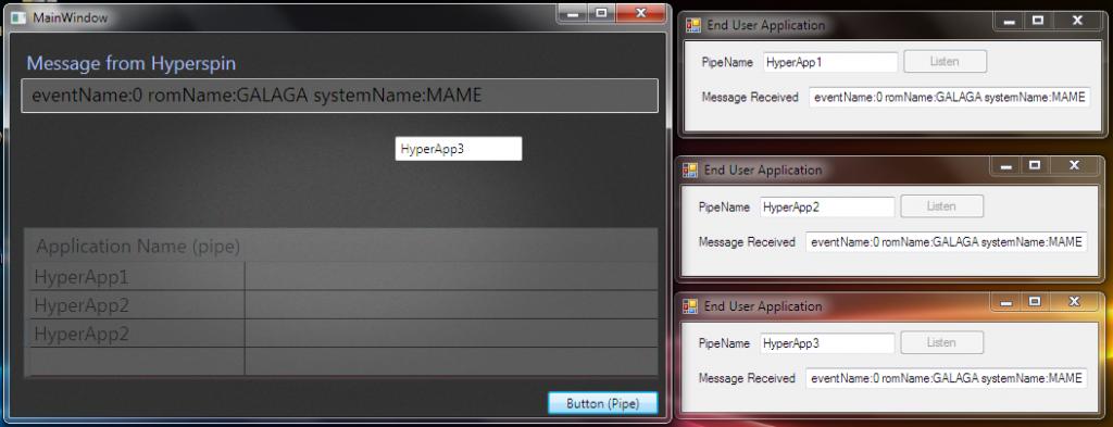

Got it & did it!!! Very dirty for now, but the concept seems to work fine.
Here is a proof of concept of a Hyperspin Events Dispatch System (EDS).
Using Pipes.
How it works,
1. HyperSpin calls the EDS (left form with the grid) - need to rename EDS by LEDBlinky
2. EDS send messages (asynchronously) to all systems. Systems that you have earlier specified, in order to send hyperspin events to them (need to add a listener to your app - sample code will be provided)
3. EDS is closing after sending messages (ie Hyperspin event)
4. You application can use what as been asynchronously received.
