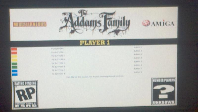

Well I tried everything I could think of and still can't get a controller image to show on the controller screen. Is it supposed to show in the blank spot between the rating graphic and the no. of players graphic?
I also see in the settings file, that it states that the show controller image is always active and that the settings "true" "false" do not work. Could this have been turned off in the main program instead of on?
Here's a shot of the control screen for an amiga game. There is a control image in the file. I even renamed one for mame just to see if it would show up.
This is a really great program, I can't wait to get it all going.
Yep. Between the two icons on the bottom should show the controller image. But you have to make sure you have one for the rom (Same name). Otherwise it should default to one for the emulator. None are included for mame.

Ok settings is correct. Now #2 do you mean: hyperspinhelper\images\controls\[system name].png/
If this is right, than this is how it is setup.
No. Just working from memory since my PC still isn't set up. What in each of those directories above? Does NES or SNES work?

#1 is not active, I haven't done anything with roms yet.
#2 Are the default images that came with hyperspinhelper.
So following your instructions it should show the system controller images, out of the box. Right? Or do I need to make a folder as in #1 even though its empty.
I haven't set up snes or nes
There are not images for the systems like mame where the controllers are different out of the box. You have to add the images manually.

Yes I know, If you look at the screen shot, it is the Amiga. I also tried playstation and 3d0. All three of these have system images.
edit:
Made a controls folder in the hyperspin media folder for the amiga " [hyperspin folder]\media\[emulator]\Images\Controls\[rom name].png" and made a control image for the 1943 rom. Still did not show any image on the control screen.
Well I decided to start over with hyperspinhelper. I deleted all the files and reinstalled the program. Only changes I made was turning off the mauquee screen and changing the control screen to monitor 2. Both main monitor and control monitor (7") are set to 1280x768.
3DO control screen now shows a system control image. Yeah!
I made a system image for Daphne. named it daphne.png, stored it in the same folder as the 3DO control image. It does not show up. Now I just have to find out what is different between the two.
I just tried it on my system. Works fine by just adding the image. Double check for a typo? Should work for mame too.

Thanks for bearing with me, I got the system control images to show up on all the emulators I have setup so far but Mame and daphne. Even if I rename one of the other system control images, these two just wont work. How did you get them to work? What size images. I named the images Mame.png and daphne.png.
I just renamed one of the existing. I don't believe it is case sensitive but I do have the case matching. (MAME and Daphne). The only other thing it could be is that you have HSH installed twice and are running it from one location but changing images in another location. I assure you it works and there is nothing in the code that excludes mame and daphne. I just didn't include generic images for those are there are none.
