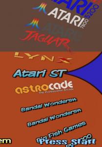

Polemicist Posted November 16, 2013 Posted November 16, 2013 I can't get the same failure. But I have a lot of wheels that have nothing in them as mine is a testing work in progress setup with 93 systems in HyperlaunchHQ and currently setting up and testing every single emulator in creation. Don't even get me started on how many single games I am downloading just to test systems. *sighs* But yeah I can't get that failure. But my setup doesn't constantly play videos due to my wheel having blank systems example In my letter A my Atari ST isn't done yet. Work in progress due to the Hyperlist database having an empty DB listed in the Unofficial XML files. and as you can see I'm still going. *chuckles* Very weird. I will freely admit that the new version when left running heats my laptop up much more than the old version and since the old version plays videos constantly it is not a video play back thing. I need a failure to look into this more. Worst thing that has happened so far is a single crash after opening and closing it repeatedly during testing. Issue was caused by second instance of HS running and not closed out after opening a non functioning emulator.
