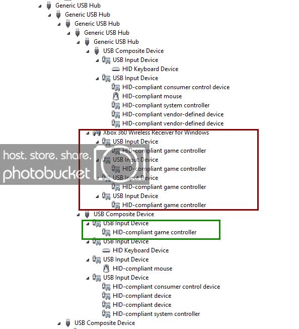

First, connect all your controllers. Then open up device manager and go to View > devices by connection. In the new list below, find your controllers and expand them.
As long as your preferred controllers are above the others, then you are halfway there. The only way to get these in order is by changing the USB ports.
Here is my device manager. As you can see, the Xbox Wireless Adapter is above the other USB input devices (in this case my Dolphin Bar).
Ok, here is what I've got--- to me it looks like the xbox hub is listed after the arcade stick--- I'm guessing the arcade stick is the one I put the green box around?
Yes. So in this case, you want to jig around the USB slots so that the Xbox controller is higher. Otherwise you'll have the controllers move position each time you connect the arcade sticks.
Ah, gotcha--- ok, I have the xbox wireless in the higher position now.
