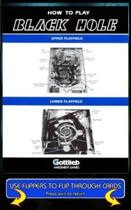

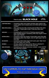

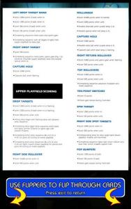

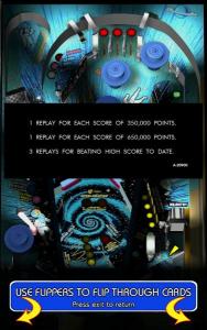

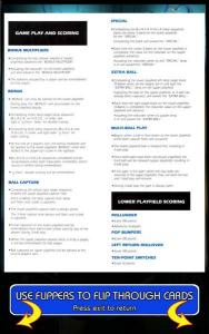

  6. exit and pausekey are for exiting (from game, from exit menu, from image) exit2 and exit3 are for entering into something in menus here is an example of how instructions should be used. game is black hole first thing you do is search ta's excel file for 5 balls and replay levels instructions (i don't like 3 ball games) then i searched inkochnito rules and replay scores and found what are replay score levels for 5 ball game then i set 5 balls per game and replay levels following ta's instructions then i cut rules card and replay card from inkochnito pdf and save it as jpgs then i go to ipdb and get how to play guide - looks like flyer but it is not flyer - flyer is 2 pages and this is another 3 pages so i put rules card, replay scores card and 3 how to play images to instr. cards folder with names black hole (... irrelevant).jpg, black hole (...) 1.jpg, 2, 3, and 4.jpg and here is the result, it's very handy while you play for checking what do you have to do:

  8. here is the new version 1.295 wip 7: http://www.mediafire.com/?18rrjdysjcdeo6j not much news except memory leak bug fix and support for many swf and image files for instructions so whatever you put in media\hyperpin\instr. cards will be shown you can put swf or img of rules, replay scores, play guide, manual, anything supported formats are swf, bmp, jpg, png, gif, ... pdf, doc or rtf is not supported for images/swf order since windows is sorting files funny so if you have file 1, file 2, file 3 and file file will be last on the list - so when we start browsing instructions i first show last one. since many tables have many cards to choose from - you will see them all, untill you move them somewhere it's up to comunity now to build some meaningful cards to show while in game

  17. forgot to say - all images are there in zip file, just move them to media\hyperpin\images and one pixel offset bug is fixed also
