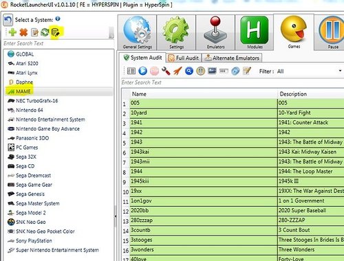

  2. TIP #3 - Filters and Databases As covered in TIP #1, all launching is to be done by RL so this window in HQ can usually be left blank. "HyperLaunch" (that now points to RL in settings.ini) should almost always be selected. NEVER set an "Executable" here unless you plan on bypassing RL altogether and setting "Execution" to "Normal". You do however have to include a "Rom Path" and "Extension" whenever you use the "roms only" filter in HQ. Roms only is a popular choice for new comers. Simply delete any rom you don't want and it will vanish from the wheel. If you want to add a game or simply have more control over what is and isn't in your XML's, then you will need to get used to editing them yourself. They are just simple text files that are editable in any word processor including the Windows included "Notepad". Notepad has some kind of size or character limitations though so some of the bigger databases like Mame might not even open. It also does not retain the original formatting of xml. Fortunately there is a freeware program called "Notepad++" (plusplus) that has several benefits. You can get it here: https://notepad-plus-plus.org/downloads/ Fire up RLUI and tell it where you just installed notepadd++ Now you can click on the "edit" button in RLUI: You can have more than one XML open. And it will remember which databases you have open. Which is saved or not:

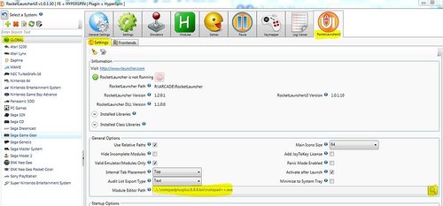

  4. The rest of this thread will be tips and/or otherwise handy information. The thread is locked so if you have any questions, please PM me. TIP #1 - Connecting HS and RL This is really "day 1" stuff. This is the very first thing you should do after downloading a fresh HS and RL and placed them where you want to run them from. Navigate to .../HyperSpin/Settings/ and edit the "settings.ini" like so: You'll notice that the path to the old "hyperlaunch" was just a path to the folder. The path to RL must point right to the exe! Also note that in this example, I am using drive z:, replace with you own drive letter (path) of course. Next, you'll want to open RLUI and make the following changes here: And here: These settings will ensure that RL knows that HS is your frontend. Very important that RL knows what program to give "focus" to after exiting a game. This setup uses the databases from the HS folder structure. Now technically, there is a way to use RLUI as the plugin and it will use the databases in the RL folders. This can be handy if you want to use more that 1 frontend... but it has it's issues. Like most 3rd party apps expecting to read from HS like Hypersync! Hypermarquee, Hypersearch... It's a much better idea to finalize your XML's in HS. You can always copy them over to the RL folders after you done for future use. You should now be fully connected. Launching through HS should be exactly the same as launching through RLUI. From this point forward, that's all HS does is "call" RL.
