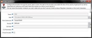

Systems: Nintendo 64
Status: last update 2012
Basic Setup
1.) Download both r106 and r146 here.
2.) Create a new folder in your emulators folder called 1964.
3.) Create an emulator version folder inside that folder. The latest version at the time of this tutorial is r146
4.) Extract or install the contents of r106 to the new folder you created above. Your path to 1964.exe should now be
C:\HyperSpin\Emulators\1964\r146\1964.exe
5.) Extract or Install the contents of r146 to the same folder as you did r106. Overwrite everything. This installation method is because the r146 install is missing some files that r106 has.
6.) Now double click on the 1964.exe. You should receive a popup asking where your roms are. Point them to your rom folder. If you've followed this guide they will be in
C:\HyperSpin\Games\Nintendo 64
7.) Open HyperLaunchHQ, Highlight Global in the systems panel and then click on the big tab emulators. Find 1964 in this list and double click on it. Now set your path and fill in the rest of the settings
8.) Now highlight Nintendo 64 in the system panel. Click on the big tab Emulators and then add the path to your Nintendo 64 roms to the rom paths field. You can do this by clicking on the smaller green plus button to the right of the rom paths field.
9.) Now set 1964 as your default emulator by clicking on the magnifying glass to the right of the default emulator field and selecting 1964 [Global] in the popup window.
10.) Don't forget that you can edit module settings by highlighting the module in the modules tab and clicking the edit global module settings button.
Advanced Setup
FAQ
Edited by ghutch92

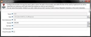

Systems: AAE
Status: Inactive? (2008)
Basic Setup
1.) Download the AAE alpha Binary and Update #2 from here.
2.) Create a new folder in your emulators folder called AAE.
3.) Create an emulator version folder inside that folder. The latest version at the time of this tutorial is 12_13_08
4.) Extract or install the contents of the AAE alpha binary download to the new folder you creates in step 3.
C:\HyperSpin\Emulators\1964\12_13_08\aae.exe
5.) Extract or Install the contents of update #2 to the same folder as you did the alpha binary download. Overwrite everything.
6.) Open the aae.ini in notepad. This file is in the same folder as aae.exe. Now remove the # in front of mame_rom_path and set the path to your MAME roms or your AAE roms if you separated them (Example: mame_rom_path = C:\HyperSpin\Games\AAE).
7.) Open HyperLaunchHQ, Highlight Global in the systems panel and then click on the big tab emulators. Find AAE in this list and double click on it. Now set your path to aae.exe and fill in the rest of the settings
8.) Now highlight AAE in the system panel. Click on the big tab Emulators and then add the path to your AAE roms to the rom paths field. You can do this by clicking on the smaller green plus button to the right of the rom paths field.
9.) Now set AAE as your default emulator by clicking on the magnifying glass to the right of the default emulator field and selecting AAE [Global] in the popup window.
10.) Don't forget that you can edit module settings by highlighting the AAE module in the modules tab and clicking the edit global module settings button.
Advanced Setup
FAQ
