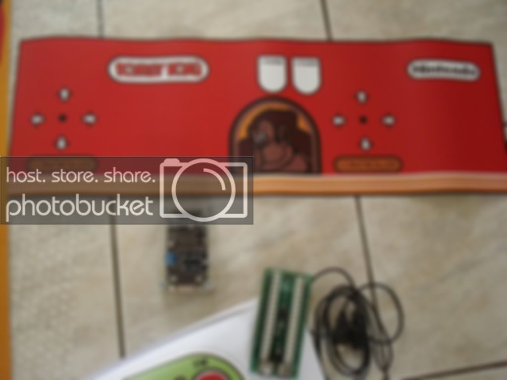

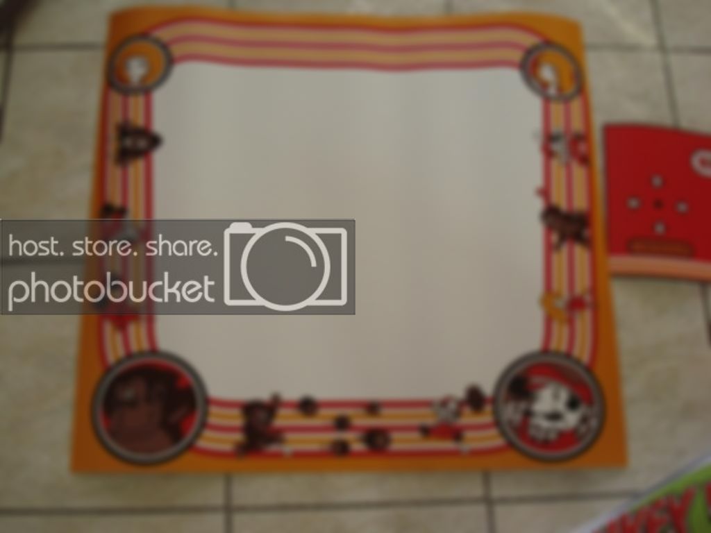

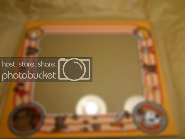

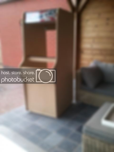

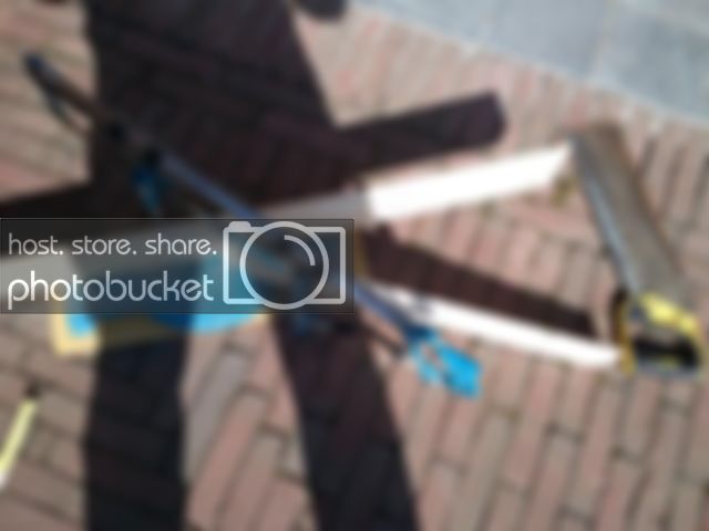

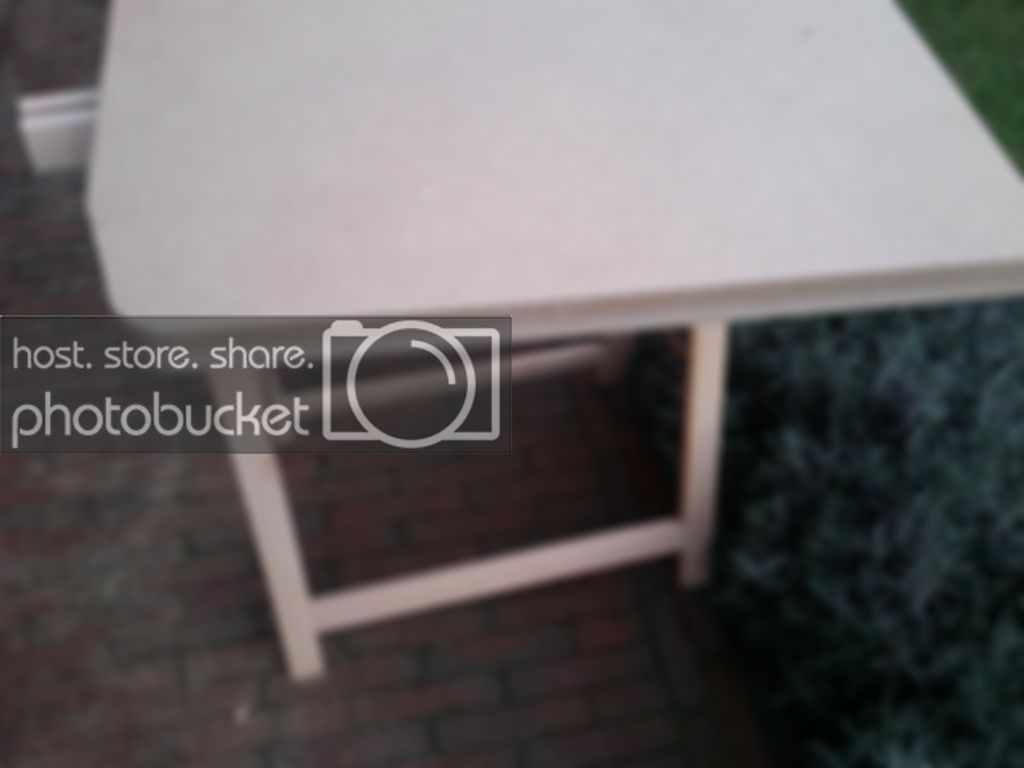

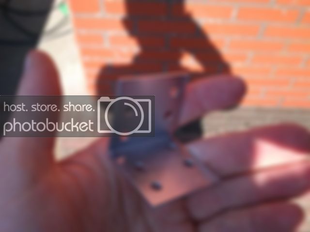

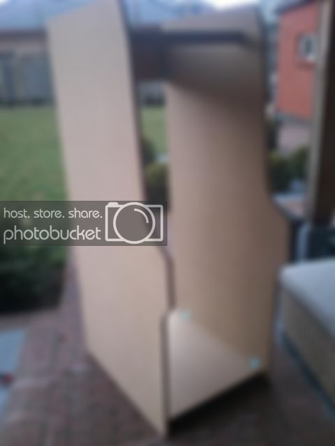

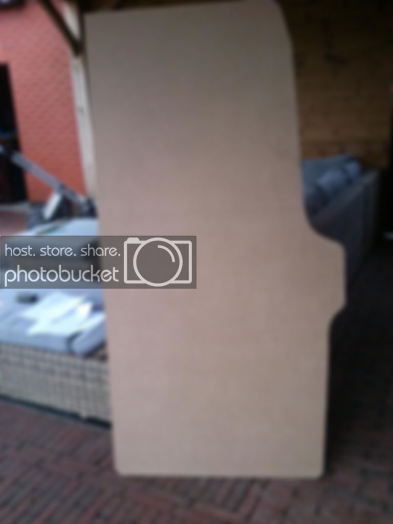

nicke36 Posted April 2, 2013 Posted April 2, 2013 Hello , My name is Nick 29 years old (from belgium) i am new on this forum and this is my first build so here we go First i found a plan on the internet i got one from jacobud. after a lot of mesurements and calculating i got my plan finished. it looks pretty good i think side art colors seems to be off but thats my camera irl it looks mutch better i go with an lcd screen , so i ordered a slg3000 better shot of the bezel (what you see on the glass is reflection of light) putting the cab together with some L brackets works very good the strip you see in front is just to hold the cab together , will be removed later cutting the base and put it together with a needle pistol (dunno how you call it in English ) now i needed to get a router and routerblade i get a new one , i will use this for other projects too. finding the routerblade was more difficult i went from shop to shop and finally found one. do a testcut and fit Perfect makes a lot of dust but it looks awesome I am very happy with the results so far , next step is putting the cab more together but i dont have mutch time atm so i will see when i work back on it grtz

markelhombre Posted April 3, 2013 Posted April 3, 2013 Nice! About the artwork, is that custom? Or did you find it?
rdhanded2 Posted April 3, 2013 Posted April 3, 2013 Great start! Looks good My Tekken 3 pedestal conversionBasement Bar / Arcade
nicke36 Posted April 3, 2013 Author Posted April 3, 2013 thx guys, About the artwork , i sent the artwork files to an online printing store and let them printing it turned out really good, costs me half the price incl shipping than i order it from mikes arcade , gameongrafix..... because i live in Europe i dont want to pay that mutch shipping costs
markelhombre Posted April 3, 2013 Posted April 3, 2013 Cool! Can you tell me which site that is? Is it laminated?
nicke36 Posted April 5, 2013 Author Posted April 5, 2013 Cool! Can you tell me which site that is? Is it laminated? pmed you

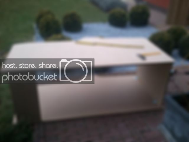

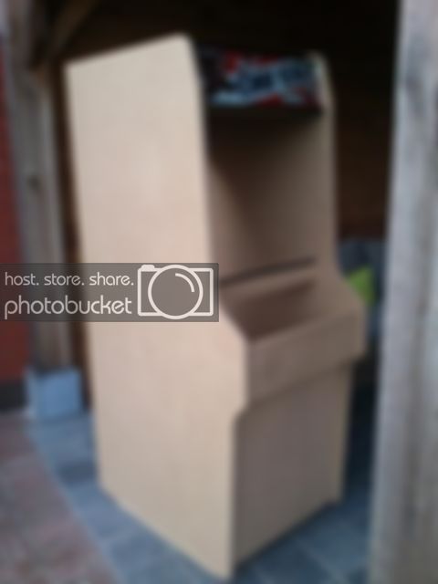

nicke36 Posted April 5, 2013 Author Posted April 5, 2013 what do you guys think? put the cab together and start painting or take the pieces apart and painting?
rdhanded2 Posted April 5, 2013 Posted April 5, 2013 separate will paint better, so I would do that if you have the room. Just be careful in the reassembly process not to scratch it. My Tekken 3 pedestal conversionBasement Bar / Arcade

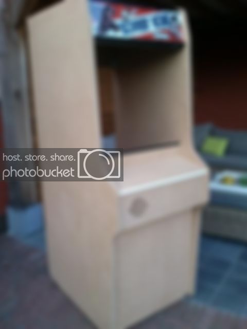

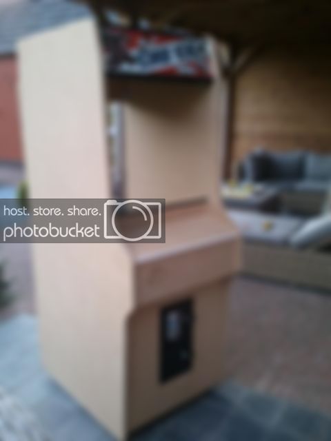

nicke36 Posted April 17, 2013 Author Posted April 17, 2013 small update marquee testfit perfect:) speaker grill cutt out grtz

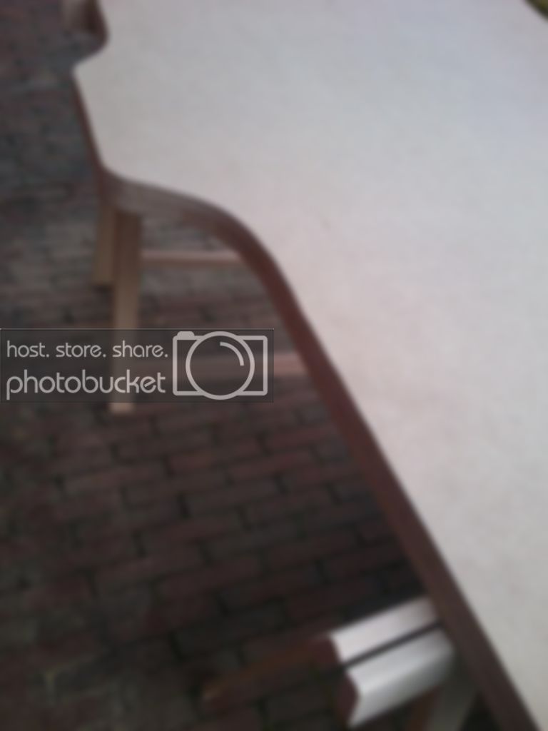

nicke36 Posted April 29, 2013 Author Posted April 29, 2013 Little update control panel fit and t molding for the panel placed buttons joysticks and coindoor will be here this week

nicke36 Posted May 2, 2013 Author Posted May 2, 2013 coindoor placed Not original they are very dificult to find here in europe i even never saw a DK cabinet irl over here :-D But this one is OK for me
