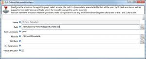

dsync89 Posted July 19, 2015 Posted July 19, 2015 On 7/18/2015 at 7:03 PM, mccorkled said: I did not install the game using dfend because it is already installed with dosbox. The game works fine when I play it but I am still having trouble getting it to load automatically. I made the config file and put this in it... imgmount d Z:\Hyperspin\Emulators\Microsoft MS-DOS\ROMS\Stonekeep\Stonekeep.iso -t iso c: cd stonkeep sk When I try to load the game in hyperspin I get this error I then added in the emulator information into RLUI and now I am getting this error. You're almost there now. Just add an additional prof to your D-Fend Reloaded emulator in the Rom extension and you're good to go. By the way you should only need to add the prof extension since that is the only input that D-Fend Reloaded requires.

mccorkled Posted July 19, 2015 Author Posted July 19, 2015 On 7/19/2015 at 6:58 AM, dsync89 said: You're almost there now. Just add an additional prof to your D-Fend Reloaded emulator in the Rom extension and you're good to go. By the way you should only need to add the prof extension since that is the only input that D-Fend Reloaded requires. ScreenHunter_34 Jul. 19 14.56.jpg I did that and now I am getting this error... Aeon Nox XIII Themes Minted Cases w/ Reflection : Minted Cases : Minted XMLs

dsync89 Posted July 19, 2015 Posted July 19, 2015 On 7/19/2015 at 4:33 PM, mccorkled said: I did that and now I am getting this error... Okay that should be a simple fix, all you need is the "DOSBox DOS.prof" file, which I attach here. Simply copy it to the Confs folder and you should be fine. http://www.fast-files.com/getfile.aspx?file=95533
