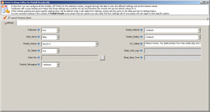

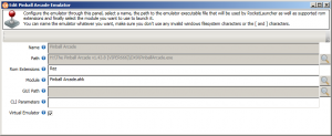

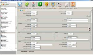

demonseed Posted December 22, 2015 Posted December 22, 2015 Ok So I did some more testing.. in HS.. it loads to Pinball Arcade, hit start and it seems to go to the game I picked.. but within Pinball arcade.. is this correct? or should it boot to the game directly. I have attached photos of my settings. Also Where do I find all the artwork?
Metalzoic Posted December 22, 2015 Author Posted December 22, 2015 On 12/22/2015 at 4:47 AM, demonseed said: Ok So I went back and double checked. I had pointed to the wrong rom folder? or do I not do that? The games are now listed under games but all red. when I click a game Pinball arcade now loads but not into the game. I will double check what I have done but I think i did it correctly. I'm not even sure what you mean. None of that sounds correct. None of that is in the tutorial. There is no roms folder at all. EDIT: Yes the tables will be listed in red in RLUI because there are no roms to match to them. That is normal.
Metalzoic Posted December 22, 2015 Author Posted December 22, 2015 On 12/22/2015 at 4:55 AM, demonseed said: Ok So I did some more testing.. in HS.. it loads to Pinball Arcade, hit start and it seems to go to the game I picked.. but within Pinball arcade.. is this correct? or should it boot to the game directly. I have attached photos of my settings. Also Where do I find all the artwork? Yes that sounds like how it is supposed to work. You pick your table from the wheel in Hyperspin. It launches The Pinball Arcade and you can see the module navigate through the game menus, pick your table and give you back control to actually start playing that table. It doesn't launch from Hyperspin straight to the table as Pinball Arcade doesn't support that optoion.
