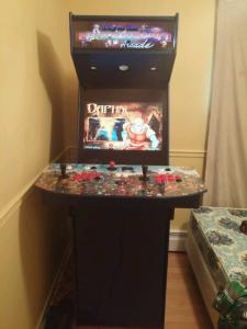

danwelsh Posted October 22, 2015 Author Posted October 22, 2015 All done! ....now time for a hyperspin setup...... I'm lovin my arcade
drewjbx1 Posted October 23, 2015 Posted October 23, 2015 Very nice, makes me wanna do a full size cab.... Like you said onto hyperspin, the much more time consuming part! Sent from my iPhone using Tapatalk

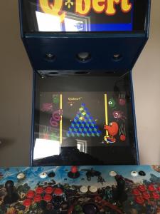

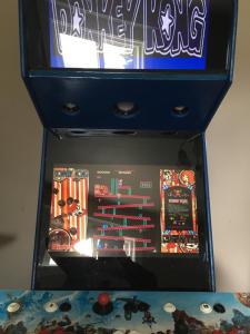

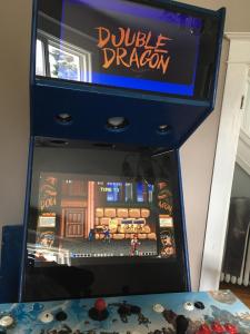

danwelsh Posted May 17, 2016 Author Posted May 17, 2016 A few pics with the cabinet modified to accommodate hyper marquee...just had to do it lol I'm lovin my arcade

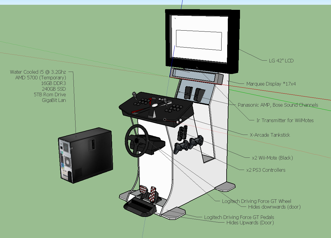

HardRom Posted May 23, 2016 Posted May 23, 2016 Newb here. Making slow headway though. Here's my design that I'm working on. Still working through a LOT of bugs, software wise. i.e. Controller setup, Steam issues, marquees sometimes load, othertimes not. https://3dwarehouse.sketchup.com/model/095b7528-e4b0-41ef-8aae-a5fa2a296ff6/Custom-Arcade-Cabinet-V3
Metalzoic Posted May 23, 2016 Posted May 23, 2016 Interesting. Kind of a pedestal, but with the screen attached. I'd recommend not using a Tank Stick though and building your own CP with an encoder. Probably save you some headaches and look much better. What are your Steam issues?
HardRom Posted May 23, 2016 Posted May 23, 2016 Yeah, screen is also on a floating mount too- so when you sit to race, the screen comes forward and down (so you can see). I'm not competent enough with my current skillset to build a control panel, but I do plan on heavily modding my tankstick with graphics as well as moving the Player 1/2 buttons (who thought right in front of the trackball would be good???). Steam doesn't like to launch for me. I have a few games installed on this terminal, but most aren't and am using inhome streaming. Regardless, not one game will launch from HS. On a side note, I got my steering wheel setup to work with home streaming by installing Usb Redirector (PITA, to be honest). HSHelper sometimes loads, others not. (Set to load on start in HyperHQ) On top of that, I don't understand why I don't have any other marquees- only the custom png I made shows. Many problems, but luckily lots of time. edit: To clarify, none of the items on my screenshot are wishlisted- I have them all and am working on wiring layouts and such in the background. https://3dwarehouse.sketchup.com/model/095b7528-e4b0-41ef-8aae-a5fa2a296ff6/Custom-Arcade-Cabinet-V3
Metalzoic Posted May 23, 2016 Posted May 23, 2016 Are you building it so the screen also rotates for vert and pinball? I imagine so as that's one of the big benefits to going with this style. I've never heard of HSHelper, nor do I launch anything from HyperHQ so I can't help you there.
HardRom Posted May 23, 2016 Posted May 23, 2016 Yes, the mount allows for 90degree rotation as well. Luckily, the monitor itself only weighs 9 pounds, so it'll easily do the switch also. HSHelper - HyperSpin Helper = Marquee https://3dwarehouse.sketchup.com/model/095b7528-e4b0-41ef-8aae-a5fa2a296ff6/Custom-Arcade-Cabinet-V3
madhatter3339 Posted May 23, 2016 Posted May 23, 2016 Ok HardRom I'm not trying to be negative but you said you are not competent enough with your current skillset to build your own control panel but you want to take on a build like this with folding doors to hide wheel and pedals??? I worry for you!! The control panel is the easiest part aside from the wiring part which always sucks!! Good luck to you and don't be afraid to ask for advice as I feel youre going to need it!!
HardRom Posted May 23, 2016 Posted May 23, 2016 Woodworking is easy, running wires is easy. Setting up and wiring a button panel so it doesn't light on fire and/or kill a parakeet? Not my forte. Already have the folding doors built, got the track sliders and mounts. https://3dwarehouse.sketchup.com/model/095b7528-e4b0-41ef-8aae-a5fa2a296ff6/Custom-Arcade-Cabinet-V3
32assassin Posted May 23, 2016 Posted May 23, 2016 Newb here. Making slow headway though. Here's my design that I'm working on. Still working through a LOT of bugs, software wise. i.e. Controller setup, Steam issues, marquees sometimes load, othertimes not. this is very nice, but why would you add a tank stick? this is like building a Super Car and adding a Volkswagen bug engine.
HardRom Posted May 23, 2016 Posted May 23, 2016 this is very nice, but why would you add a tank stick? this is like building a Super Car and adding a Volkswagen bug engine. I guess I'll take this as friendly pretentiousness ? There's no guide I found prior to me starting this project that says Buy This. Then That. Then all your magical dreams will come true. I bought a tankstick so I could play golf, fighting games, pinball. THEN I decided to actually look into a frontend/cabinet/hardware. I just wanted to play some classic games that I'd meticulously moved and backed up over the last 10 years or so for reasons that never came to light until I started with HS. But... thanks? https://3dwarehouse.sketchup.com/model/095b7528-e4b0-41ef-8aae-a5fa2a296ff6/Custom-Arcade-Cabinet-V3
32assassin Posted May 23, 2016 Posted May 23, 2016 I'm not trying to belittle your choices, after all its your cab do what you want with it. A tankstick as its advantages, but it also has allot of limitations; when it comes to trying to control multiple emulators. if you have the skills and tools to make such a unique cabinet. Why would you would settle for the limitations of a tankstick. A custom controller is going to look better but it will also fulfill all your functional needs.

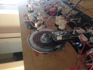

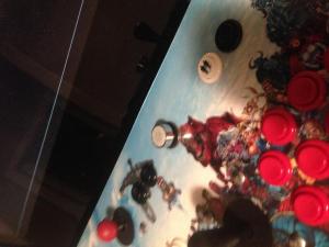

danwelsh Posted August 17, 2016 Author Posted August 17, 2016 Spent the last 5 days making a spinner control....used a deathadder old gaming mouse, I went through 4 different mice trying to get this spinner working and finally today finish it up, custom knob I did myself.....arkanoid is actually more fun now I'm lovin my arcade
Metalzoic Posted August 17, 2016 Posted August 17, 2016 Spent the last 5 days making a spinner control.... That's dedication. Sounds like you spent more in time than it would have been to just buy one.
danwelsh Posted August 17, 2016 Author Posted August 17, 2016 That's dedication. Sounds like you spent more in time than it would have been to just buy one. Yes I definitely did.....but I don't like to fail so I'm persistent and most times it works out....besides I enjoy doing stuff like that . Just gotta get the right surface for tracking now, black doesn't work at all....since I took that pic I cleaned the sharpie off and it tracks much better now but not perfect so I'm gonna glue white paper to it and see what happens....and oh yeah I get 21 seconds spin time so imo the time was well spent I'm lovin my arcade

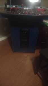

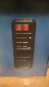

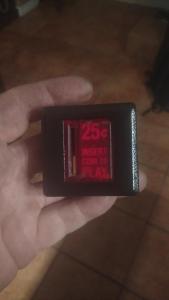

danwelsh Posted September 14, 2016 Author Posted September 14, 2016 Added a coin door. Just gotta get it lit up now....and paint the cab black. Also made inserts for the coin slots I'm lovin my arcade

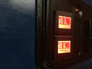

danwelsh Posted September 19, 2016 Author Posted September 19, 2016 And let there be light . Just need one more lock and coin door is complete I'm lovin my arcade
Metalzoic Posted September 19, 2016 Posted September 19, 2016 Nice. I still need to add a coin door to mine, but waiting to do it at the same time I rebuild my CP, which is waiting on info I can never seem to get answered (will an ultimate IPAC with U360s work with both TTX and AAE update #2?). I don't really want to buy 1k in parts to discover it wont do what I want once it arrives. ... Also, why are your fingers so dirty? What have you been up to? Sent from my SM-G935V
danwelsh Posted September 19, 2016 Author Posted September 19, 2016 Nice. I still need to add a coin door to mine, but waiting to do it at the same time I rebuild my CP, which is waiting on info I can never seem to get answered (will an ultimate IPAC with U360s work with both TTX and AAE update #2?). I don't really want to buy 1k in parts to discover it wont do what I want once it arrives. ... Also, why are your fingers so dirty? What have you been up to? Sent from my SM-G935V Lol....i work in carbon black at work.....it's always coming out of my pores even after i wash or it could be spraypaint since i resprayed the door that day...... I'm lovin my arcade
