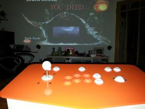

gigapig Posted June 2, 2013 Posted June 2, 2013 I used an Xbox controller and it works very well. I also have a detachable cable for the trackball. I made my self an arcade stick, no room for a full cab in my house.
doo138 Posted June 3, 2013 Author Posted June 3, 2013 @ gigapig That's what I'm thinkin would be the cheapest and easiest way to go about this....maybe if I can find a cheap enough controller. And the setup you have there looks awesome. Is the computer in the pedestal?

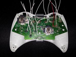

gigapig Posted June 3, 2013 Posted June 3, 2013 @ gigapig That's what I'm thinkin would be the cheapest and easiest way to go about this....maybe if I can find a cheap enough controller. And the setup you have there looks awesome. Is the computer in the pedestal? No, the controller has no PC inside, it's just on my lap. It's made from a lightwieght rigid foam base and a acrylic top. The Xbox controller was donated to me and was in a mess, but I had a spare shell kicking around. You don't need a shell at all anyway, you can attached a separate battery pack straight onto the battery terminals. Having said that using the case is easier. A word about the soldering. Each contact on the circuit board for each button and D-pad has a Positive side and a common ground (-). You only need to solder 1 point on the circuit board for the ground and then daisy chain that wire to the negative side of each button and Joystick microswitch. Use a thin wire also, 26 or 28 AWG. The solder points are very small and excess heat can cause the track and solder point to lift off the board, thats why I used hot glue on each solder point to stop the wires moving around after soldering. If you do have that problem there is an alternative solder point for each button. If I remember correctly the D-pad is the worse. The analogue sticks are redundant. If you have an Xbox you can also use it for that as well for Tekken, Soul Calibur etc. Try and get a cheap controller for somewhere. You may have seen these already but here are some links to some tutorials. I cobbled together a quick video of my setup which should be up shortly. The common ground starts off being a red wire and then is joined to the white daisy chain. The orange wires are the positive wires. I used shorter wires for the initial soldering and then added the longer ones later. It was easier and neater that way. Sorry for the long winded post.
