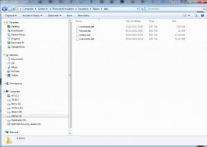

gigapig Posted March 10, 2014 Posted March 10, 2014 Just started using that build the other day. My previous compiled one saved to a folder called 'hi'. Any idea where the new saves to? I recorded a new hi score, but didn't see the output.Sent from my SM-N900V using Tapatalk I have the same. I just moved my Mr Do! hiscore out of the folder and the default score appeared in game, putting the file back restored the hi score. When Jumpstile first posted about his builds he said to create a folder called dats, where you put the "hiscore.dat" and "history.dat" as you can see the dates haven't changed on these, but maybe they don't anyway. Just tested removing the dats folder from the Mame directory and the Mr Do! score goes back to default.

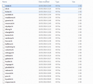

bluc Posted March 11, 2014 Posted March 11, 2014 When was fyrecrypts post? I looked back quite a way and couldn't find it and I went back over a year. Anything much over a year wont be relevant unless your using the old Hyperlaunch 2.5.I searched for that line in the ahk (version 2.1.1) and it doesn't exist. Post some details of your problem. Was going by op. But turns out my .hi files are being created so I dont have to edit trying to get hi score working in marquee magician how do I check hi to text is working. The high score in games I play resetes on exit so not sure if its working or not.
gigapig Posted March 11, 2014 Posted March 11, 2014 Was going by op. But turns out my .hi files are being created so I dont have to edit trying to get hi score working in marquee magician how do I check hi to text is working. The high score in games I play resetes on exit so not sure if its working or not. What version of Mame are you running? and it obviously has hiscore support? Have you created the dat folder and put the required files in it? HitoText is in the module extensions folder, or you can change the path in HLHQ under General Settings>Third Party. I don't run Marquee Magician, so can't help with that, but your score should show up in Hyperpause providing the game is supported.
bluc Posted March 11, 2014 Posted March 11, 2014 Mame version is mame64 patched for hi score by me. Did not make a dat folder or put a file in will look into that cheers
gigapig Posted March 11, 2014 Posted March 11, 2014 Mame version is mame64 patched for hi score by me. Did not make a dat folder or put a file in will look into that cheers The latest version 0.152. You can grab a build with everything included from Jumpstiles folder on the ftp.

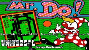

gigapig Posted March 12, 2014 Posted March 12, 2014 What is hyperpause? what does it do? Is it a pause menu? How else can I check if hi to text is working? This is Hyperpause
gigapig Posted March 12, 2014 Posted March 12, 2014 How else can I check if hi to text is working? Where do you want the score to show up? Are you using RocketLauncher? If your using RocketLauncher and you want the score to show up in Hyperspin, all I just did was this. Went to the hyperlaunch folder then Module extensions. Found the Hitotext.exe and XML, copied them both and pasted them into the root Hyperspin folder. You may need to have your paths set up in HyperHQ to the Mame exe etc.
