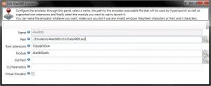

ghutch92 Posted December 22, 2013 Author Posted December 22, 2013 (edited) Systems: Atari XEGS, Atari 8-Bit, Atari 5200 Status: Active Basic Setup 1.) Download the latest version of the Atari800 emulator from it's sourceforge page. 2.) Create a new folder in your emulators folder (C:\HyperSpin\Emulators) named Atari800. C:\HyperSpin\Emulators\Atari800 3.) In your new Atari800 folder create a version folder the latest version at the time of this writing is v3.0.0 . C:\HyperSpin\Emulators\Atari800\v3.0.0 4.) Extract the contents of your download to the new version folder the path to your exe is now C:\HyperSpin\HyperLaunch\Atari800\v3.0.0\atari800.exe 5.) Now manually start your emulator by clicking on the exe. You should get a screen asking for a real Atari/OS. Enter the UI by pressing F1. ESC is used to return to the previous screen. 6.) On this menu go to Emulator Configuration and make sure you set Save Configuration on Exit to Yes otherwise your settings won't save. 7.) Create a new folder in the same directory as atari800.exe called rom. This is where you will put your bios files. (I am not allowed by this site's terms to post links to these bios files) 8.) For the Atari 5200 bios name it 5200.ROM C:\HyperSpin\HyperLaunch\Atari800\v3.0.0\roms\5200.ROM 9.) For the Atari XL bios name it ATARIXL.ROM C:\HyperSpin\HyperLaunch\Atari800\v3.0.0\roms\ATARIXL.ROM 10.) For the BASIC bios name it ATARIBAS.ROM C:\HyperSpin\HyperLaunch\Atari800\v3.0.0\roms\ATARIBAS.ROM 11.) Once you have completed steps 7-10 open the emulator, press F1 to bring up the configuration menu, and go to Emulator Configuration. 12.) Choose System Rom Settings in the same menu where you set Save Configuration on Exit in step 6. 13.) If you did steps 7-10 correctly you can choose Find ROM images in a directory (C:\HyperSpin\HyperLaunch\Atari800\v3.0.0\roms) and the emulator will add the bios files for you. If not you will have to point to each one using the Atari800 menu. 14.) Now we need to setup the emulator for HyperLaunch. Open HyperLaunchHQ, Highlight Global in the systems panel and then click on the big tab emulators. Find Atari800 in this list and double click on it. Now set your path to atari800.exe and fill in the rest of the settings 15.) Now highlight your respective system in the system panel. Click on the big tab Emulators and then add the path to your roms to the rom paths field. You can do this by clicking on the smaller green plus button to the right of the rom paths field. 16.) Now set Atari800 as your default emulator by clicking on the magnifying glass to the right of the default emulator field and selecting Atari800 [Global] in the popup window. 17.) Don't forget that you can edit module settings by highlighting the AAE module in the modules tab and clicking either the edit global module settings button or the system specific module settings button. Notes You will need to specify the cart type for some games and you can do this with in HLHQ with the SYSTEM SPECIFIC module settings, it's right next to the global module settings button. If you don't know where either button please refer to this page. The games that need this specification are headerless roms. Also you can not have your roms zipped or compressed because atari800 does not natively read zipped files or any other compression. You will need to use HL's 7zip feature if you want to keep them compressed. When you load a 5200 rom HL will use a best guess as to what the cart type is, but you will still need to manually discern between the 16 kb roms. There are two types: one has one chip while the other has two chips. FYI I have not setup Atari800 for xegs or 8-bit yet. When I do that I'll finish the guide or link to an already done guide someone else made. Edited December 22, 2013 by ghutch92 1 How to Install HyperSpin and more RocketLauncher HyperSpin Startup Script

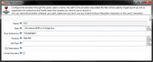

ghutch92 Posted December 22, 2013 Author Posted December 22, 2013 (edited) Systems: Nintendo Game Boy, Nintendo Game Boy Color Status: Active Basic Setup 1.) Download the BGB Emulator from here http://bgb.bircd.org/#downloads 2.) Create a new folder in your Emulators folder named BGB 3.) Create a new folder in your BGB folder named aver the version number in this case v1.4.3 4.) Extract the contents of your emulator download to the new folder you created above. The path to bgb.exe should now be: C:\HyperSpin\Emulators\BGB\v1.4.3\bgb.exe 5.) Open HyperLaunchHQ, Highlight Global in the systems panel and then click on the big tab emulators. Find BGB in this list and double click on it. Now set your path and fill in the rest of the settings 6.) Now highlight your system in the system panel. Click on the big tab Emulators and then add the path to your roms to the rom paths field. You can do this by clicking on the smaller green plus button to the right of the rom paths field. 7.) Now set BGB as your default emulator by clicking on the magnifying glass to the right of the default emulator field and selecting BGB [Global] in the popup window. 8.) Don't forget that you can edit module settings by highlighting the module in the modules tab and clicking the edit global module settings button. If your exit emulator key is set to Esc please read this. 1.) Click on bgb.exe to open it. Right click in the window and select Options. 2.) Select the Joypad tab, check configure extra buttons and then click on configure keyboard 3.) When you come to "press and hold the button for pause" you will need to choose a key other than the Escape key. Advanced Setup FAQ Edited February 6, 2014 by ghutch92 How to Install HyperSpin and more RocketLauncher HyperSpin Startup Script

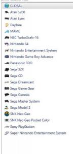

Tlk269 Posted December 29, 2013 Posted December 29, 2013 I need help the only systems that appear in hyperlauch hq are these in the picture. i follow the steps that you tells to and now i am trying to add AAE and is not in the list what do i have to do? thanks <img src="http://s28.postimg.org/iu81dasd9/systems.jpg">
ghutch92 Posted December 29, 2013 Author Posted December 29, 2013 I need helpthe only systems that appear in hyperlauch hq are these in the picture. i follow the steps that you tells to and now i am trying to add AAE and is not in the list what do i have to do? thanks <img src="http://s28.postimg.org/iu81dasd9/systems.jpg">[ATTACH=CONFIG]36563[/ATTACH] http://hyperspin-fe.com/oldsite/index.php?option=com_content&view=article&id=76&Itemid=86 How to Install HyperSpin and more RocketLauncher HyperSpin Startup Script
