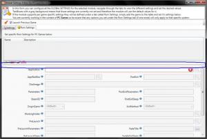

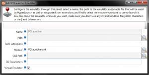

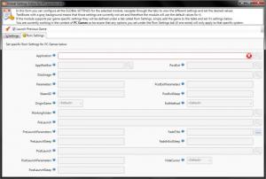

ghutch92 Posted January 13, 2014 Author Posted January 13, 2014 (edited) Systems: Games for Windows, Microsoft Windows, PCLauncher, PC Games, Steam, Steam Big Picture, Taito Type X, Touhou Status: Very Active MVersion = 2.0.8 There is no emulator to download or install, PCLauncher is included with RL and it is the name of a very special module. It is basically a command line launcher that you could customize for pretty much any use without editing any code. It has extensive steam support and origin support. In theory this module could replace all the other modules used in HyperLaunch. Due to the complexity and frequent updates of this one be sure to check this guide as I update it with more useful information and yes wherever you see [] I'll be adding an image. This guide is not meant be comprehensive for all uses of PCLauncher. Basic Setup 1.) Even though PCLauncher doesn't use an emulator we still need to make settings for one. Open HyperLaunchHQ, Highlight Global in the systems panel and then click on the big tab emulators. Find PCLauncher in this list and double click on it. Make sure the name is PCLauncher. Virtual Emulator is checked and the correct module is selected. Everything else needs to be blank and empty. Note: PClauncher does not require rom paths to be set. I suggest leaving the field empty to speed up load time if PCLauncher is the only "emulator". 2.) Highlight your system you want to use PCLauncher for and set PCLauncher as your default emulator by clicking on the magnifying glass to the right of the default emulator field and selecting PCLauncher [Global] in the popup window. 3.) Ok so PClauncher uses both system specific module settings and global module settings, and both do essentially the same thing. Normally you want to use the global one. You should use the system specific one in the case of two unique games that have the same database name but are in separate systems. Based on this information choose between system specific and global, the rest of this guide will refer to your choice as module settings. WARNING: When you use system specific module settings HL will ignore anything you have added to the global module settings. This means if you added game "X" using the global module setting for system "A", and then added game "Y" for system "A" using the system specific module settings, game "X" will no longer work with HyperLaunch until you add it using the system specific module settings. 4.) Click on the Rom Settings tab in the module settings window. Click on the green plus sign and choose one of your games (this list is generated from your database, you must have 2 or more games in your database). 5.) Fill in the application setting. You can use the magnifying glass to the right of the entry to help you find it normally an exe file. You can also fill it in with browser protocols (i.e. Steam), URL's (www.hyperspin-fe.com), and file paths. Notes 1.) Skipchecks (HLHQ -> Selected System (not global) -> Big Tab Settings -> Main Settings) must be set to rom and emu if your emulator name in the emulator settings window is not PCLauncher. If you want to use PCLauncher in other systems as an "alternate emulator" for launching things like PC games that fit a certain system (Fix it Felix Jr comes to mind), you will need to name your PCLauncher emulator PCLauncher . This is so you don't get caught in the skipchecks error HyperLaunch will give you if you have it named to something different like Steam Launcher or PC Launcher. Remember I'm talking about the emulator name and not the system name. What the other settings in the above image are for: AppWaitExe - This will be the exe, if different then the Application, that you want HyperLaunch to wait for until it closes. This would be needed if launching a bat file, which in turn launches another exe, where the exe is the game. Leave this blank if the module works fine with the exe from the Application key. DiscImage - Path to a disc image (ccd,cdi,cue,iso,isz,nrg) if required by a game, usually for a cd check. Only fill this key if a cd/dvd image is required by your game. Parameters - This can be any number of parameters that you want to supply to your application. SteamID - If you are launching a steam game, provide the ID of the game here. This will turn on steam mode if not blank. Steam only understands AppIDs for games, not rom names. See here for more info on finding a steam ID for your game: https://support.steampowered.com/kb_article.php?ref=3729-WFJZ-4175 OriginGame - Set to true if this is a game using the Origin Service. If true it will allow automatic logging into Origin so you do not get stuck at a login prompt while loading WorkingFolder - Mostly for GoG games, allows you to set a different working directory then the default directory (the one Application exists in) PreLaunch - This can be used to run another application before launching the Application. This will usually be blank. Can be a relative or absolute path. Can also be a URL or Steam Browser Protocol. PreLaunchParameters - This can be any number of parameters that you want to supply to your PreLaunch application. PreLaunchSleep - If you need the script to wait after launching your PreLaunch app for a set amount of time, put that here (1000=1 second). PostLaunch - This can be used to run another application after the Application has launched, but before the module waits for it to close. This will usually be blank. Can be a relative or absolute path. Can also be a URL or Steam Browser Protocol. PostLaunchParameters - This can be any number of parameters that you want to supply to your PostLaunch application. PostLaunchSleep - If you need the script to wait after launching your PostLaunch app for a set amount of time, put that here (1000=1 second). PostExit - This can be used to run another application after the Application has closed. This will usually be blank. Can be a relative or absolute path. Can also be a URL or Steam Browser Protocol. PostExitParameters - This can be any number of parameters that you want to supply to your PostLaunch application. PostExitSleep - If you need the script to wait after launching your PostLaunch app for a set amount of time, put that here (1000=1 second). ExitMethod - Define an alternate way to exit your Application in case it doesn't close with your Hyperspin exit keys using the default WinClose. WinClose methods are suggested as they will cleanly close a window, whereas Process methods force close it (many apps do not like to be force closed). Alt+F4 is an app-friendly method also, but some applications will disable this. Choose the one that works best for your scenario. WARNING, before enabling Fade_Out on exit, make sure you test your ExitMethod first, otherwise you might get a blank screen while game never closed. FadeTitle - This is the Window Title & Class of your application. To find the Title/Class you can use the AutoIt3 Window Spy utility installed with AutoHotKey or my utility @ http://www.hyperspin-fe.com/forum/showthread.php?15014-Window-Logger FadeInExitSleep - This is needed for some applications that may start, but not appear, ending FadeInExit prematurely. It keeps the fade screen up for the defined length. HideCursor - True or False - Same as the HyperLaunch setting, but allows for per-game use. FAQ All my games are red in HLHQ's game audit, is this bad? No, actually this is good. If it launches fine and works all is good. It is red because HLHQ can not find the files according to your rom paths, rom extensions and database names. This does not necessarily mean HL can't find them. If you want them to be green you will need to name every game in your HyperSpin database after the file name that starts your game (your exe file, bat file, etc). Then you will need to add those file extensions to rom extensions. Then you will need to set the path in rom paths to every file. To make them be green is not easily done if you think about it. Some games use the same exe file names like game.exe or launcher.exe, this means duplicate database entries, which means your HyperSpin menu won't work. If you actually use it for PC Games, every game will probably also have a unique path like this one C:\Program Files\something\folder\file.exe So for all those games like this you will need to add C:\Program Files\something\folder to the rom paths. If you have more than 1 game spare yourself the trouble and don't try to force the audit to be green for PCLauncher. I can't see my list of games, whenever I open the module settings in HLHQ, all I see this!? Don't panic, everything is still there, just drag the below highlighted grey line down to see them. I don't see a list of games in the popup window as predicted in step 4 of the pclauncher setup guide. It could be that you have no games or only one game in your database xml or you may not even have an xml database for your system. If two or more games do appear in the correct HyperSpin wheel, your issue is much deeper than a simple answer, you should post your issue in a relevant thread (not the how to install hyperspin thread) or a new thread with as much detail as possible. Common PCLauncher Errors and How to Fix them. PCLauncher does not use extensions, but you have them set to: " list of Extensions ". Please remove all extensions from the PCLauncher emulator in HyperLaunchHQ to continue using it. You can remove extensions where you set up the emulator in HLHQ. In this screen you will remove them. Remember to check virtual emulator or HLHQ will get mad at you for trying to remove the extensions. You have not set up " dbName " in HLHQ yet, so PCLauncher does not know what exe, FadeTitle, and/or SteamID to watch for. If you got this it means you forgot to set up your game in your module settings. How silly of you. Go set it up and fill in one one of the required parameters. You defined a DiscImage, but it is not a supported format for this module and/or DT: ccd,cdi,cue,iso,isz,nrg Well your cd has a bad/unsupported extension. Either create another backup file of your game using a supported file type or find a converter. I have no recommendations for converters. There was a problem launching your PreLaunch/PostLaunch/PostExit/Application/ImageExe. Please check it is a valid executable. Uh, oh. The application or executable you set to be your mentioned in your error (PreLaunch/.../ImageExe) failed. First, I would check and make sure the filepath I set in HLHQ in module settings for this application is correct and then I would see if it works using cmd line or the windows run box, and then if that doesn't work maybe check the program's code and if I can't do that I will post my problem here on the forums with a troubleshooting log and maybe a link to the bad program I tried. PCLauncher - There was an error getting the Process ID from your AppWaitExe/SteamIDExe for " dbName ". Please try setting a FadeTitle instead. - Could not find a proper AppWaitExe, FadeTitle, or AppPID (from the launched Application). Try setting either an AppWaitExe or FadeTitle so the module has something to look for. - You are using launching a Steam game but no way for the module to know what window to wait for after launching. Please set a AppWaitExe, FadeTitle, or make sure your SteamID and the correct exe is defined in the SteamIDs.ini - You are using launching a URL but no way for the module to know what to window to wait for after launching. Please set a AppWaitExe or FadeTitle to your default application that gets launched when opening URLs. How to set the FadeTitle FadeTitle is the same thing as WinTitle in the autohotkey documentation for the WinWait command. Setting this let's HypeRLaunch know when your game is active and running. HyperLaunch uses this info so it knows when you quit your game, when the game starts (used for fade-in), and if you want to close your application with the Exit Emulator Key. 1.) Open HLHQ and go to your PCLauncher Module Settings 2.) Skip this step if HL can start your game. Test your game by selecting it in the list and press the HL Launch icon 3.) Highlight your game in the list and look for the setting called FadeTitle [] 4.) Now click the button to the right of the fadetitle setting. If you don't have this button make the window wider. [] 5.) On screen you should see these Instructions [] 6.) Wait until your game is active and then press ctrl+q to set the fade title. 7.) Exit your game. 8.) Make sure HyperLaunch is not still open in task manager or in the HLHQ tab in HLHQ. 9.) Try launching the game again. It should work this time. If not, try setting an AppWaitExe. If neither AppWaitExe or fadeTitle works please search the forums for help and if that didn't work start a new thread detailing your problems and be sure to include the troubleshooting log with your help post. How to set the AppWaitExe AppWaitExe differs from Fade Title by being a more reliable indicator of when a game closes. FadeTitle is a more reliable indicator of when the game starts. Both can used to be closed by the Exit Emulator Key, but the operation of both in this case differs. FadeTitle is used for soft/handled closes (like pressing the red x to close a window), AppWaitExe is used for hard closes (like opening task manager and killing the process). 1.) ...Depends on what happens here... There was an error waiting for the window " something " (to become active). Please check you have the correct version emulator installed for this module, followed any notes in the module, and have this emulator working outside your Frontend first. Also turn off Fade to see if you are hiding your problem. This is a common error and is seen on other modules, however the fix is different here. 1.) Set the FadeTitle for your game. Even if you've already got it set, set it again. 2.) If setting it again didn't work, try setting an appwaitexe. 3.) If the appwait exe didn't work, make sure your game is actually starting. If it's not starting try and getting it to work outside of HL first. 4.) If it is starting outside of HL and still not working and you actually did steps 1-2. Search and see if anyone already had this problem, if not start a new thread, detailing your issue on how you made it happen and be sure to include the troubleshooting log. You are trying to use Steam and Application, you must choose one or the other. Either use SteamID setting or Application setting. Not both. You will need to use one or the other. If it's a Steam Game use the Steam ID setting, if not use the Application setting. PCLauncher - SteamLaunch - Steam is not running and needs to be logged in to launch this steam game. PCLauncher can do this, but you need to run "EncryptPasswords" application in your PCLauncher module folder first and set your login credentials. When I set this up or if I find another guide on how to set this up, I'll let you know. PCLauncher - SteamLaunch - Timed out waiting 15 seconds for Steam's Login window. Please try again. Never had it happen, When I find someone who has this problem and fixed it I'll add those steps here. PCLauncher - SteamWarning - Could not log into steam after 3 tries, exiting back to your Front End. Never had it happen, When I find someone who has this problem and fixed it I'll add those steps here. PCLauncher - OriginLaunch - Origin is not running and needs to be logged in to launch this Origin game. PCLauncher can do this, but you need to run ""EncryptPasswords"" application in your PCLauncher module folder first and set your login credentials. When I set this up or if I find another guide on how to set this up, I'll let you know. PCLauncher - OriginLaunch - Timed out waiting 15 seconds for Origin's Login window. Please try again. Never had it happen, When I find someone who has this problem and fixed it I'll add those steps here. PCLauncher - OriginLaunch - Unhandled Origin Scenario. Please report this and post the log and what you did to make this happen Self Explanatory. Even HyperLaunch doesn't know what normally causes this one. PCLauncher - OriginLaunch - Timed out waiting 15 seconds for Origin's Login window to close. There was a problem logging in. Please try again or check your credentials. Usually happens when I'm mashing the keyboard on startup. The fix is to not press anything until the game starts. Other than this, I haven't had problems or found another user with problems. Edited March 22, 2014 by ghutch92 edited step 4, 2 game requirement How to Install HyperSpin and more RocketLauncher HyperSpin Startup Script
