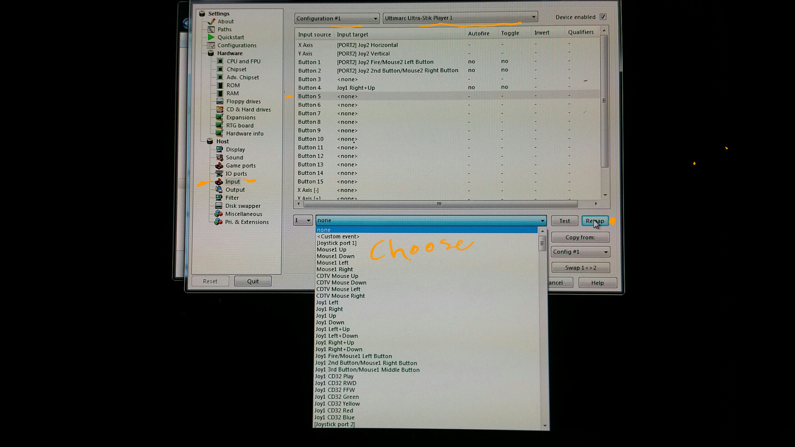

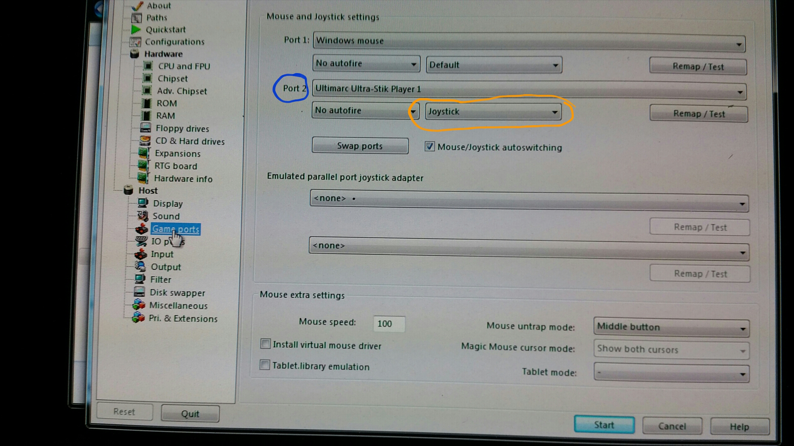

gigapig Posted September 1, 2018 Posted September 1, 2018 6 hours ago, echo1300 said: Awesome, thanks So what shows up for you under configuration 1 & 2 if you use an Ipac? Just curious. Here's what I do. Load up your config. Go to Game ports and set your controller you are using. Mine shows up as ultrastik. Then just underneath that you see the controller the Amiga used originally. Mine shows "joystick" for Amiga and "CD32 pad" on my CD32 config. Normally that should be all you need to do as Winuae will assign your controller for you. If your happy save your config. If you need to remap then select the "Input" tab in the left pane. Make sure your config is populated with the correct controller showing. Next click the remap button, Winuae will go kind of dead, it's waiting for you to press a button on your controller. When you hit the button you want to remap Winuae will come back to life and the drop down menu will open up. Choose the Winuae controller assignment you want to map to. Repeat and then save the config. Hopefully that should be all.
echo1300 Posted September 2, 2018 Posted September 2, 2018 Thank you very much for your help, i'm actually trying to assign the controls to the default ipac keyboard keys on the pc keyboard first without having the ipac connected (maybe that's the issue). I haven't completed the cabinet control buttons yet so i thought i should have the emulators configured to the default ipac keys first and once i finish with the construction just make some final adjustments on the ipac. The pictures of your setup was a big help, i think i found the issue , it was a combination of different things. What i noticed is that my keyboard did not appear in any port for some reason so i set the winuae on another pc to see if any keyboard will appear. in the second pc the keyboard appeared , followed your setup and fixed the issue!!! thank you very much i was going to delete the Amiga system completely , I'm now having issues with retroarch keyboard configuration that need to fix , i will post the question on a retroarch topic BTW is your ipac set as keyboard or as gamepad?
