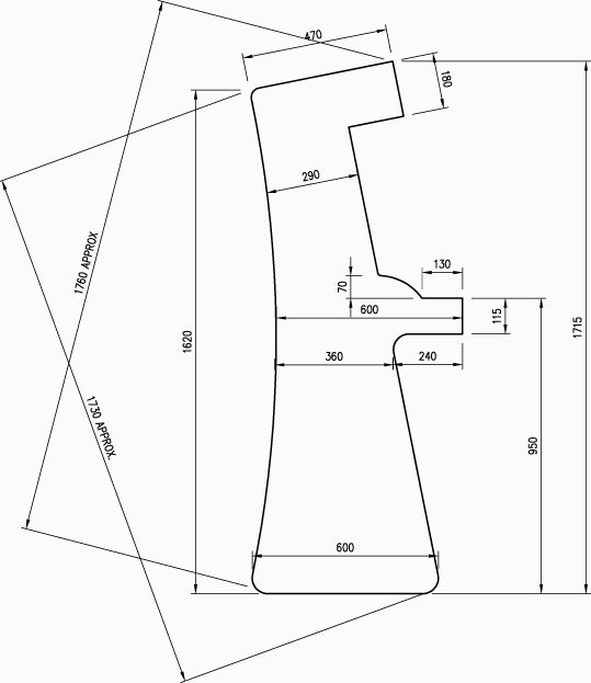

I'm using these plans.

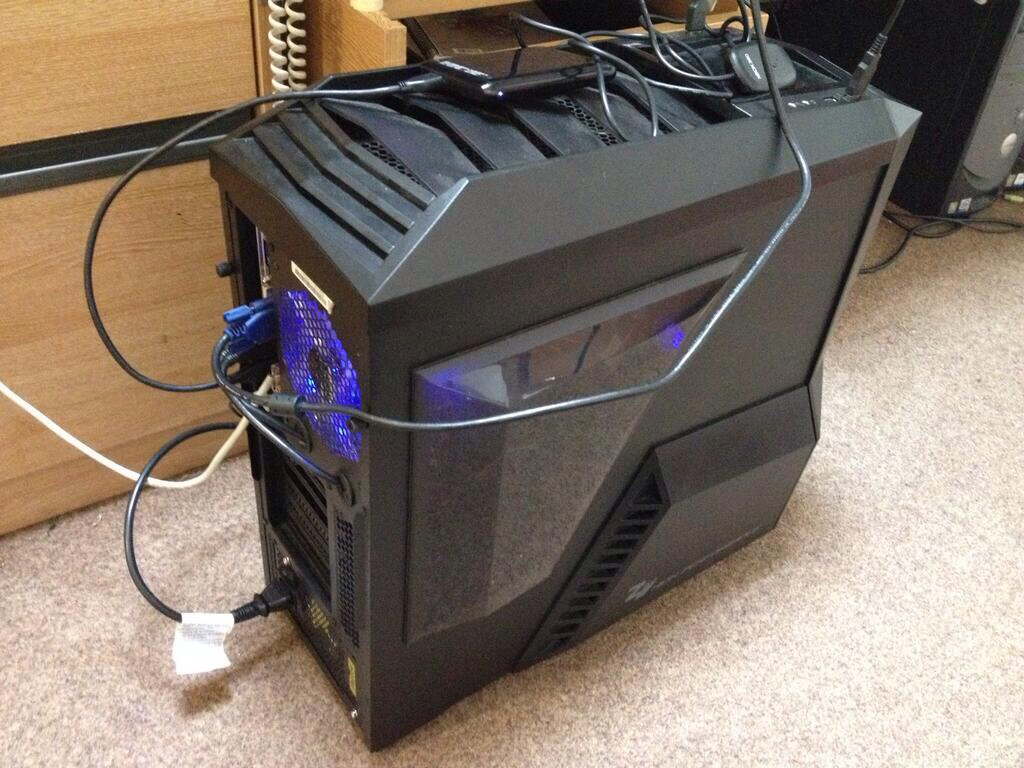

The bottom half is going to be see through and I'm fitting this PC
I'm gonna add extra case lights to get a nice blue glow
The middle section I'm fitting my xbox 360
For the screen I'm fitting my 32 inch LCD
It's going to be a 2 player cab but this time in fitting 7 buttons for fighting games that need the extra button
The PC is a AMD phenom II 3.4 ghz
With 4gb of DDR3 ram ( I'm planing to add more)
And it's fitted with a nvidia gtx 660
Graphics card

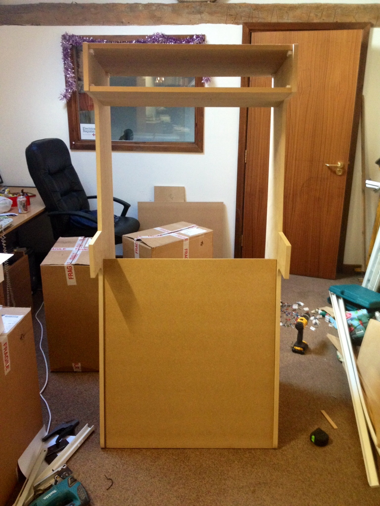

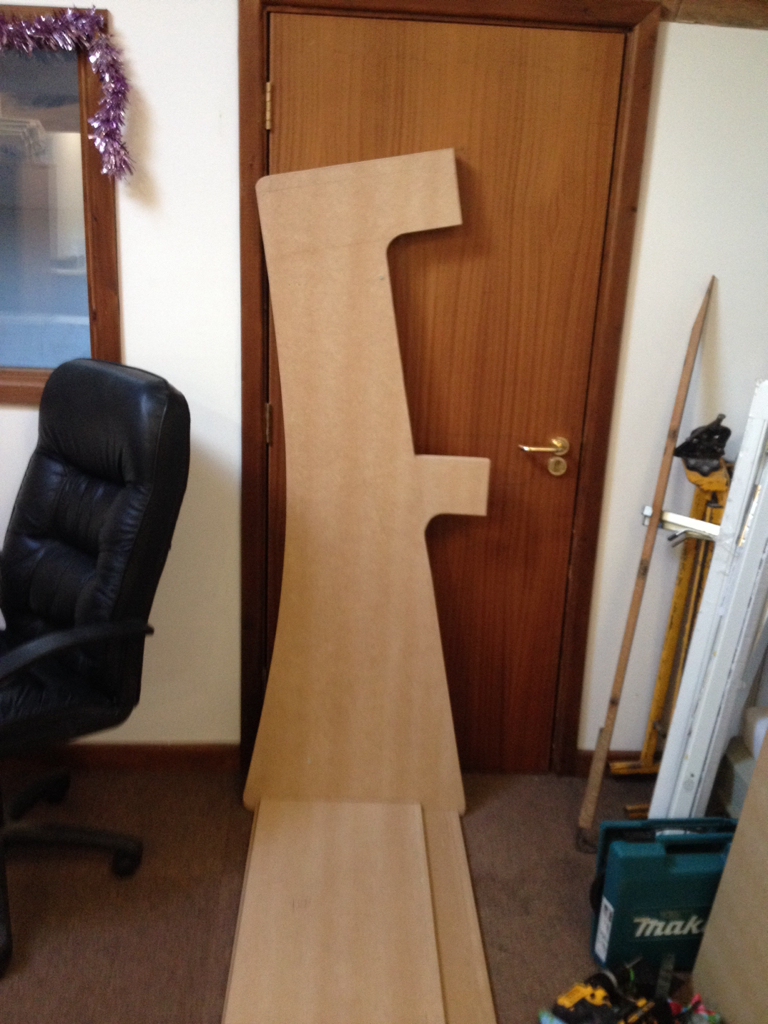

So day one

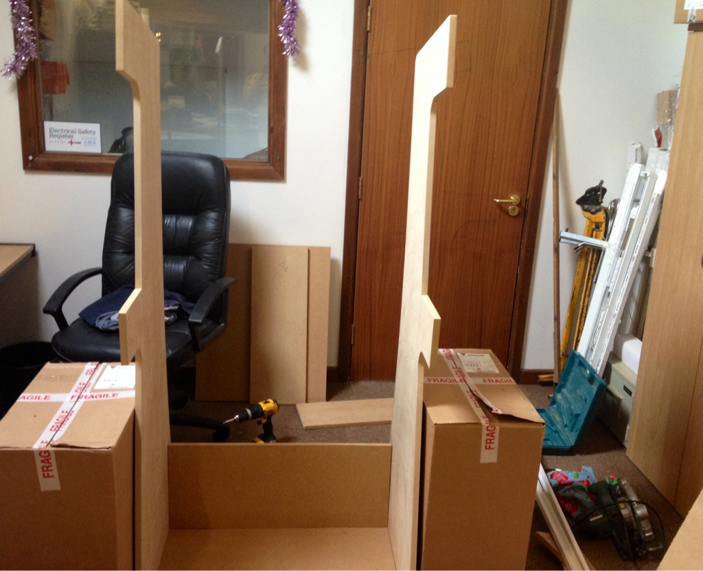

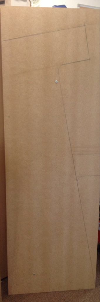

Bought my wood from B&Q at £20 for a sheet of 18mm MDF it's more expensive than other places but they cut wood for free so with my 2 sheets cut to rough I marked my wood
And screwed the left and right sides together

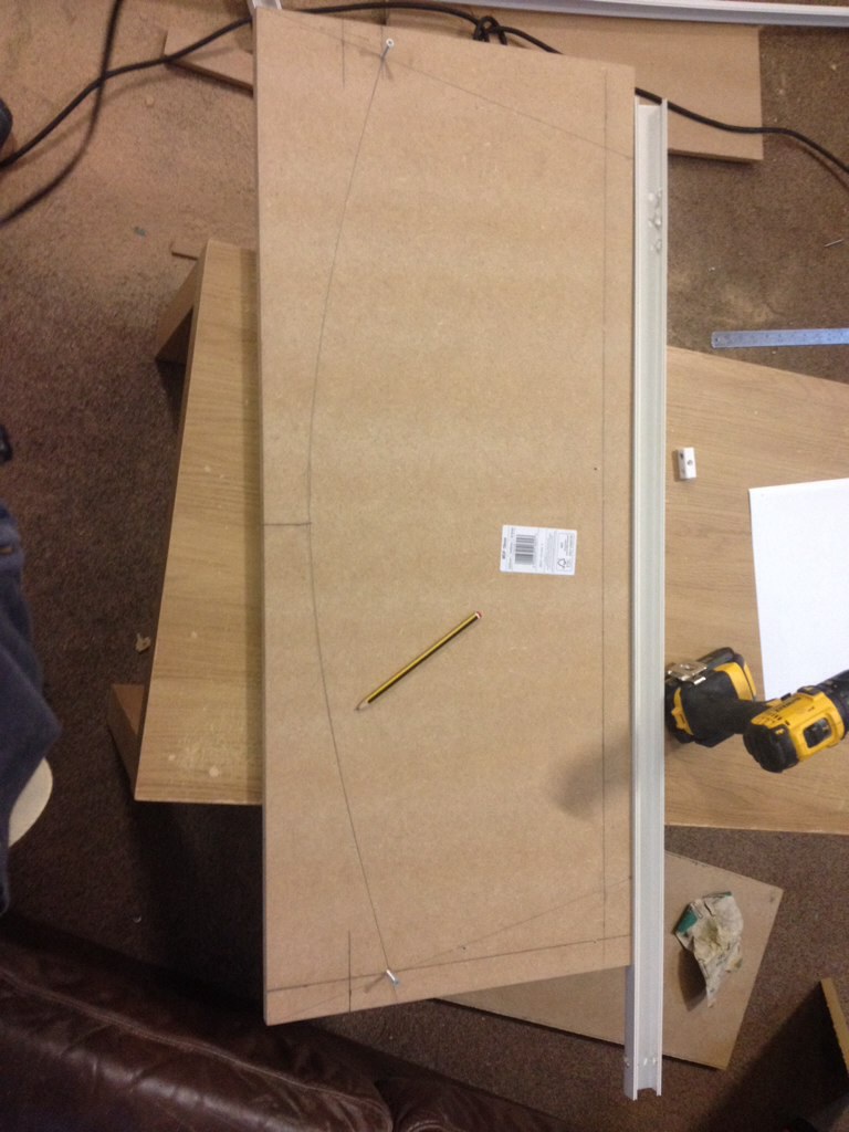

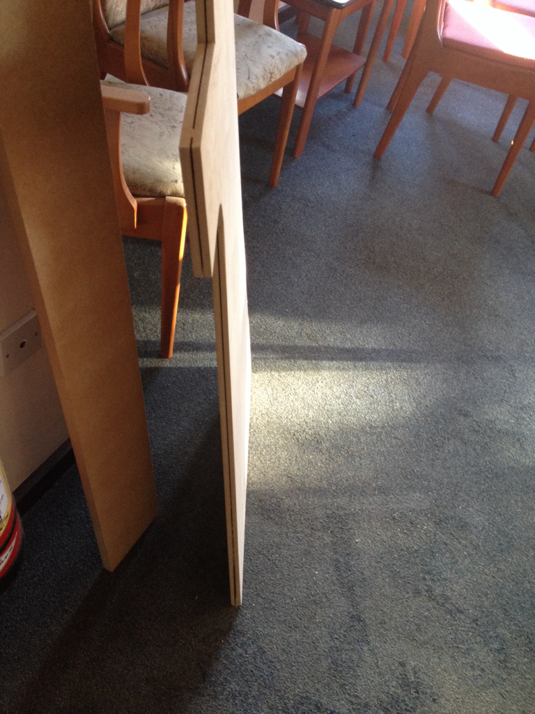

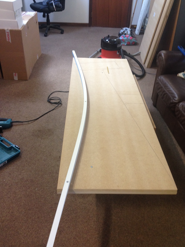

Then I used trunking as a guide for my jigsaw
Ten minutes of cutting
And the two sides are cut with bottom shelf and above the marque light
Note the control is short because I'm sitting a curved section on top different from the plan
More updates tomorrow

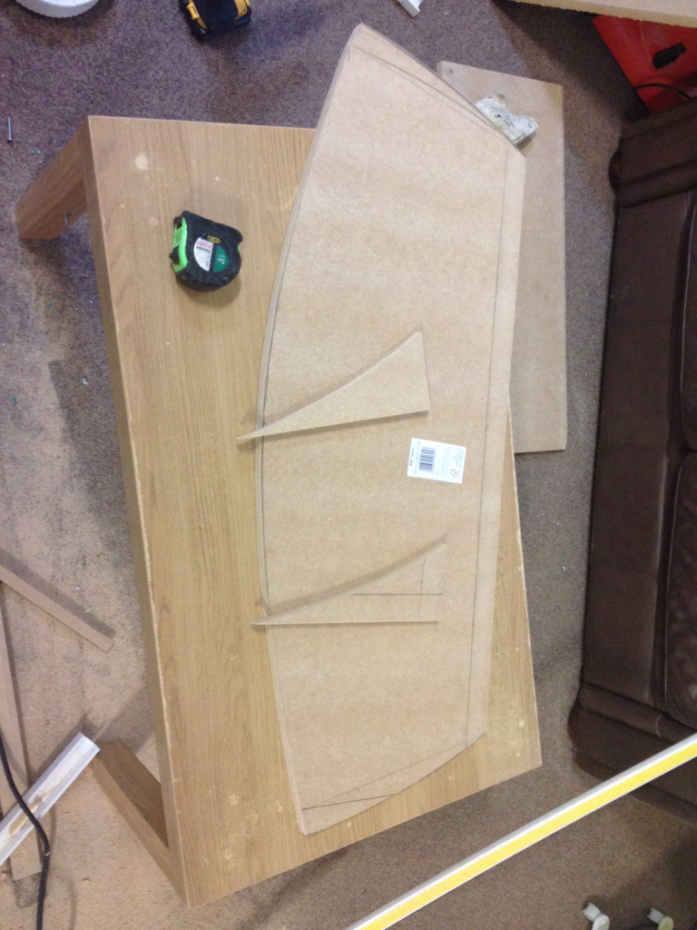

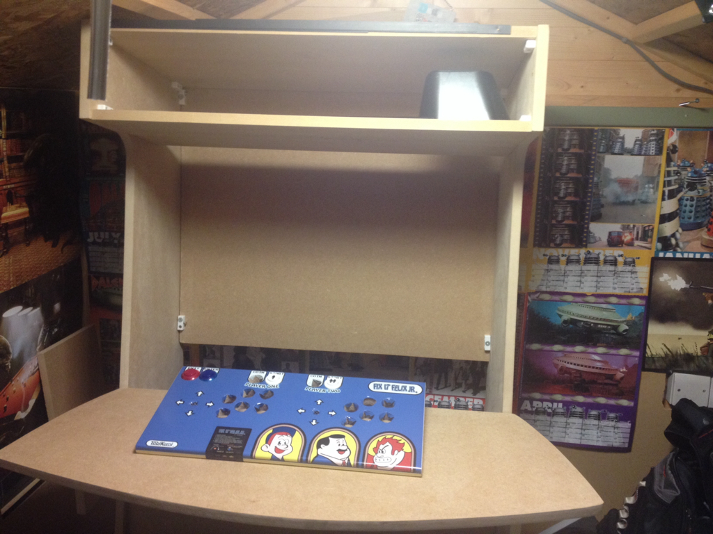

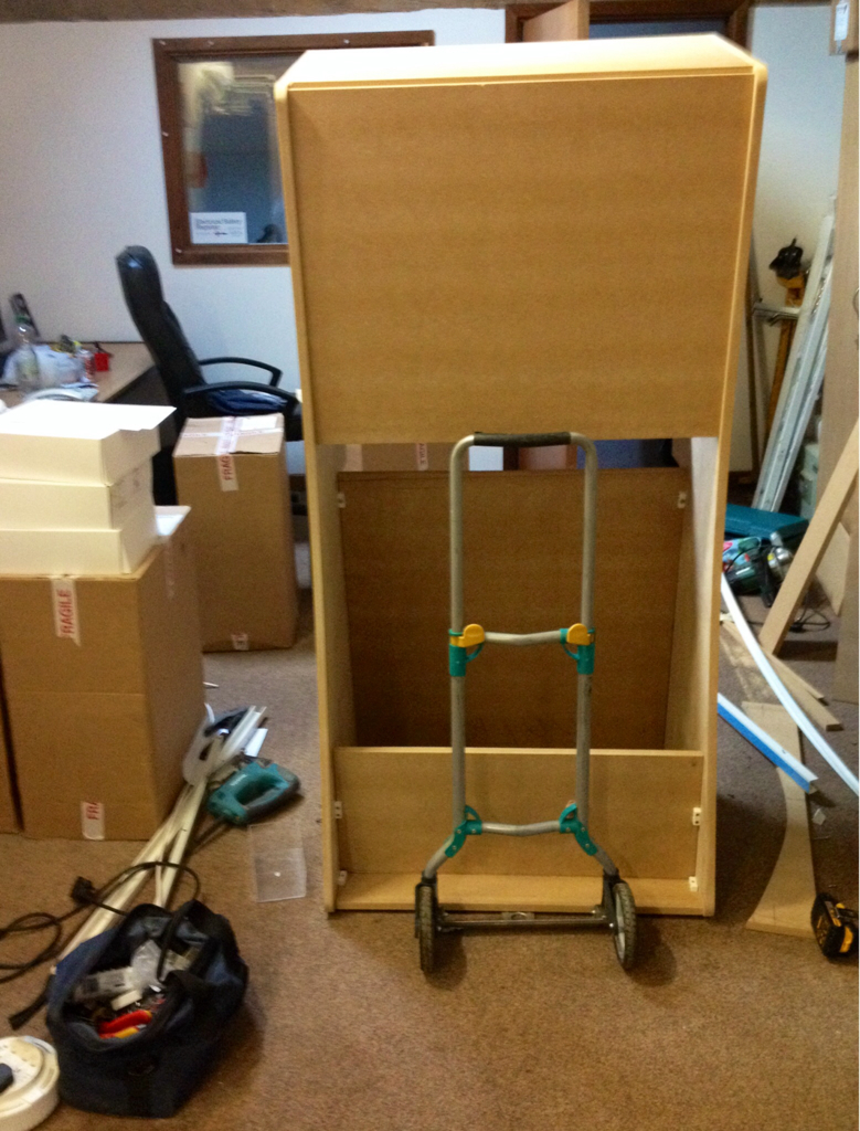

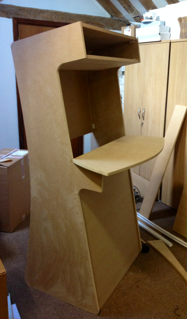

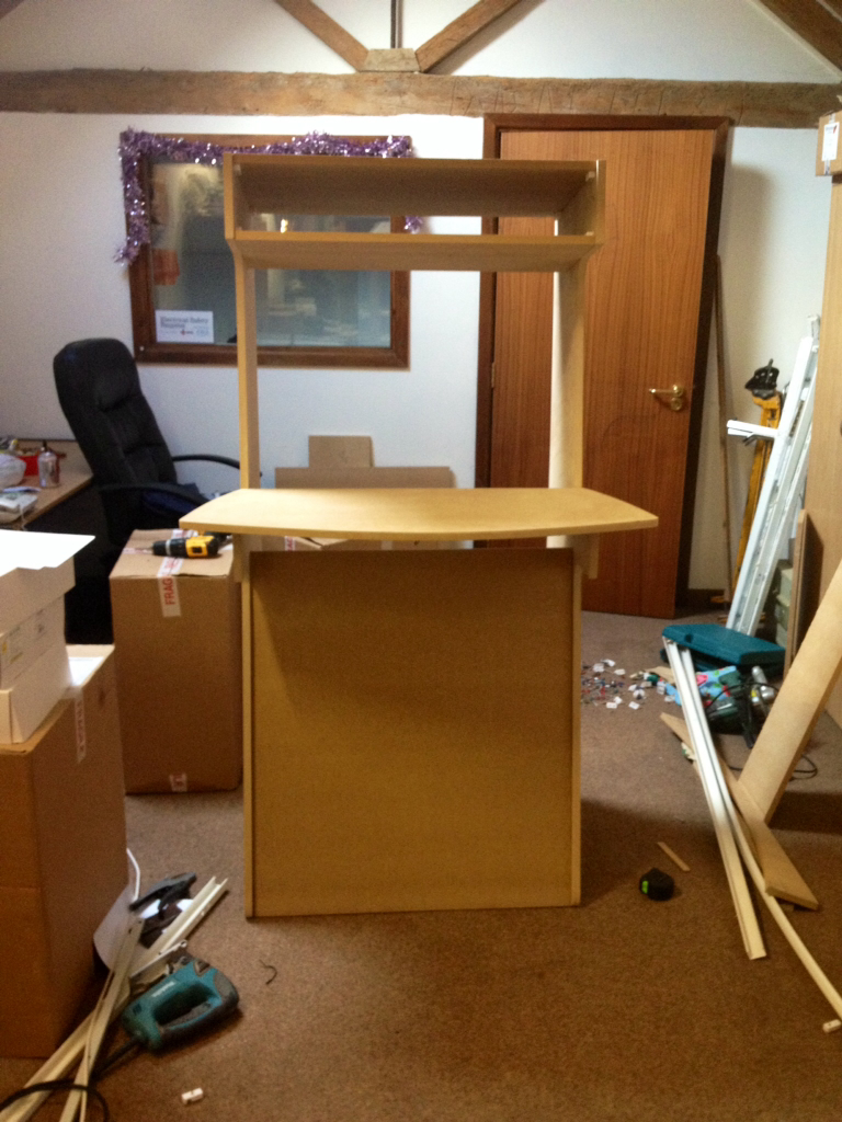

So back to the wood cutting

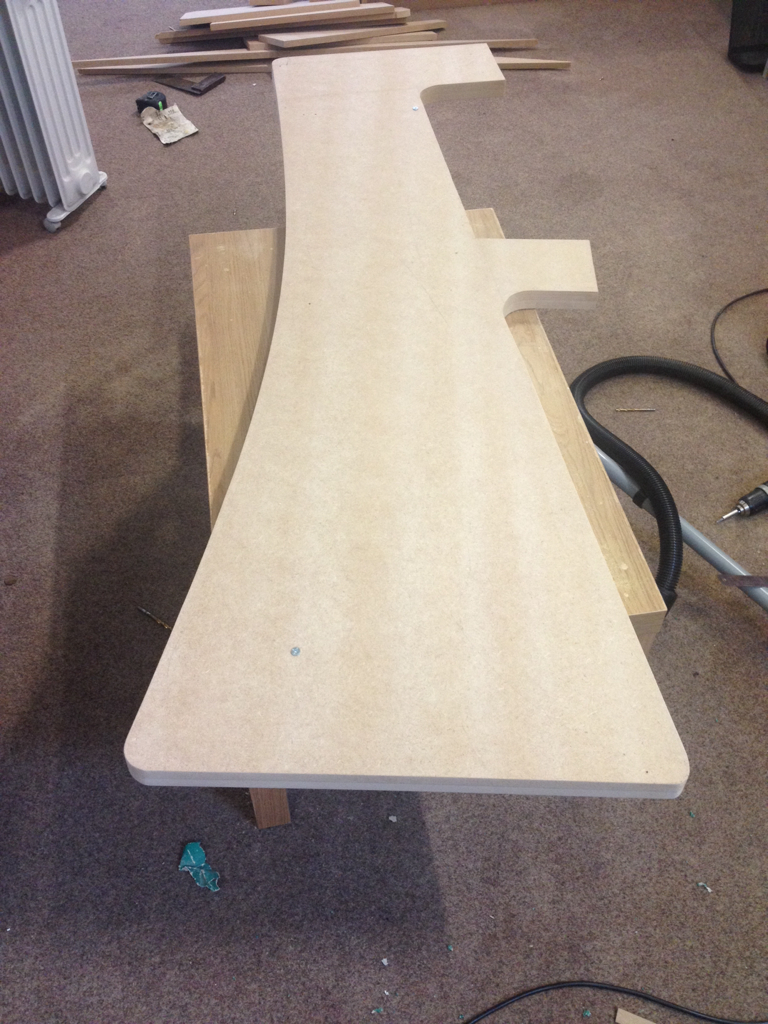

First I got out the control panel
I went off plan because like women it's better with curves ; )

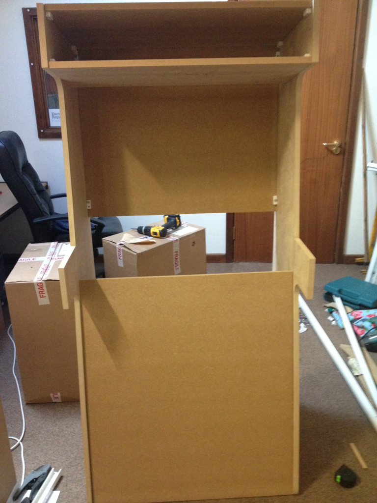

Now time to put it together for a dry fit
The front on that I'm going to cut a window into
The control panel in place
One of the 3 back panels on

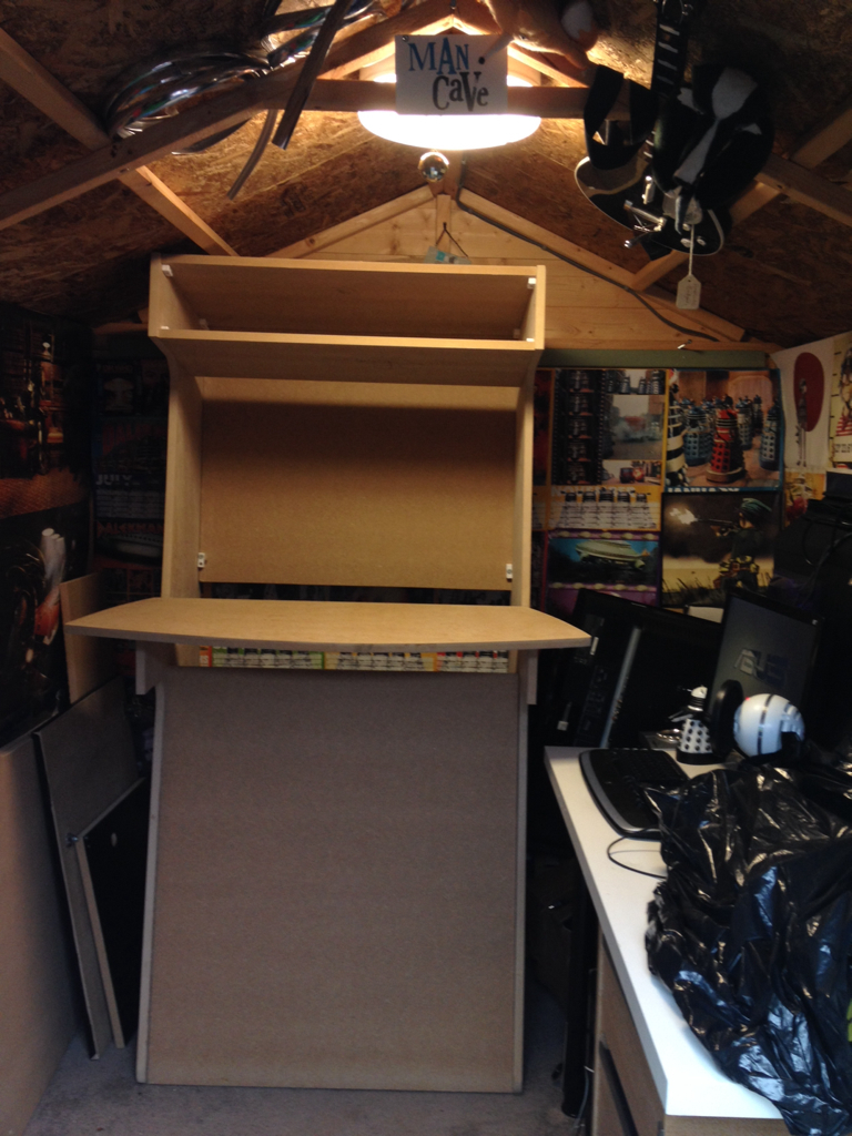

The side view

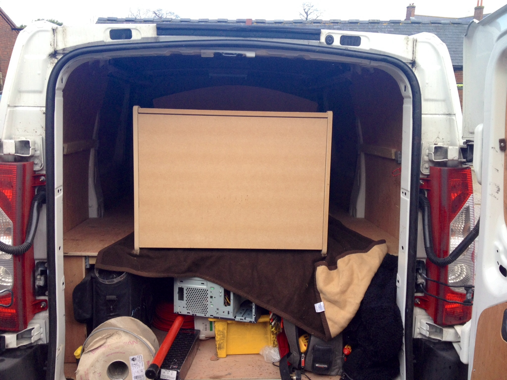

Loading it into the van
Snug fit
So taking it home to prep for decals and continue the build.
I have a few panels missing and not sure how I'm going to fit a panel under the control panel maybe a curved panel hmmmm
Still not sure what design I'm going for ?

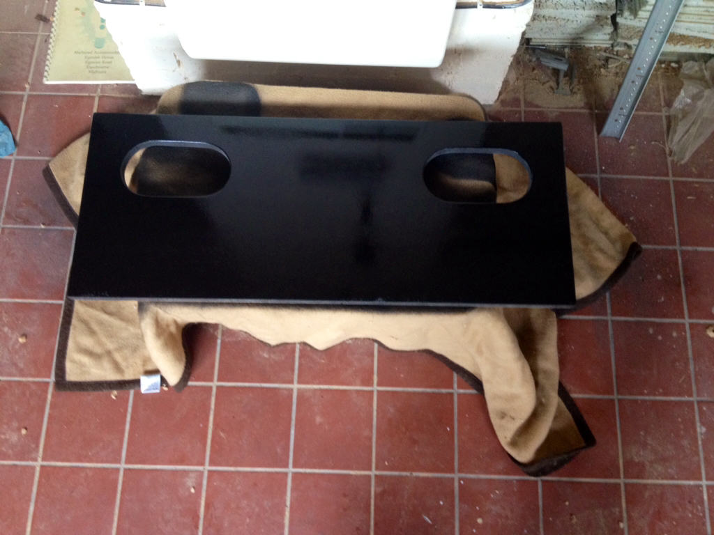

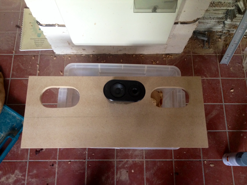

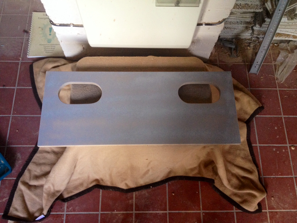

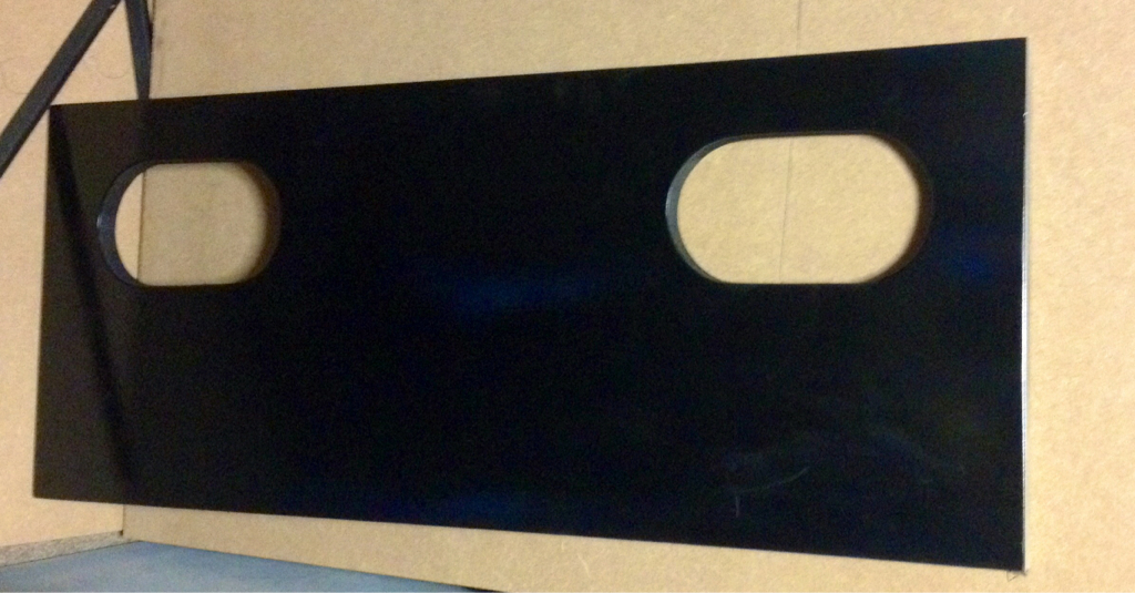

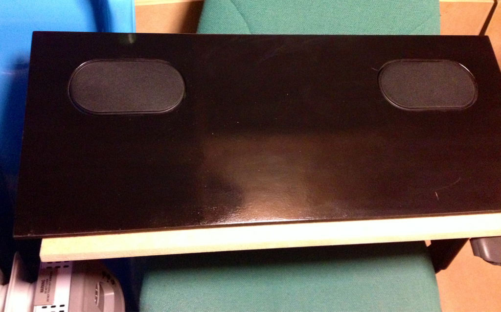

So little update today until I can cut my T-molding groove i decided to get the speaker panel ready....weird place to begin ; )
Holes cut out for speakers
Two layers of undercoat
1 layer of top coat
Just needs a light sand and a final top cost and the speakers fitted in place and that bit is done

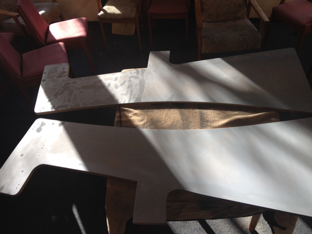

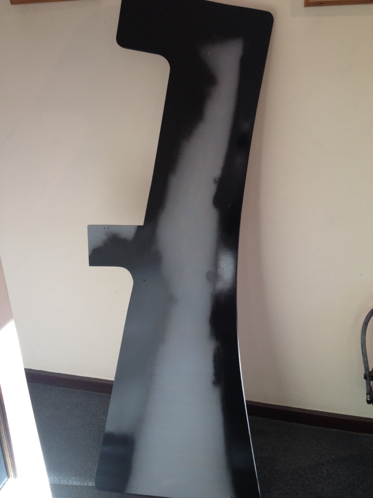

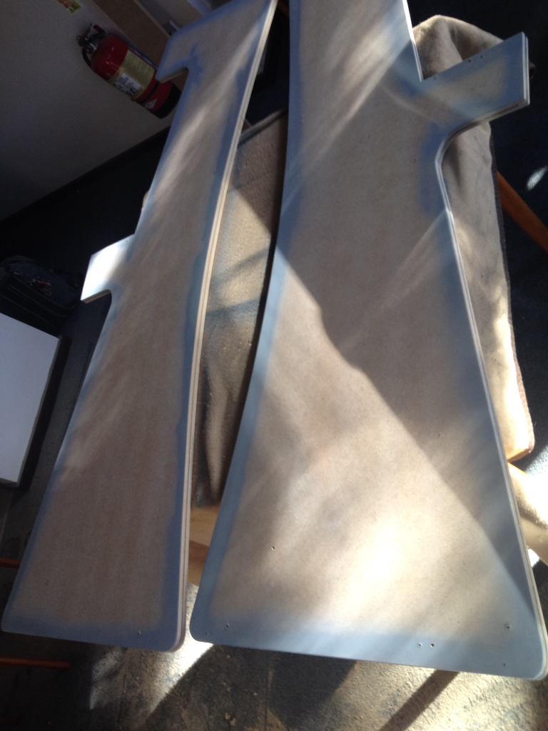

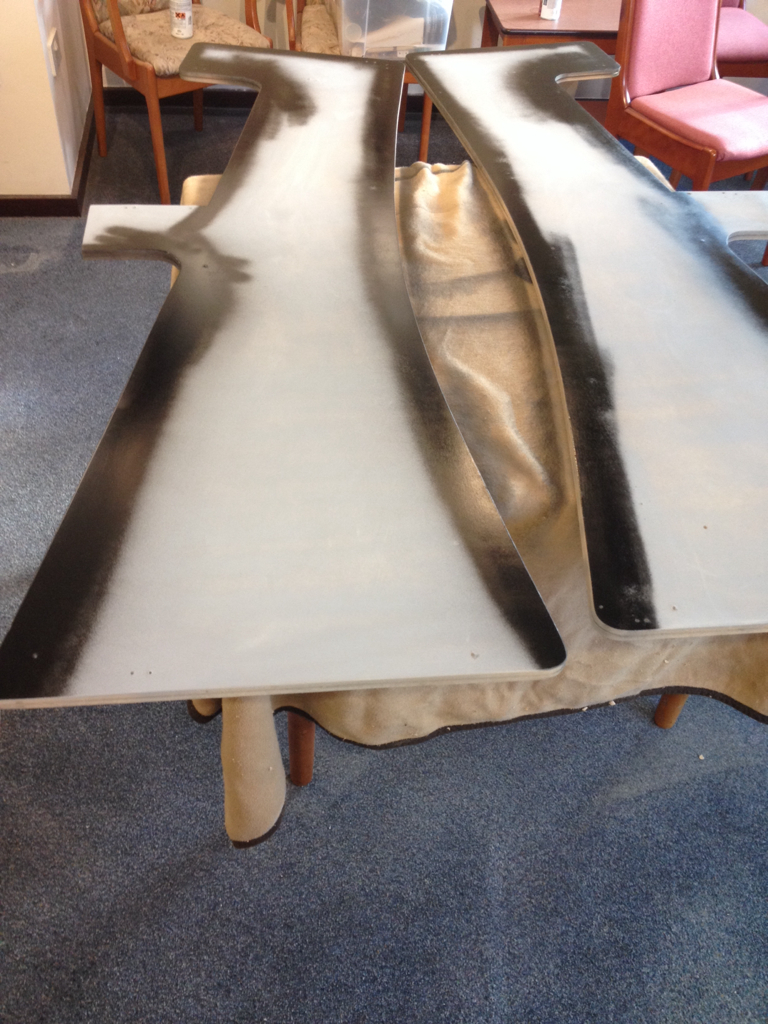

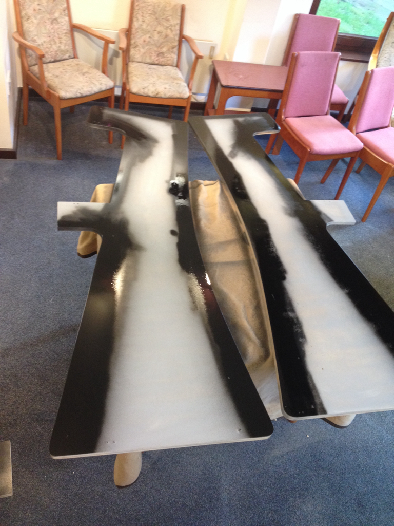

my progress today
I cut the groove in the sides for the T-Molding
As some parts are going to be on show I undercoated them
Then once again
Now with the black
And once again
And that's the inside done

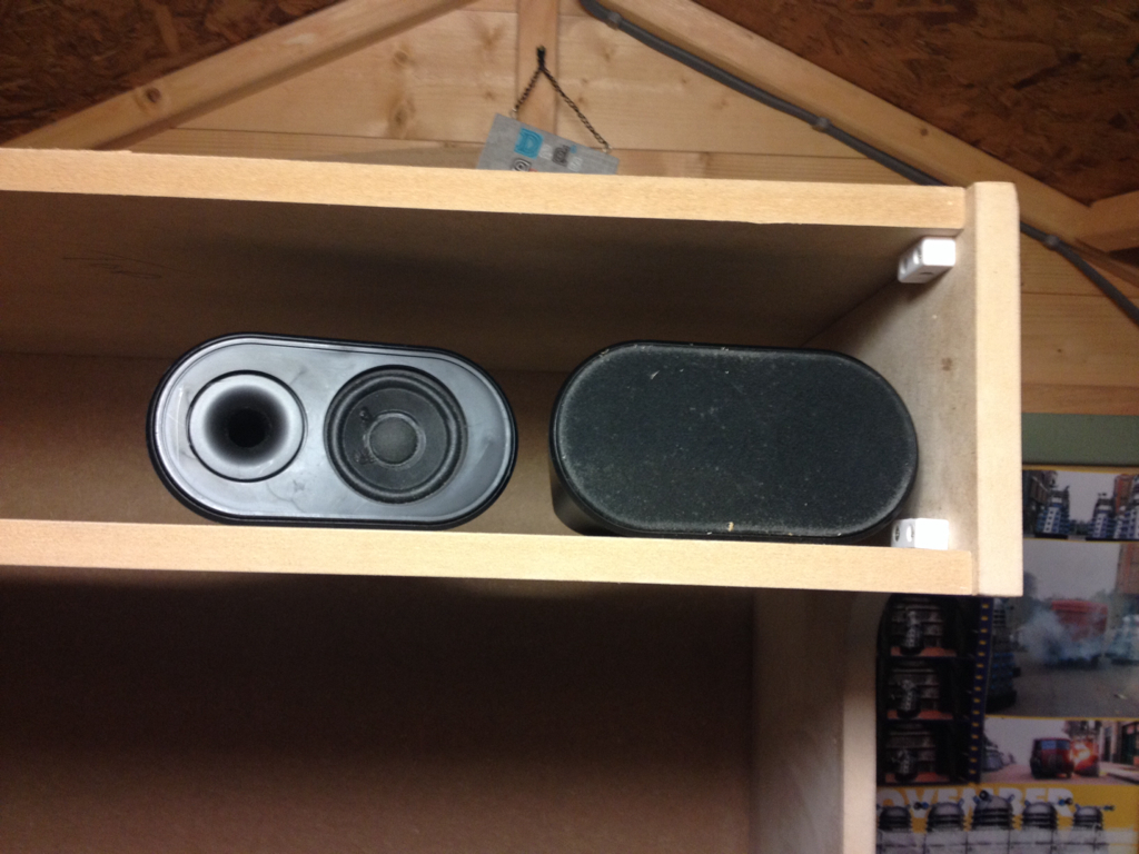

One more coat on the speaker grill
And speakers fitted
Now to fit it back together
