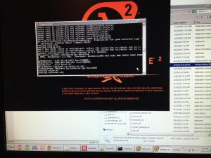

Yardley Posted March 31, 2015 Posted March 31, 2015 Here is my TTX.ini if it's of any use.[Half-Life 2 - Survivor Ver 2.0] Application=F:\Roms\Taito Type X\Half-Life 2 - Survivor\HL2Survivor_RunMe.bat AppWaitExe=hl2.exe PreLaunch=.\Modules\PCLauncher\Game Scripts\Half-Life 2 - Survivor.ahk PreLaunchSleep=3000 FadeTitle=Half-Life 2 DM ahk_class Valve001 ExitMethod=Send Alt+F4 HideCursor=true Hey Dime, does Half-Life work ok for you? Mine brings up a command line window (see pic below) that I have to manually move out of the way and the game is not fullscreen.
klizine Posted March 31, 2015 Posted March 31, 2015 Hey Dime, does Half-Life work ok for you? Mine brings up a command line window (see pic below) that I have to manually move out of the way and the game is not fullscreen. [ATTACH=CONFIG]52544[/ATTACH] use urban gangsta's batch.... its awesome. /Upload Here/urbangangsta101/Taito Type X/Half-Life 2 Survivor Ver 2.0/
Yardley Posted March 31, 2015 Posted March 31, 2015 use urban gangsta's batch.... its awesome. /Upload Here/urbangangsta101/Taito Type X/Half-Life 2 Survivor Ver 2.0/ Thanks, just tried his batch but I get the error "Failed to set video mode - resetting to defaults. Game will now restart with the new video settings". If i click ok it goes into the game but I can only see part of the initial screen because its really big. EDIT: I changed the resolution in the batch file to 1280x768 and now it launches full screen but I can't get past the initial screen with the orange logo. I hear the sound when I insert credits with F1 or F3 but F2 does not start the game and neither does any other key. Any ideas? EDIT 2: Problem fixed by disabling my network adapter. I can now start the game by pressing F2. Thanks to urbangangsta101 for the tip.
