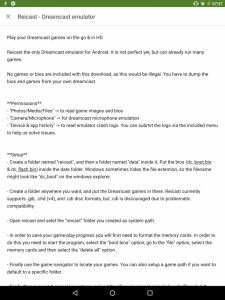

Sting Posted May 8, 2016 Posted May 8, 2016 Have you checked your database??? Here's what Reicast says about (.cdi) files on the playstore.
