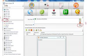

gstratto Posted January 15, 2014 Posted January 15, 2014 Hi hyperpeople! I am trying to setup CPS2 on my cabinet. The problem I have encountered is I cannot select a module through Hyperlaunch HQ for Final Burn Alpha. Usually when I add an emulator in HyperHQ (wheel) it creates the name in the Hyperlaunch HQ list and it comes up with a tiny picture of the system next to the name. With Cps2 I cannot get that picture up which makes me think I have the naming convention wrong for CPS2 in HyperlaunchHQ. Because of this I cannot select a Module and Emulator. Can anyone tell me what I should call CPS2 in Hyperhq? Capcom PS II CPSII etc I have tried manually pointing to the Final Burn Alpha.ahk provided with hyperlaunchHQ (through Git). But it still does not let me pick the Default emulator in HyperlaunchHQ I have added final burn alpha in global emulators aswell in hopes of it letting me pick it in the CPS2 Default emulator tab but it doesnt. Any help would be awesome I have an amiga issue aswell but I will post that later on I have managed to get quite a few systems working so I understand how it all works. Thanks in advance. gstratto

gstratto Posted January 25, 2014 Author Posted January 25, 2014 Ok, for 7 days I have tried to work it out with the information give, but I just cant seem to get it working. I have Capcom Play System as the name for the emulator in hyperlaunchHQ It accepted this and put a little capcom logo next to the name on the left column of systems. But when I try and set up the emulator for this system, it wont let me add a module. I have tried: WinKawaks Mame Final Burn Alpha and Nebula. After i type in the name of the emulator, I browse to the folder that the emulator file is in, i type in zip for the extension, then i have to pick a module.. but there is nothing. I have tried manually typing the path to the module in this field, but then when I have to pick the emulator, that field is blank also. something is not right and i cant figure it out any ideas? this has me stumped.

gstratto Posted January 30, 2014 Author Posted January 30, 2014 I fixed it! I should have seen it before! In the Capcom Play System Emulator in HyperlaunchHQ there is a tab called HyperlaunchHQ in that menu on the left under General Options, there is a tickbox for: [ ] Valid Emulator/Modules only I unticked this and BAM! it works. Emulator now accepts Module and games run fine!! I hope this helps out other people that are stuck with CPS.
