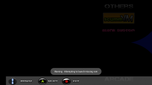

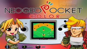

Henderson33 Posted June 14, 2016 Posted June 14, 2016 Hi potts, i cant seem to get the new art working either. I went back to post 80 and downloaded the zip file u put up again and again i got the xbox buttons showing and have them in the correct place. Its just the frame that it has trouble with. I made another vid clip to show u..I went to another system also to show the default special art. It looks great but would look better in shield controls thanks again for all the help
potts43 Posted June 14, 2016 Posted June 14, 2016 What's different with them from post 80? I'll take a look tomorrow
Henderson33 Posted June 14, 2016 Posted June 14, 2016 well the new art dosnt show at all.. the original art works great but the something in the frame art makes hyperspin crash...i think its the time thing like u mentioned originally

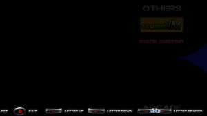

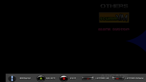

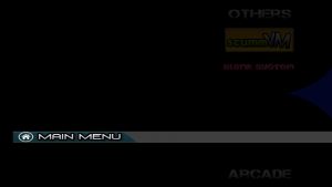

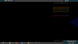

thatman84 Posted June 14, 2016 Posted June 14, 2016 Potts i think i have cracked it BUT there is still a little more work to do!!!!! God knows how long it takes you to create this stuff but im 5hrs down The 1080 border images definately look to big I have done all of my testing of System and Main menu IN the Main Menu Findings .png files dont work (tested with same x & y settings as .swf) From "Customised Specialart" Set (download from post #80) 1. Main Menu SpecialA1.swf (border) from "Customised Specialart" folder post #80 Crashes Hyperspin Android 2. Main Menu SpecialB1,2,3.swf ALL Working (bit small imho) 3. GCE Vectrex System art from same pack SpecialA1.swf Border WORKS FINE (x=512, y=384) SpecialB1.swf xbox buttons WORKS FINE (bit small) (x=260, y=384) Latest Version for Android from post #186 1. Main Menu buttons SpecialB1.swf (x=1000, y=240) Working and look perfect size (job done) 2. Main Menu border MERGED SpecialA1.swf Resolution too high!! x=1000, y=240 x=1000, y=1080 3. System Buttons Showing to wide (guess reduce by 20%) Im happy with the height but i guess aspect ratio will affect the height to. x=650, y=240 4. System MERGED border Again displaying way to big (x=1000, y=240) Conclusion 1. Leave the newest Main Menu buttons as they are, they are perfect for me 2. Reduce the size slightly of the System Menu buttons 3. Use the System menu border from the post #80 download as a template for any other borders (i dont have a way to create swf's so wont be able to use the system borders. For my setup I probably will only use the buttons or maybe a Menu border with just a generic text like "Main Menu" "System Menu" "Choose system" in the corners. No full screen width bars) If you want to get the menu borders working Potts43 I am happy to test them out for you. Hyperspin 2.0 Latest Download Hyperspin 2.0 Documentation -------Pre Hyperspin 2.0 Below---------- HS Android Overview & Install HS Android Base Pack Download My Tutorials

ninja2bceen Posted June 15, 2016 Author Posted June 15, 2016 Ninja here are your animated special swfs Hope they are ok for you! thank you potts! I'm going to be terribly needy, do you see in the game special art for arcade the favorite button number 3 being a little blurry? I think half of the 3 is blurred out so its hard to read. These are amazing other than that. The main menu one is perfect! Advance the cause to 100%. http://hyperbase.hyperspin-fe.com/ Planet Geekdom, Subscribe for Tutorials! https://www.youtube.com/channel/UCdcby-s2GwriaOHGmVC2vGA?sub_confirmation=1&app=desktop
potts43 Posted June 15, 2016 Posted June 15, 2016 thank you potts! I'm going to be terribly needy, do you see in the game special art for arcade the favorite button number 3 being a little blurry? I think half of the 3 is blurred out so its hard to read. These are amazing other than that. The main menu one is perfect! Just checked the artwork for every single stage in production and every button appeared to have the same focus. There doesn't seem to be anything wrong this end[emoji53]
potts43 Posted June 15, 2016 Posted June 15, 2016 Bizarrely when I unpacked the #80 zip they were 1080p....go figure! Can you test these for me/for you? I have chopped out the backgrounds so that you can have in the top left Main Menu and System Menu. I have also reduced the System B1 buttons so hopefully they fit your screen. TEST.zip
ninja2bceen Posted June 15, 2016 Author Posted June 15, 2016 Just checked the artwork for every single stage in production and every button appeared to have the same focus. There doesn't seem to be anything wrong this end[emoji53]whats weird is the black part of the 3 only for 2/3 of it almost become invisible so it's hard to see the actual 3. If you put it in hyperspin do you see what I'm saying? Advance the cause to 100%. http://hyperbase.hyperspin-fe.com/ Planet Geekdom, Subscribe for Tutorials! https://www.youtube.com/channel/UCdcby-s2GwriaOHGmVC2vGA?sub_confirmation=1&app=desktop
Henderson33 Posted June 15, 2016 Posted June 15, 2016 Bizarrely when I unpacked the #80 zip they were 1080p....go figure! Can you test these for me/for you? I have chopped out the backgrounds so that you can have in the top left Main Menu and System Menu. I have also reduced the System B1 buttons so hopefully they fit your screen. Just tried these, they display but i just need to sort the x and y out. Just used the system buttons for the main menu as a test. Again uploaded to youtube to show you. Great stuff https://youtu.be/ArPZroUyr5Q
potts43 Posted June 15, 2016 Posted June 15, 2016 Looks good. Once you get rid of the Xbox stuff and set your x y you're sorted for shield control only. I know these were kinda basic but needed to get stuff working for now.
thatman84 Posted June 15, 2016 Posted June 15, 2016 So I have got these all working!!! Great stuff Potts43 https://www.youtube.com/watch?v=qySWphKa6IQ&feature=youtu.be Mingmong how do you embed videos?? Now its time for the Ninja in me (no offense N2BCeen!) If you want to try some more stuff Potts43 ill use it, animating the browse or splitting the system buttons into B1 and B2 !! These are my Special Art settings lines used (I could not get them to fade in or out not sure why) Main Menu [special Art A]default=falseactive=truex = 180y = 26in = 5out = 5length = 3delay = 3type = fadestart = bottom[special Art B]default=falseactive=truex = 950y = 242in = .4out = .4length = 3delay = .1type = fadestart = none System Menu [special Art A]default=falseactive=truex = 180y = 26in = 5out = 5length = 3delay = 3type = fadestart = bottom[special Art B]default=falseactive=truex = 350y = 742in = .4out = .4length = 3delay = .1type = fadestart = none Hyperspin 2.0 Latest Download Hyperspin 2.0 Documentation -------Pre Hyperspin 2.0 Below---------- HS Android Overview & Install HS Android Base Pack Download My Tutorials
