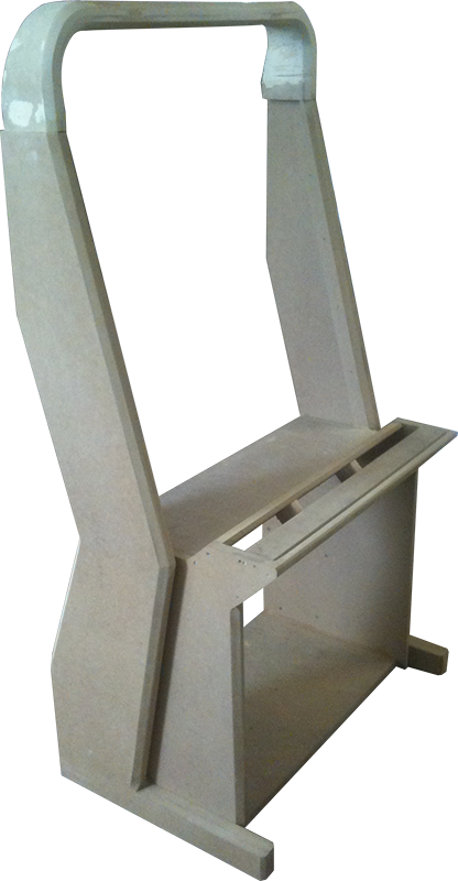

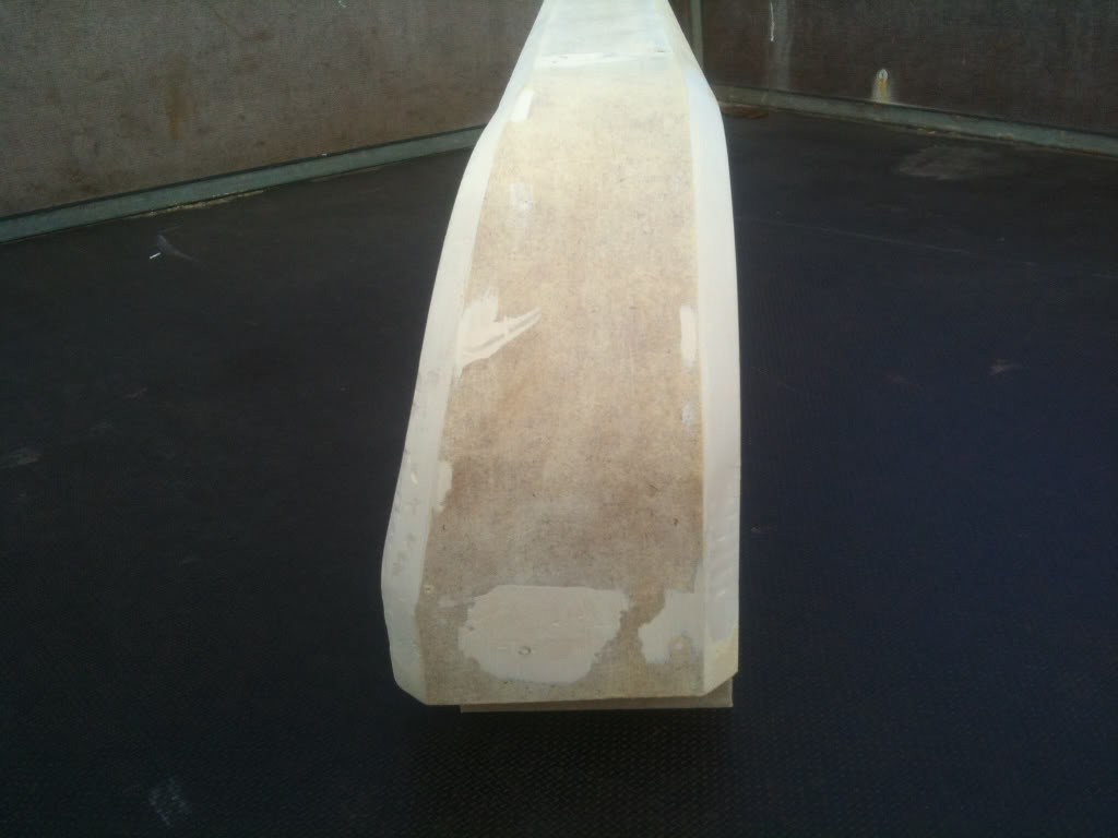

manicshere Posted March 12, 2014 Author Posted March 12, 2014 Exactly... the arch. Don't think I cut it deep enough and then I used too much force to bend it.
emixama Posted March 12, 2014 Posted March 12, 2014 she must bend under its own weight but also careful not to bend in the wrong direction.

manicshere Posted March 13, 2014 Author Posted March 13, 2014 Well actually you have there are two options along with the plans. One is more authentic, but harder to do, at least without prober tools and involves bending the wood and the other probably takes longer to build as it consists of more pieces glued together, but the build itself is a lot simpler. I personally choose the first solution purely for aesthetic reasons, but I am still struggling with it to anyone who's a novice when it comes to woodworking. In the end it's just wood though. I can still manage to screw up a bunch of times before i run out and have to buy an entire new sheet.

emixama Posted March 13, 2014 Posted March 13, 2014 I'm the first who use this technic in the worls of vewlix replica, if you want i sell real size print of each part in world. @manicshere : you must let less that 1mm to not break the wood. I tried to send you picture tomorrow. Maxime

manicshere Posted March 18, 2014 Author Posted March 18, 2014 I'm mending the damage I made to the arch Took me several attempts, but I'm finally satisfied with how it's turning out. Not posting any pictures yet though. Need to clean up my wood filler work first

manicshere Posted March 19, 2014 Author Posted March 19, 2014 Spent an hour or so sanding today. More or less to see how the woodfiller had worked. It's not perfect, but it will be. Don't think I'll be touching the arch part again until I have the plexiglass to make sure that I'll be sanding of the correct amount. The real update should be dropping after the upcoming weekend as I should have some free time on my hands.

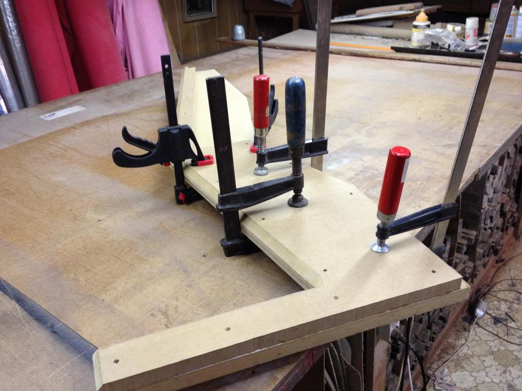

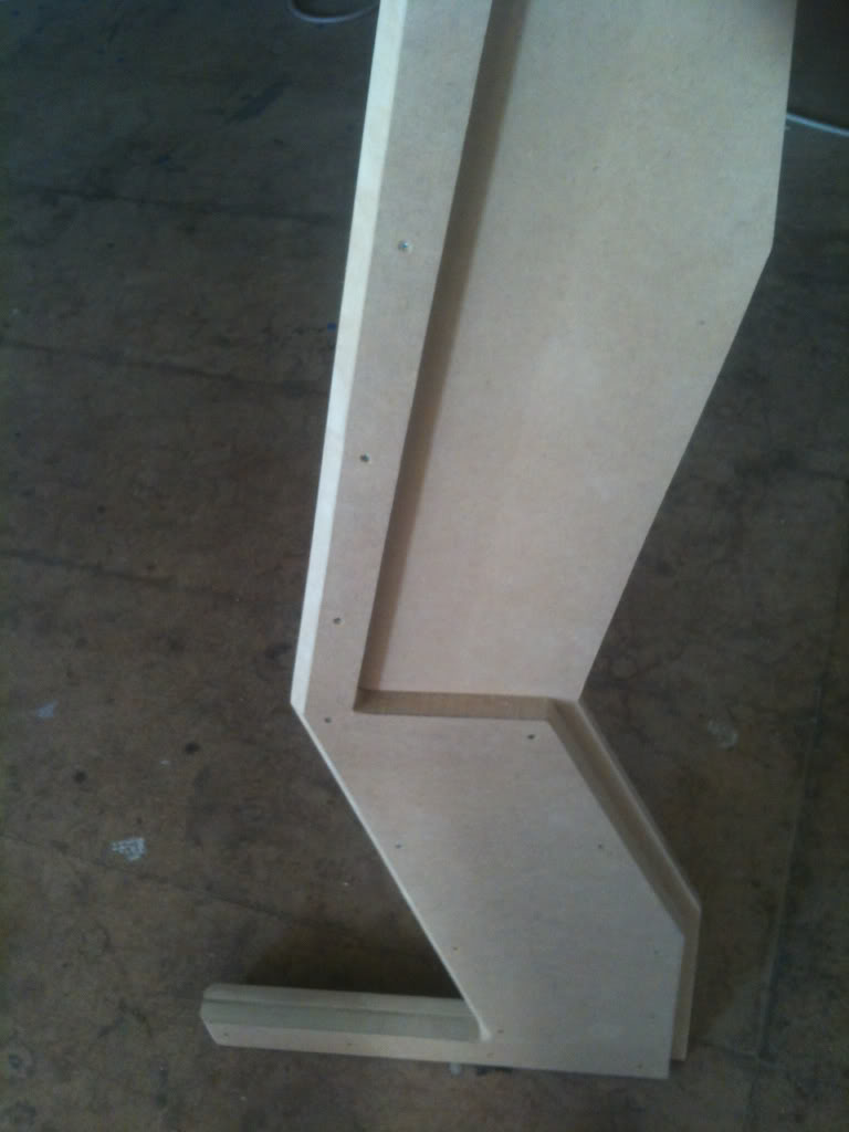

manicshere Posted March 22, 2014 Author Posted March 22, 2014 Didn't think I was able to get a lot done today, but I'm very satisfied with the amount of work I managed to get done First some pictures of one of the sides screwed and glued together. I've started assembling the base of the arcade. There are some minor kinks that needs ironing out, but it's coming together nicely. Might get more done tomorrow. Not sure. Thanks for checking out my progress. Have a great weekend

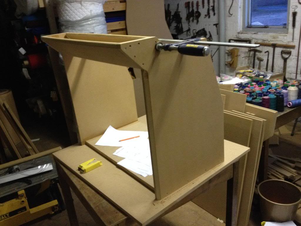

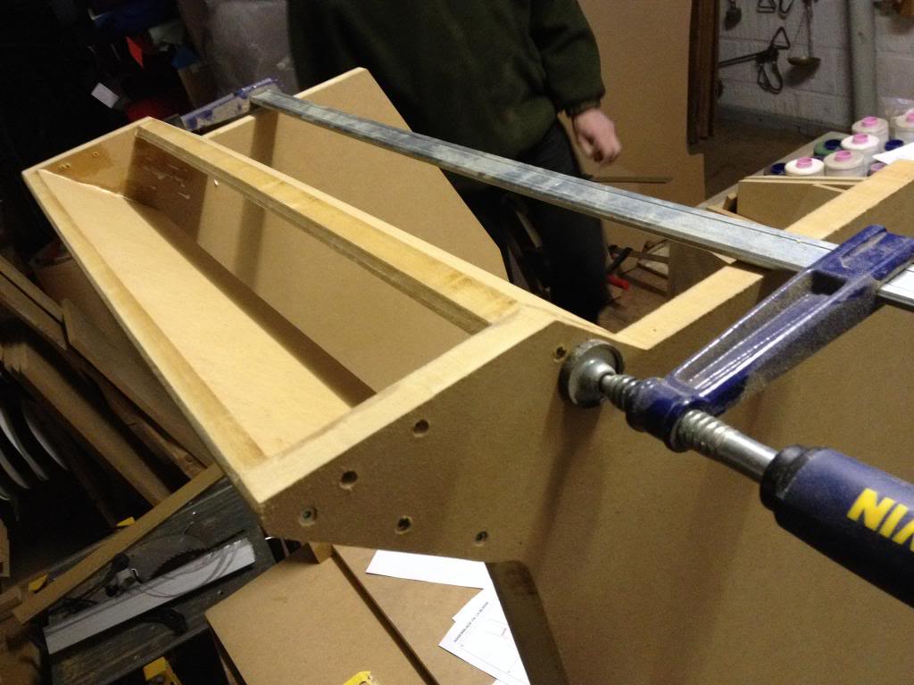

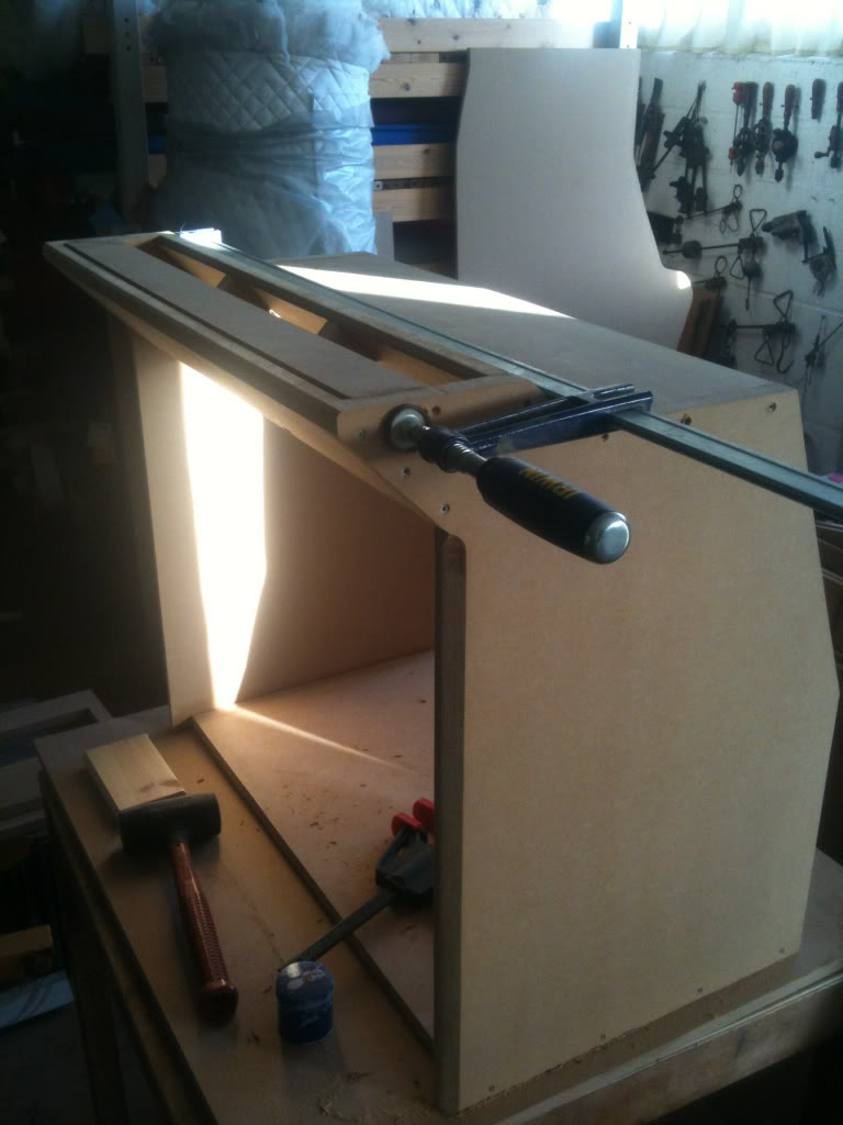

manicshere Posted March 24, 2014 Author Posted March 24, 2014 Thanks to everybody taking interest in my project. Learning a lot through this build. Even making new friends Slowly running out of things to do until I have the plexiglass ready. Managed to finish the base (asside from the door) as well as the other side piece.
ericleroi Posted March 24, 2014 Posted March 24, 2014 Those legs look like they have a recess for a back panel. Excellent!

manicshere Posted May 9, 2014 Author Posted May 9, 2014 Picture af the current state of the cab. Sides have now been added. It's been like this for a while. I'm expecting parts in the start of next week, but don't have much time to dedicate it all on building my cab. Have a great weekend!
