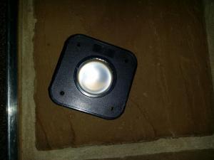

gigapig Posted September 20, 2016 Author Posted September 20, 2016 Has anyone got any tips on mounting my cheap ass (sorry bad turn of phrase) track ball? What I planned to do was remove enough material from the underside for it to slot in and enough Balls to be exposed on the CP side. I worried if I take out enough and leave about 3mm of MDF behind, but will it be strong enough? The other option is some plexi on the CP, I'll have to test that out.
danwelsh Posted September 20, 2016 Posted September 20, 2016 On 9/20/2016 at 1:48 PM, gigapig said: Has anyone got any tips on mounting my cheap ass (sorry bad turn of phrase) track ball? What I planned to do was remove enough material from the underside for it to slot in and enough Balls to be exposed on the CP side. I worried if I take out enough and leave about 3mm of MDF behind, but will it be strong enough? The other option is some plexi on the CP, I'll have to test that out. 2016-09-20 14.41.33.jpg That's how I mounted mine on mdf and used plexi overtop, it's nice and strong I'm lovin my arcade
Snakerake Posted September 20, 2016 Posted September 20, 2016 On 9/20/2016 at 1:48 PM, gigapig said: Has anyone got any tips on mounting my cheap ass (sorry bad turn of phrase) track ball? What I planned to do was remove enough material from the underside for it to slot in and enough Balls to be exposed on the CP side. I worried if I take out enough and leave about 3mm of MDF behind, but will it be strong enough? The other option is some plexi on the CP, I'll have to test that out. 2016-09-20 14.41.33.jpg MDF will probably break eventually at that thickness(thinness?). But if you supported the trackball assembly from the bottom with a support piece, and attached that support to the top MDF (where its not recessed) it would circumvent the stress on the thin portion of the MDF.
gigapig Posted September 20, 2016 Author Posted September 20, 2016 On 9/20/2016 at 2:48 PM, Snakerake said: MDF will probably break eventually at that thickness(thinness?). But if you supported the trackball assembly from the bottom with a support piece, and attached that support to the top MDF (where its not recessed) it would circumvent the stress on the thin portion of the MDF. That is a good idea which hadn't crossed my mind.
gigapig Posted September 20, 2016 Author Posted September 20, 2016 On 9/20/2016 at 1:51 PM, danwelsh said: That's how I mounted mine on mdf and used plexi overtop, it's nice and strong Thank you Dan for the reassurance. I need to get this sorted first and if I screw up then all I need is another piece of wood. I need to remember to test it on a piece of scrap.
ci2own Posted September 20, 2016 Posted September 20, 2016 On 9/20/2016 at 1:48 PM, gigapig said: Has anyone got any tips on mounting my cheap ass (sorry bad turn of phrase) track ball? What I planned to do was remove enough material from the underside for it to slot in and enough Balls to be exposed on the CP side. I worried if I take out enough and leave about 3mm of MDF behind, but will it be strong enough? The other option is some plexi on the CP, I'll have to test that out. 2016-09-20 14.41.33.jpg I have mine only with a 3mm methacrylate without any problem.
gigapig Posted September 20, 2016 Author Posted September 20, 2016 On 9/20/2016 at 4:21 PM, ci2own said: I have mine only with a 3mm methacrylate without any problem. Methacrylate? Wow sounds addictive and illegal.
ci2own Posted September 20, 2016 Posted September 20, 2016 On 9/20/2016 at 7:15 PM, gigapig said: Methacrylate? Wow sounds addictive and illegal. Specially illegal
gigapig Posted September 20, 2016 Author Posted September 20, 2016 On 9/20/2016 at 7:18 PM, ci2own said: Specially illegal You know what, your post may have changed the control panels. I looked up methaddict whatever, commonly know as perspex in the UK. Then came across a site that has some great colours at good prices for cutting and rounding edges. I could get away with 5mm and not use any mdf and it saves painting it. Thank you. http://www.perspexsheet.uk/colour-perspex/
ci2own Posted September 20, 2016 Posted September 20, 2016 On 9/20/2016 at 7:46 PM, gigapig said: You know what, your post may have changed the control panels. I looked up methaddict whatever, commonly know as perspex in the UK. Then came across a site that has some great colours at good prices for cutting and rounding edges. I could get away with 5mm and not use any mdf and it saves painting it. Thank you. http://www.perspexsheet.uk/colour-perspex/ As i can see is similar (if not the same) as methacrylate. You could do the same as i did (Only if you want ): I designed a stick and printed to add at the back of my methacrylate. You can see it in the pic: https://www.dropbox.com/s/zlhbpu127w92ux9/Captura%20de%20pantalla%202016-09-20%2021.57.44.png?dl=0 What do you think about?
haimbilia Posted September 22, 2016 Posted September 22, 2016 On 9/20/2016 at 1:48 PM, gigapig said: Has anyone got any tips on mounting my cheap ass (sorry bad turn of phrase) track ball? What I planned to do was remove enough material from the underside for it to slot in and enough Balls to be exposed on the CP side. I worried if I take out enough and leave about 3mm of MDF behind, but will it be strong enough? The other option is some plexi on the CP, I'll have to test that out. 2016-09-20 14.41.33.jpg i bought the same trackball, what i plan to do is remove the lid of the trackball so i have more clearance, then cut 2 grooves in the wood for the encoder wheels, because they are high enough to touch the wood. also im using this as a trim: http://www.ebay.com/itm/351409621576?_trksid=p2060353.m2749.l2649&ssPageName=STRK%3AMEBIDX%3AIT
gigapig Posted September 22, 2016 Author Posted September 22, 2016 On 9/22/2016 at 12:30 PM, haimbilia said: i bought the same trackball, what i plan to do is remove the lid of the trackball so i have more clearance, then cut 2 grooves in the wood for the encoder wheels, because they are high enough to touch the wood. also im using this as a trim: http://www.ebay.com/itm/351409621576?_trksid=p2060353.m2749.l2649&ssPageName=STRK%3AMEBIDX%3AIT Thanks. I had the same thought about taking the lid off but noticed the wheels, so I then thought about adding spacers to the bolt holes. Now that I have decided on using perspex which I order yesterday, that won't matter. I have now received the glass top which looks lovely and also had the MSI GTX 660ti delivered that I won on Ebay. It may be overkill I know.

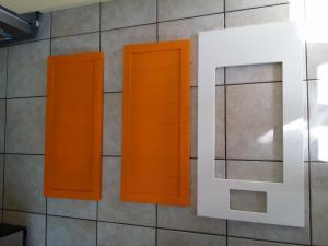

gigapig Posted October 3, 2016 Author Posted October 3, 2016 On 10/3/2016 at 8:33 AM, diskmach said: Nice. So, are you going to upgrade your "Beer Me" sign to "Cocktail Me" soon then? Yeah good idea then I can charge more and have a Happy Hour. Did some more panel spraying over the weekend, that has been the most time consuming thing so far. I do like the Donkey kong Jr orange though.

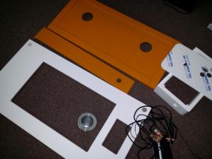

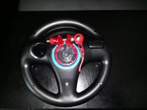

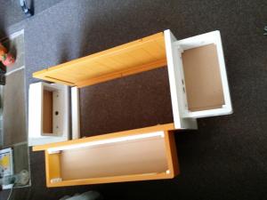

gigapig Posted October 3, 2016 Author Posted October 3, 2016 Here are the side panels and the lid which have been part painted. And here is my home made spinner steering wheel attachment. Just uploading a video on that with more details.

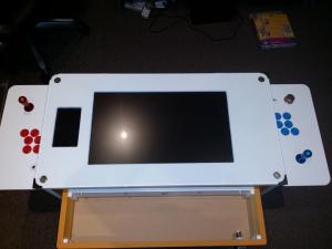

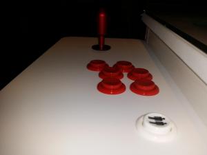

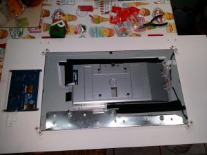

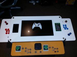

gigapig Posted October 11, 2016 Author Posted October 11, 2016 Here's some finished panels ready for the fun bit of putting it all together. Here I have mounted the screens, the smaller one I used the brass stand-offs which came with the kit.

gigapig Posted October 19, 2016 Author Posted October 19, 2016 Just uploaded a video which shows the finished cabinet. If anyone has any suggestion regarding securing the control panels then I would love to hear it. There's no real reason once the controls are wired to access it and because of the way it is hinges are out. I did think of some small rare earth magnets but they may interfere with the Ultrastiks. I may glue a block of wood to the underside of the perspex (acrylic) with a threaded bolt running through it and then secure it through the bottom of the CP.
