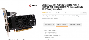

gec5741 Posted September 30, 2016 Posted September 30, 2016 Currently I have a low profile HP PC running my build. The specs are I5-2500 @3.30ghz, 16gb ram and a Geforce GT610 1gig GPU. I'm running MAME, retroarch (NES, SNES, NES64, GENESIS) and Daphne emulators. Currently my PC will slow down when playing MetalSlug through Mame. I'm also trying to include some Taito Type X arcade games that you can find online. I have Street Fighter 2 "working" but it only plays at low res on a 20inch monitor. Of course I'd like to also get a larger monitor for this build and play it at full res. So all that being said I'm limited in video card choices with the low profile case. I'm wondering if the attached card would be sufficient with my build to play what I currently have running? Also what kind of head room with emulators would I have? If this would be enough I'll pull the trigger on one by Christmas but if not then I may be looking at trying to port out my parts into a full size case of some sorts. I don't have a cabinet build or I would look at just ditching the case all together. Thanks in advance for any advice you may have!
mikekim Posted October 1, 2016 Posted October 1, 2016 the 610 is a bit under powered, you should look at getting a '50ti or greater (lowest now is 750ti - a 650ti would do if you can find one)
woosdom Posted October 1, 2016 Posted October 1, 2016 I have a low profile 740 and it works great for all my emus and even arma 3. bought it since it was cheaper then the 750. but if u can, then go for the 50 or higher with a low profile. did you buy a modder system from one of the guys at BYOAC?
Tcrusenberry Posted October 3, 2016 Posted October 3, 2016 I have the same chip and just upgraded to the 1060 3gb from gygabyte ($200), much improved performance. I had a 550 before in my setup

gec5741 Posted October 4, 2016 Author Posted October 4, 2016 That MSI gtx 750 ti is only 130 bucks on newegg. I think I'll pick one up here within the next few months hopefully. From what I can find it seems that the 750 ti is the best I can get in a Low Profile style. @Aorin, Thanks I will definitely take a look at what you posted! It would be great to take care of the metal slug issues because it would be fun to play those now! I've only noticed it in the metal slug games and they start out fine. But after you play for a few minutes and there is a lot going on within the screen it just "slows down" a bit. Like it's struggleing. It's still playable but also noticeable. Also if I try and play the taito typeX street fighter II on higher resolution settings it would also go from playing fine to Slowing down to a crawl. EDIT: will that patch work for a rom? From what it looks like it is for the actual cart.

Aorin Posted October 4, 2016 Posted October 4, 2016 On 10/4/2016 at 6:54 PM, gec5741 said: That MSI gtx 750 ti is only 130 bucks on newegg. I think I'll pick one up here within the next few months hopefully. From what I can find it seems that the 750 ti is the best I can get in a Low Profile style. @Aorin, Thanks I will definitely take a look at what you posted! It would be great to take care of the metal slug issues because it would be fun to play those now! I've only noticed it in the metal slug games and they start out fine. But after you play for a few minutes and there is a lot going on within the screen it just "slows down" a bit. Like it's struggleing. It's still playable but also noticeable. Also if I try and play the taito typeX street fighter II on higher resolution settings it would also go from playing fine to Slowing down to a crawl. Oh yea, the slow down you mention in Metal Slug when there's lots going on is the game itself, it doesn't have to do with your CPU or GPU, the link I provided earlier has more info about it, and there's patched Metal Slug roms to avoid this slow down, now the Taito Type X slow downs in High Resolutions, this one actually has to do with the GPU, if you upgrade the GPU it should run fine. Aorin
