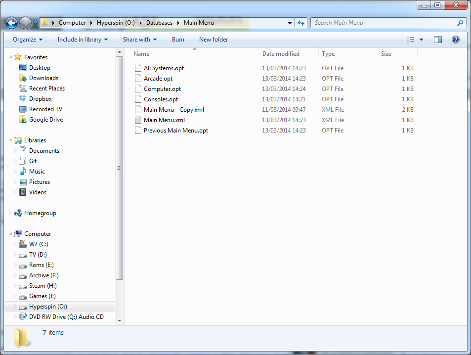

Faahrev Posted March 12, 2014 Posted March 12, 2014 Hi all, Introducing Launcher. It's a little program that allows you to run and choose from a (custom) set of systems before running Hyperspin. All it takes is this program (unzip to a location of your own choice) and your own custom set of 'Main Menu.xml's' Suppose you'd like to run Hyperspin with only the Arcade systems. Or systems that are hand-held. Copy your Main Menu.xml to whatever name (but with the extension .opt) in \Hyperspin\Databases\Main Menu, edit this file to your liking and you're done. Repeat for other uses (no duplicate names of course..) I'm sure you can think of some other examples that you can use (Brand, Era, Generation etc.) First off, MAKE A BACKUP OF YOUR "MAIN MENU.XML". It WILL be overwritten. Then copy the "Main Menu.xml" to any name you wish (eg. Arcade.opt) and edit it the way you like containing only the systems you would like to run when starting HS. Repeat for every list you want to make. Example Main Menu folder: Main Menu.xml All Systems.opt Arcades.opt Consoles.opt Nintendo.opt Sega.opt First Generation Consoles.opt Second Generation Consoles.opt Again, I'm sure you can come up with some lists of your own. An option for selecting the previous .opt will be created automatically and added to the list if the folder used (Main Menu) is writable. Run the program. Follow the instructions. The first time (only) it will ask for the location of the HS folder. It will present a simple dialog containing a list of the system choices you created. Use the cursor keys for up and down. Exit by closing the window or ESC. Select by double clicking or ENTER or use one of the buttons. OK & Exit will only change the Main Menu.xml OK & Run (Default) will change the Main Menu.xml and execute Hyperspin. Double clicking a title works as the first option; OK & Exit. ENTER works as the second; OK & Run Tip: Since other applications (HLHQ, Hypersearch etc.) use the Main Menu.xml be sure to run Launcher and select the appropriate list BEFORE you run any of those. Tip2: If you have less experience performing file-actions in Windows (or XML type files), the safest way to create an .opt file is to open the existing "Main Menu.xml" with Notepad++ (Google it, it's free) by right clicking on the file, select "Edit with Notepad++", making your changes and selecting 'save as' from the menu. Since XML is a windows registered extension, copying and renaming can cause the file having the wrong extension (eg. Consoles.opt.xml). If the extension is registered, the latter .xml in the name is invisible. Plus you can use Notepad++ to edit an existing .opt file by right clicking it and select "Edit with Notepad++" REMEMBER TO MAKE A BACKUP OF THE EXISTING Main Menu.xml ANYWAY!! Enjoy. Launcher.zip Keep on Spinnin' !

zero dreams Posted March 13, 2014 Posted March 13, 2014 Very useful for me right now. I've got over 200 systems on my main menu and quite a few have missing themes, wheels, videoes, etc and this is a good way for me to narrow it all down to the largest working setup I can have while maintaining a list of missing items. I don't know of any checkers that validate the main menu media so, much appreciated. I initially just copied my Main Menu.xml and added the .opt extension when I renamed it but that didn't work. Doing it the right way and opening the xml in Notepad++ and saving it with the opt extension allowed it to populate when I started the launcher. Just thought I'd throw that in there for anyone who's as dumb as me. HyperLaunch | HyperWiki | HyperSearch | Intro | Evolution | FadeProject | Checker | Steam Wheel

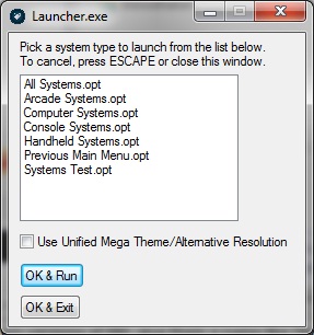

gigapig Posted March 13, 2014 Posted March 13, 2014 Just given this a test drive, looks pretty simple, but so am I. I Copied the Main Menu xml multiple times and edited each one with the systems I wanted. Ran the Launcher and chose the path to HS, then the list appears. Selected an option but noting happens after that, I assume HS should start? Thanks
Faahrev Posted March 13, 2014 Author Posted March 13, 2014 Selected an option but noting happens after that, I assume HS should start? Yes it should. Provided you clicked on OK & Run or ENTER after making a selection in the list. If not, could you provide me with the name and location of you Hyperspin executable? The program error checks if Hyperspin.exe is present in the folder written in the Launcher.ini file so I'm interested to see your answer. Also, after making a selection other than the last time it takes a little longer for HS to start. Keep on Spinnin' !

Agrajag Posted March 15, 2014 Posted March 15, 2014 PM sent about my idea, thanks. Also, this utility works nicely as it is but I hope you will at some point be able to give it a full screen interface that looks a bit like HyperSpin, so cab users don't have to see a Windows dialogue box when starting up. HyperSpin behaving oddly? Read about known bugs here: http://www.hyperspin-fe.com/topic/4590-known-bugs-and-handy-hints-for-hyperspin/ The installer for HyperSpin now includes HyperLaunch 2. Go here for support: http://www.hyperspin-fe.com/forum/122-hyperlaunch-2/ HyperLaunch3 is now called RocketLauncher. Go here for support: http://www.rlauncher.com/forum/content.php Read this for ftp login info: http://www.hyperspin-fe.com/topic/2320-ftp-access-must-read/ Platinum members get 25% off an Emumovies subscription: http://www.hyperspin-fe.com/topic/1211-emumovies-code/
Faahrev Posted March 15, 2014 Author Posted March 15, 2014 I used AHK to create the working script and converted it into an executable. It's the lack of the ability that prevents me from making some nice GUI around it. If somebody has any idea how to I would be grateful. I'll have a look at your PM tonight. Shouldn't be impossible. But with the 'windows' type dialog box I'm afraid... Keep on Spinnin' !

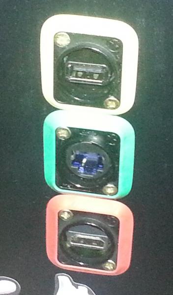

Agrajag Posted March 16, 2014 Posted March 16, 2014 Thanks very much indeed Faahrev, that's exactly what I wanted and you've done it in a more elegant way than I thought of! As for those Neutrik connectors, I've already seen them a while ago and thought about having them on my cab, but thanks for the reminder. HyperSpin behaving oddly? Read about known bugs here: http://www.hyperspin-fe.com/topic/4590-known-bugs-and-handy-hints-for-hyperspin/ The installer for HyperSpin now includes HyperLaunch 2. Go here for support: http://www.hyperspin-fe.com/forum/122-hyperlaunch-2/ HyperLaunch3 is now called RocketLauncher. Go here for support: http://www.rlauncher.com/forum/content.php Read this for ftp login info: http://www.hyperspin-fe.com/topic/2320-ftp-access-must-read/ Platinum members get 25% off an Emumovies subscription: http://www.hyperspin-fe.com/topic/1211-emumovies-code/
